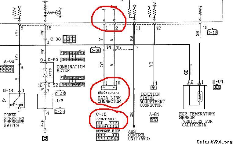

The communications connection to the ECU is rather simple, just pins 1 and 2 on the ECU harness. The problem is that the communications lines also connect to other things in the car, which could be causing the problem. If in doubt, just run 2 new wires and a new ground to the ALDL connector, with nothing else tied to them. You could just move the connector right to the ECU and tap it in too.

Jeff when you say Pins 1 & 2, are you referring to the connectors at the ECU or the diagnostic port? I presume from the way you worded it you mean the ECU harness in which case how can I tell which pins at the diagnostic port connector need to go to Pin 1, Pin 2 and Ground?
Pin #12 of the ALDL connector is supposed to be GROUND. You short pin #10 to pin #12 to put the ECU in diagnostic mode. That is pin #2 of the ECU, as you can see below. The data rides on pin #1 of the ALDL, which is connected to pin #1 of the ECU.
