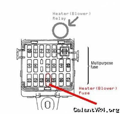

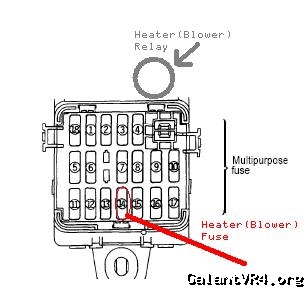

I am going to try the relay. When it doesnt work, it just doesnt all together, even on high. Does anyone have a pic of the fuse box cover so I can see what relay/fuse is what?

I just replaced my blower relay yesterday.
It's a metal cylinder looking relay directly above the interior fuse block.
The fuse for this relay is a 30A fuse (the only 30A one I believe) located on the bottom-most row of the block.
