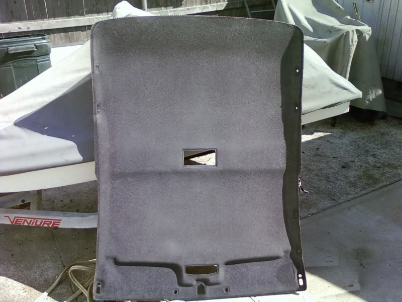

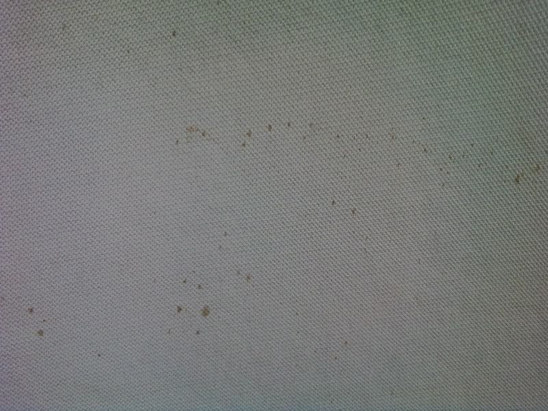

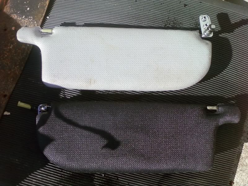

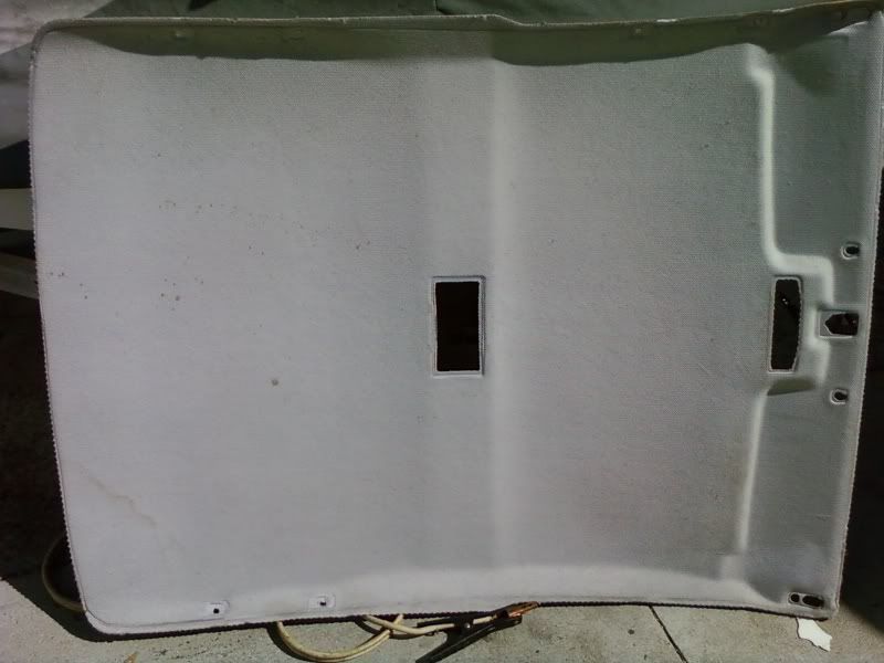

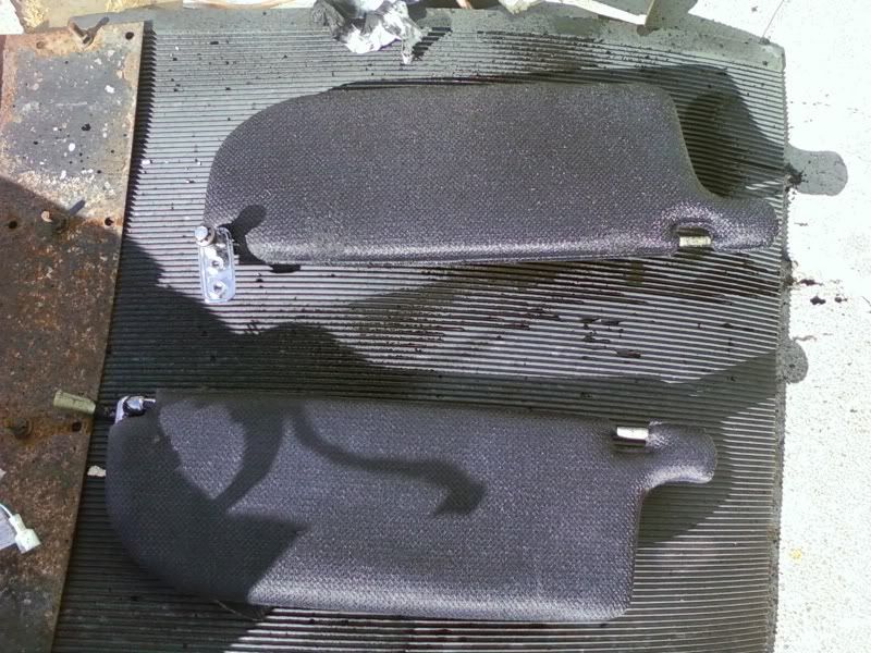

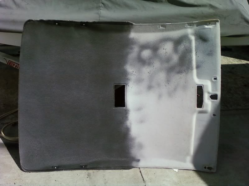

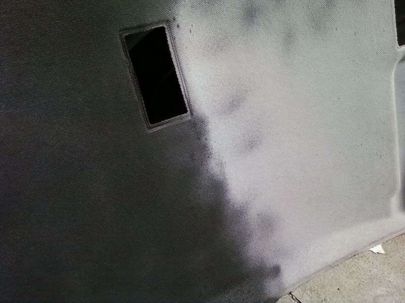

so i was planning on redoing my headliner soon, mainly because of the stains on it, plus adding some foam number inserts under the headliner(#1755/2000) i think it would look awesome to have the # on the roof... but for now i just overhauled it real quick. it came out like a charcoal color not pure black, but it matches great with the interior, way better than stock.
all that is needed:
Spray bottle
2 bottles of black RIT dye
i did a 50/50 mix with water, and so far only 1 coat of the dye.(i ran out, only bought 1 bottle)
i did the headliner and visors. so far they look great. there drying in the sun now.

Came out pretty good, dude. How do you apply the dye? Mix with water in a spray bottle or something?
I don't think I'd try the dye on the floor (concerns about wearing off), but on the headliner, that's not such a bad idea.

so i ended up just recovering the headliner with suede. it was cheap and easy.
with the dye if you scratched the fabric it would leave a grey chalky line. it just plain didn't work. don't try it!
maybe removing the factory headliner and putting in the washer machine to dye it, like your suppose to would yield better results.

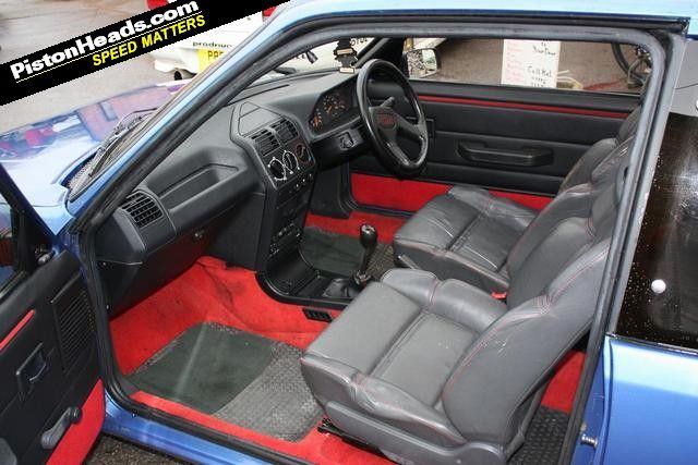

haha it was only an idea. It looks good in other cars which have dark coloured dashboard and seats, for instance a Peugeot 205 GTi springs to mind and it doesn't look so bad at all - it adds a sporty flair to the interior which the VR-4 severely lacks and is always criticised for.
Doesn't look so bad does it?
