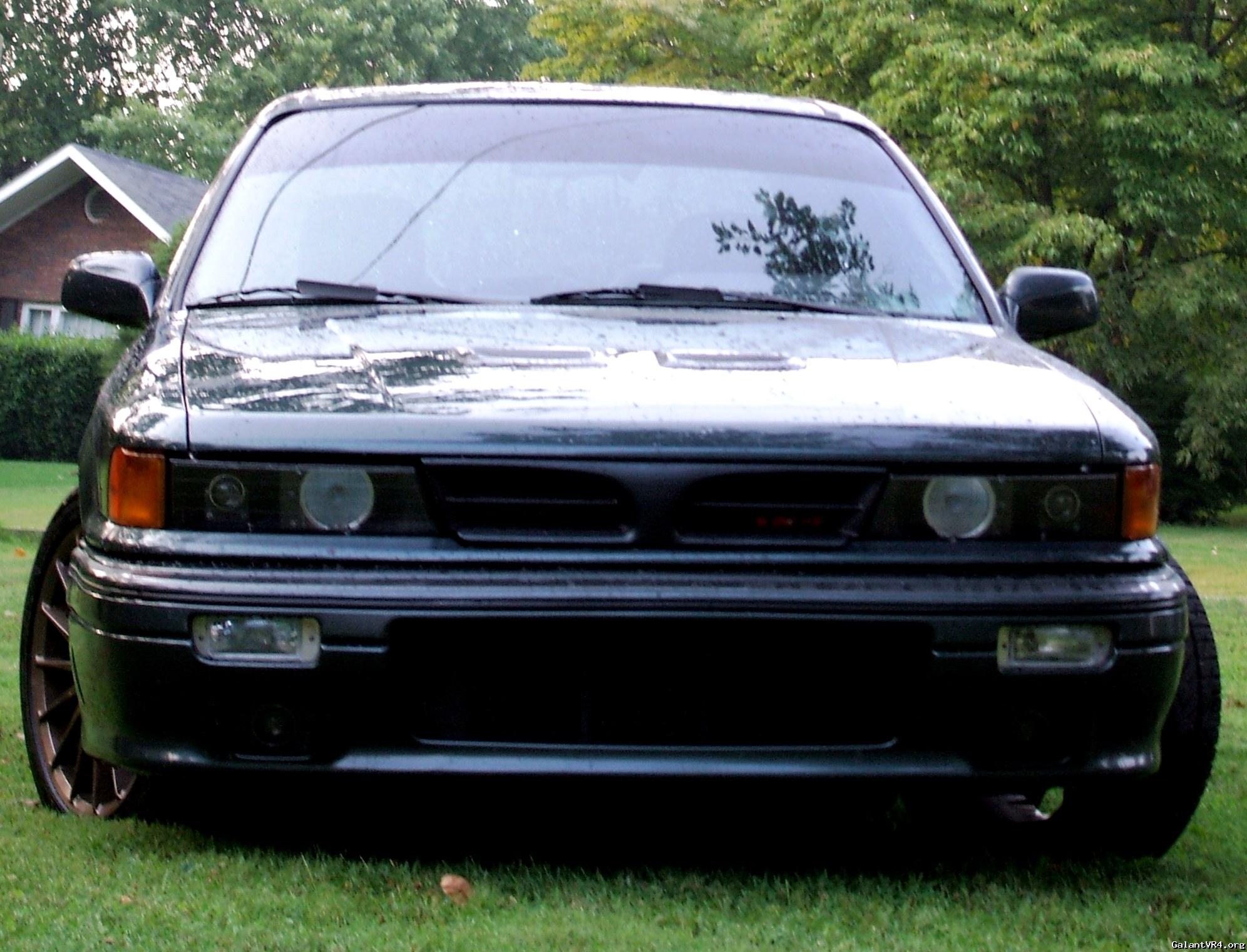

I just think it would look much better if I had the clear lenses on my headlamps because I have the JDM ones with the little city light in it.

Sure thing man. 464/1000 is running JDMs (H1 high beam w/ city light).

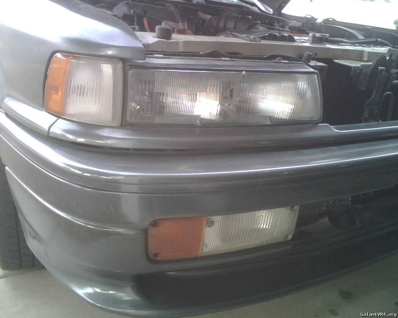

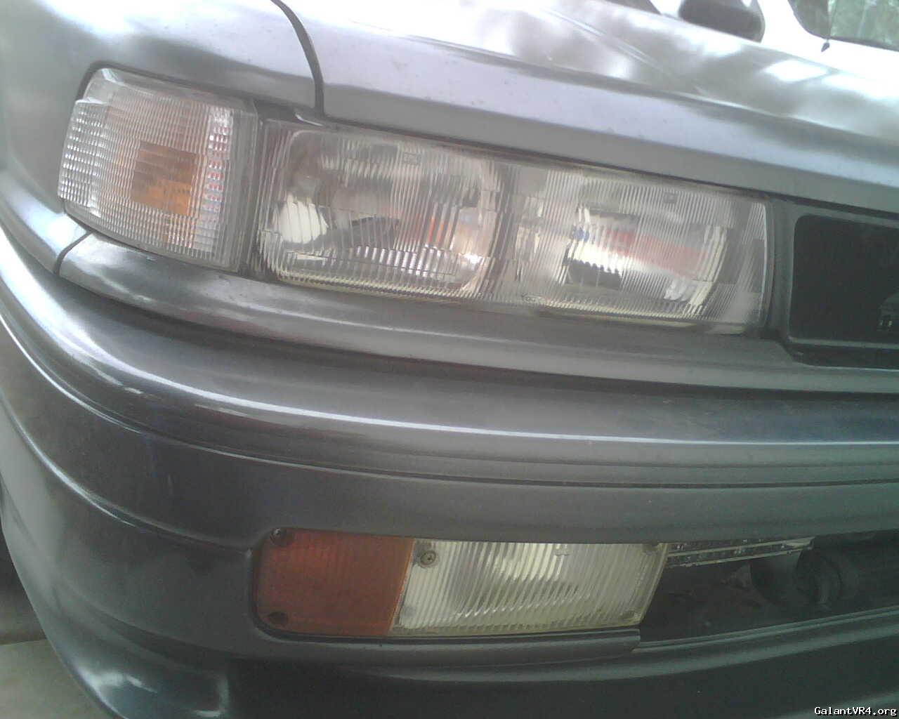

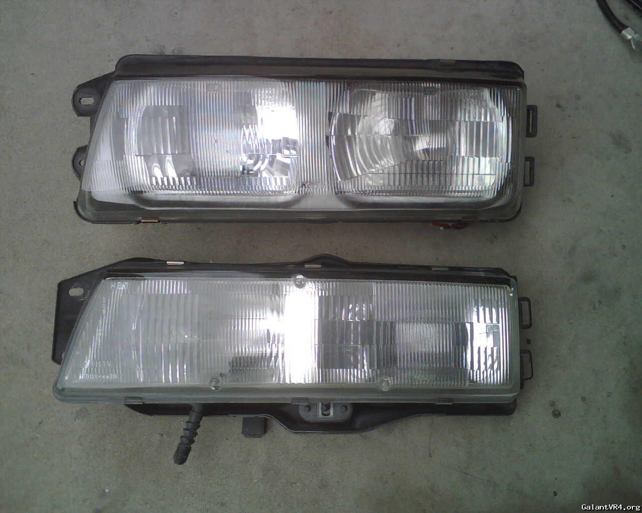

Comparison of USDM to JDM (notice JDM unit is taller, but mounting points in same place)
USDM headlight installed.
JDM headlight installed.

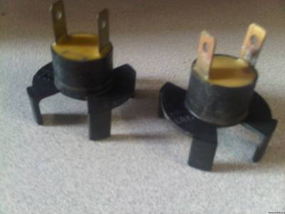

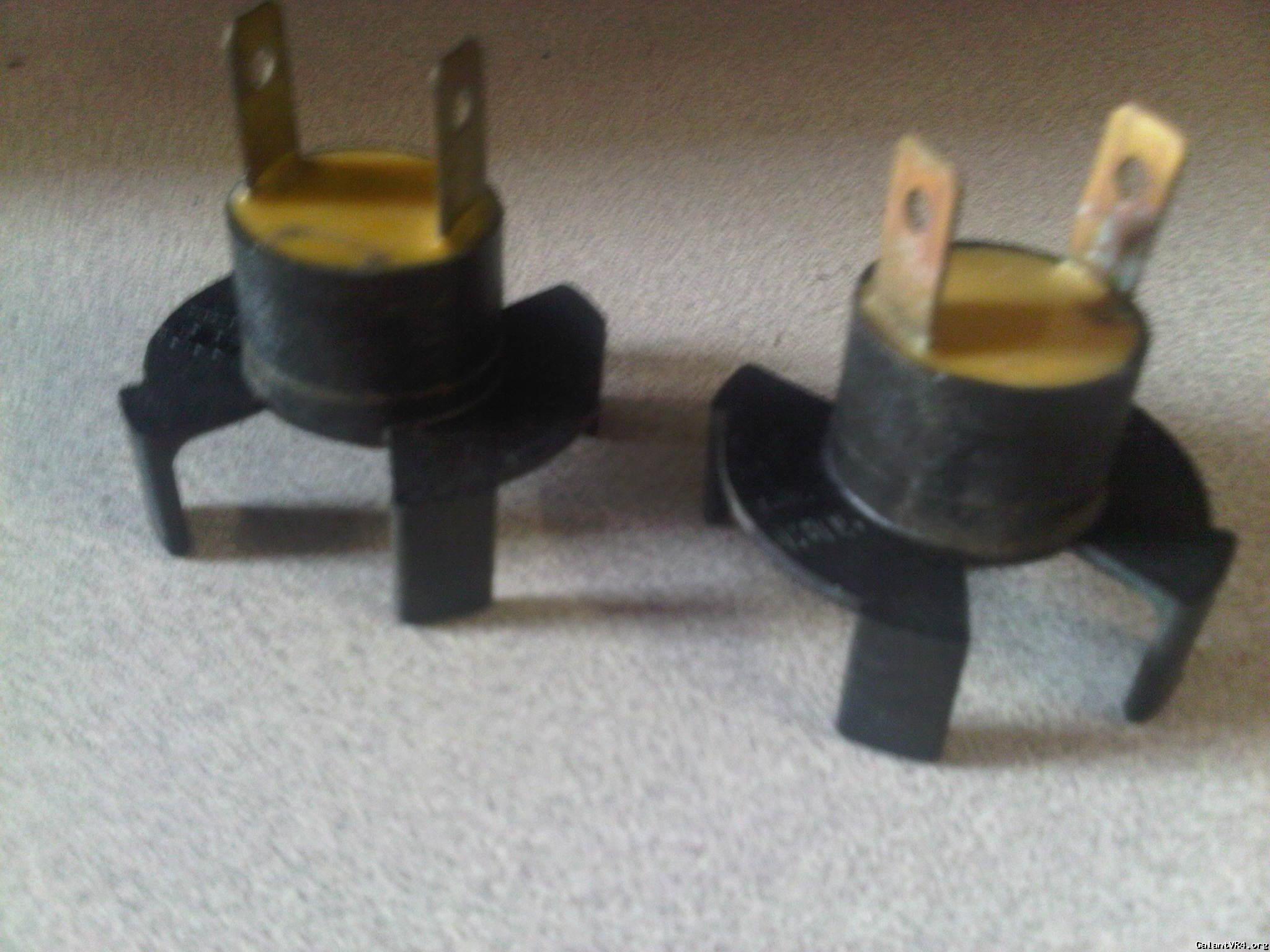

4. The H1 high beams require a special adapter that goes between the bulb (which has only 1-blade) and the wire harness (which has 2 blades). One of mine was broken. It took me almost a year to find someone in Australia who could hook me up with a replacement.
