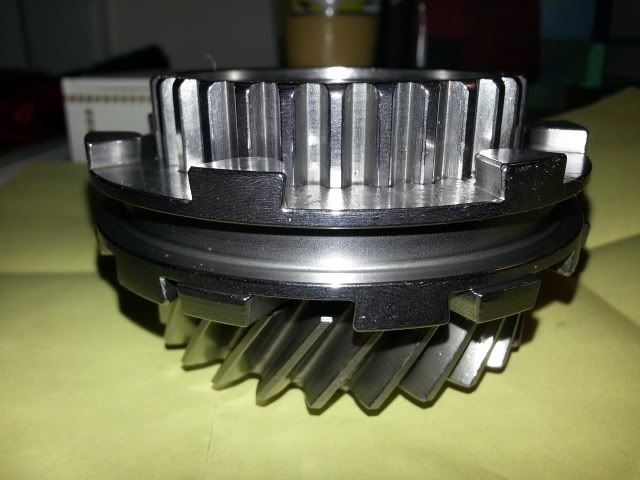

EMX5636
Jun 28, 2008
1,631
Bucks County, PA

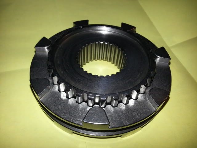

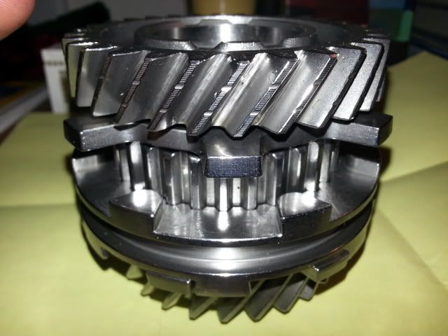

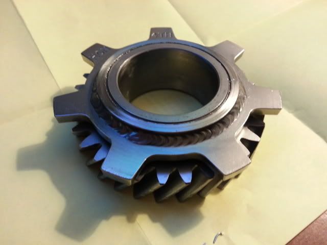

Well the long awaited..... tada!

that's some perty pieces right there...
looking forward to post-abuse results /ubbthreads/images/graemlins/devil.gif
donniekak
Jan 1, 2009
748
surprise az
I think this would be a good option for a big turbo, high rev build. I would be scared anything with a lot of torque would rip the teeth off.
EMX5636
Jun 28, 2008
1,631
Bucks County, PA
I guess it depends on what you think is a lot of torque, but for the most part I agree. They are stock teeth, so they can only take so much. These have been shot-peened, surface polished, and IIRC cyro treated so hopefully they lift the window a little bit. Only time will tell, but the car only made 508/394 at 31psi and the gears have held up so far. I'm shooting for about 570/425 with some more boost and maybe cam gear adjustments.

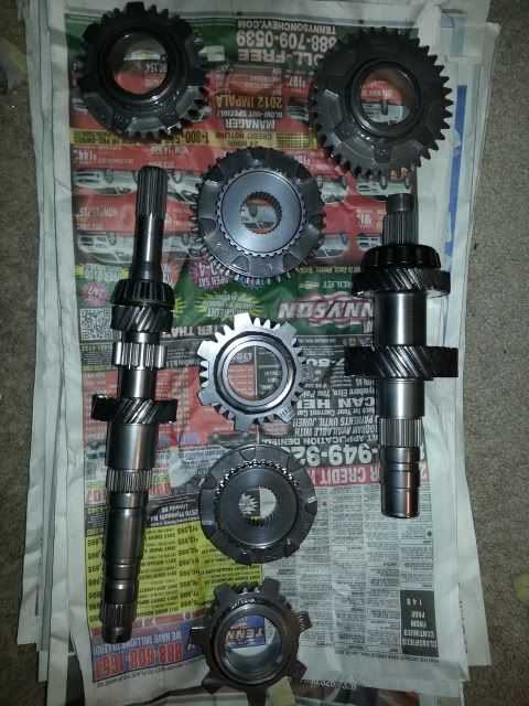

Got the rest of the trans cleaned up. I gotta swap my 91-up 4spider to the 90 case and decide on shift forks. I wanted a pair of Magnus forks, but they are on epic backorder. I have a billet BM Tranny 3/4 fork in my current trans, but I'm not sure how the aluminum will hold up. I might be stuck with Evo3 forks. /ubbthreads/images/graemlins/confused.gif
Anyone have any recommendations? Shep doesn't sell his anymore, so that option is out.

Settled on the Evo3 forks. Strength wise they are great, they just wear the plastic pads out. I got the trans together today, I'm hoping to have it back in the car tomorrow and finish a couple things up by mid week for some initial driving.
