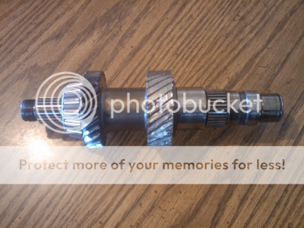

Quoting EMX5636:
Nope. There was a mix up with my 1-2 hub because I'm running an early 89-90 gearset (supposed to be a slightly stronger 3-4 tooth design) but it's a different bearing size and spline count. Downfall to this gearset, is you can't run the double cone second syncro with it (but I don't need syncro's and I have a few spares from trans upgrades for people). I'm hoping to get the revised one next week. Then assembly time.
Unfortunately I'll have to pull my trans apart to pull the billet aluminum BM / Turbotrix shift forks, and I already have an early 89-90 center diff machined for a 4-spider. But it should only be a day or two to swap everything and rebuild my Exedy twin.
I've got a 90 gearset in my car now with a double synchro 2nd.You can't just drop in the later 2nd gear, and double syncho, it can be machined for it though. It would be nice to have the shifting of dog teeth, but I'd be scared to death my investment would explode everytime I did a 3rd, or 4th gear pull.
EMX5636
Jun 28, 2008
1,631
Bucks County, PA
That actually looks like the late 90 gearset. See how narrow the flat end of the gear is? Check out this link . See how the early 90 has a broader/flatter end profile?
Actually though, you could be correct, it's tough to tell without the 3rd gear intact. /ubbthreads/images/graemlins/wink.gif
EMX5636
Jun 28, 2008
1,631
Bucks County, PA
I know the 89 production gearset I'm using has a smaller bearing and different spline count for the 2nd gear and 1/2 hub and slider. Might be able to be custom machined, but never heard of anyone doing it. Just swap to the 90.5 up stuff.
