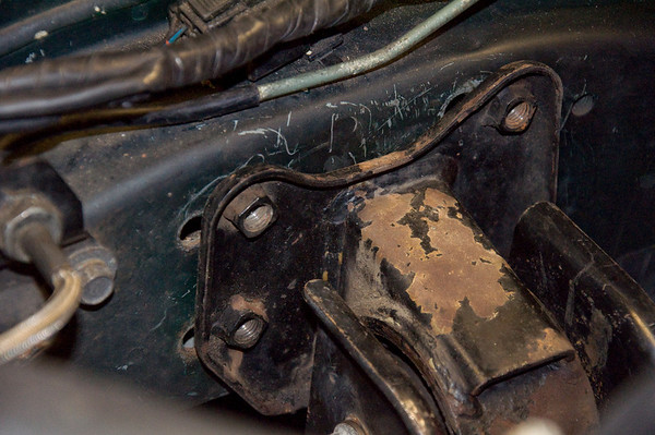

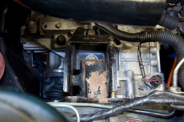

I'm just finishing up assembling 931 from a clutch job. I didin't notice it during dissassembly, but the trans mount is not lining up. The engine/trans seems to be shifted about a full inch tward the firewall
Mount bolted to the tranny and cross bolt in. 4 bolts to the frame are out:
Top view of how jammed up the mount is with 2 of the frame bolts in. Had to use a big ass prybar to move the trans/engine to the radiator to even get 2 bolt in. It's not good for sure!
The car has has a few engine swaps in it's lifetime by previous owners. The engine that is in the car now came from a 1g Automatic DSM. Is this what typically happens if DSM engine mounts are used instead of the GVR4 specific mounts? I would assume someone has run into this problem before.

The culprit is probably the front roll stopper at a minimum - the VR4 front mount is shifted towards the right of the car slightly, which might account for the twist you seem to have. The correct front mount bracket should be stamped "344" on the side.
I cant vouch for the rear mount - was it an AWD or FWD automatic? If it was FWD you would have the wrong rear mount as well.

Need a 195 in back, 344 in front. Jepherz needs to chime in, as I think he had to redrill the hole in his front mount. Can't recall if he had a 346 or 347.
195 is common to 1gs, but maybe not to automatics.
The trans mount you show is common and should not be the problem.

Tektic, the gvr4 specific transmission bracket no you want is in the second image the original poster posted. It is 22-H. If memory serves me the only distinction this bracket serves than a 1g AWD/Manual is the provision for 4WS steering pipe.
