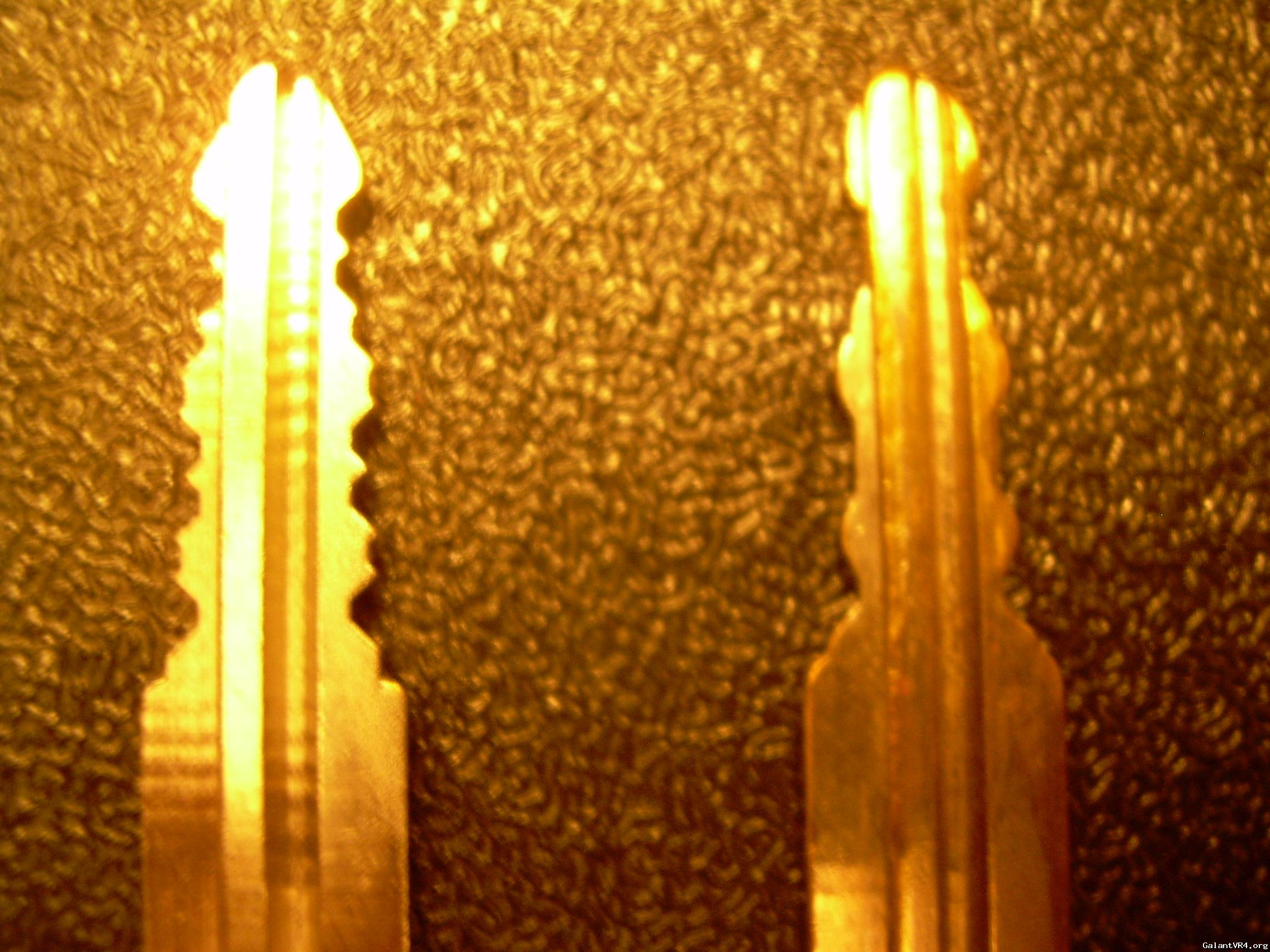

Thought you guys might like to see the difference between a key newly cut from code and a copy made from the 18 year old used original.
