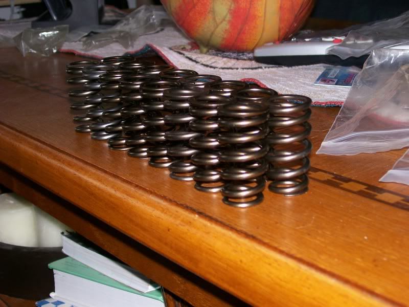

next i bought some cosworth valvesprings from jesse, thanks again! cosworth says these things are good to 13k... but ill only be reving to 8500.

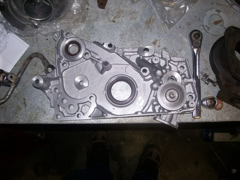

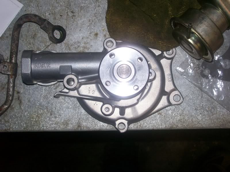

and just recently i got a bunch of random parts, scat rods, oem waterpump, and a topline oil pump.

let me ask you a q', if u are not going to be reving that high, why choose a spring with such a high seat preasure?is not going to do u any good, i would go with something more suted to your needs

well thats the thing i still havent decided whether or not i will keep them considering i have to find stock evo 8/9 retainers to use them (the springs are for evos). and i got them for 250 shipped, ther 300 brand new from cosworth. so i may sell these and buy a crower set that comes with titanium retainers, just havent decided yet.

looks good, my opinion would be to stay away from topline oil pumps though, we had 3 of them fail in 1 year. its been a while since i have seen a oem one fail, but hey its your motor.

new oem water pump
