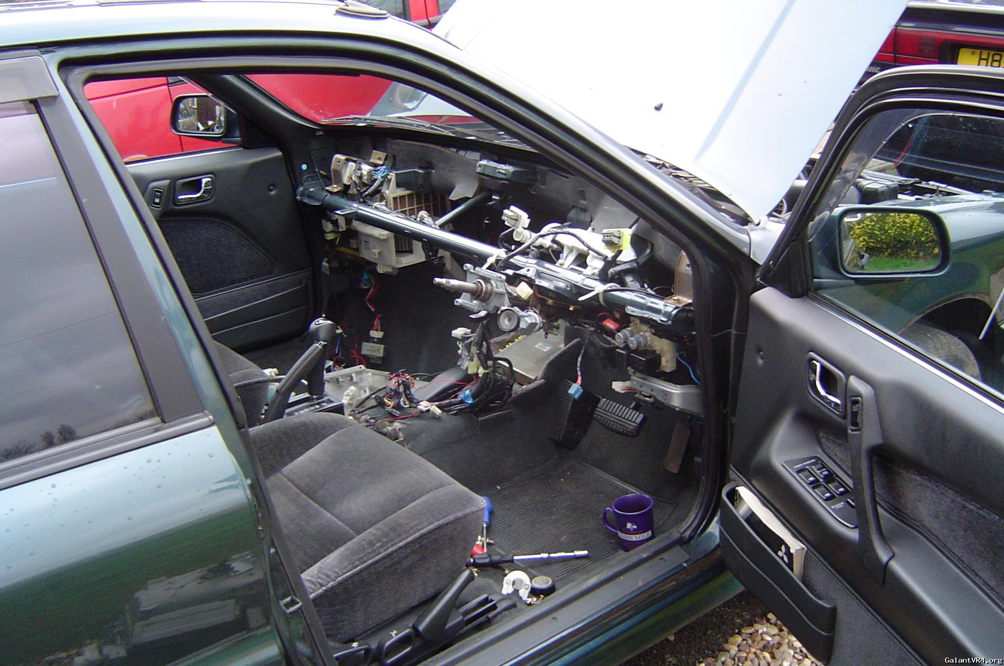

Its behind the radio under the heater box. He'll need to pull the centre console and the glovebox support, and steering wheel underdash.
Its a bit of a sod o get out. Three 12mm a/f bolts on the steel bracket (two on the firewall, one on the trans lockout cable clamp).
Here's the tcu right at the bottom:
