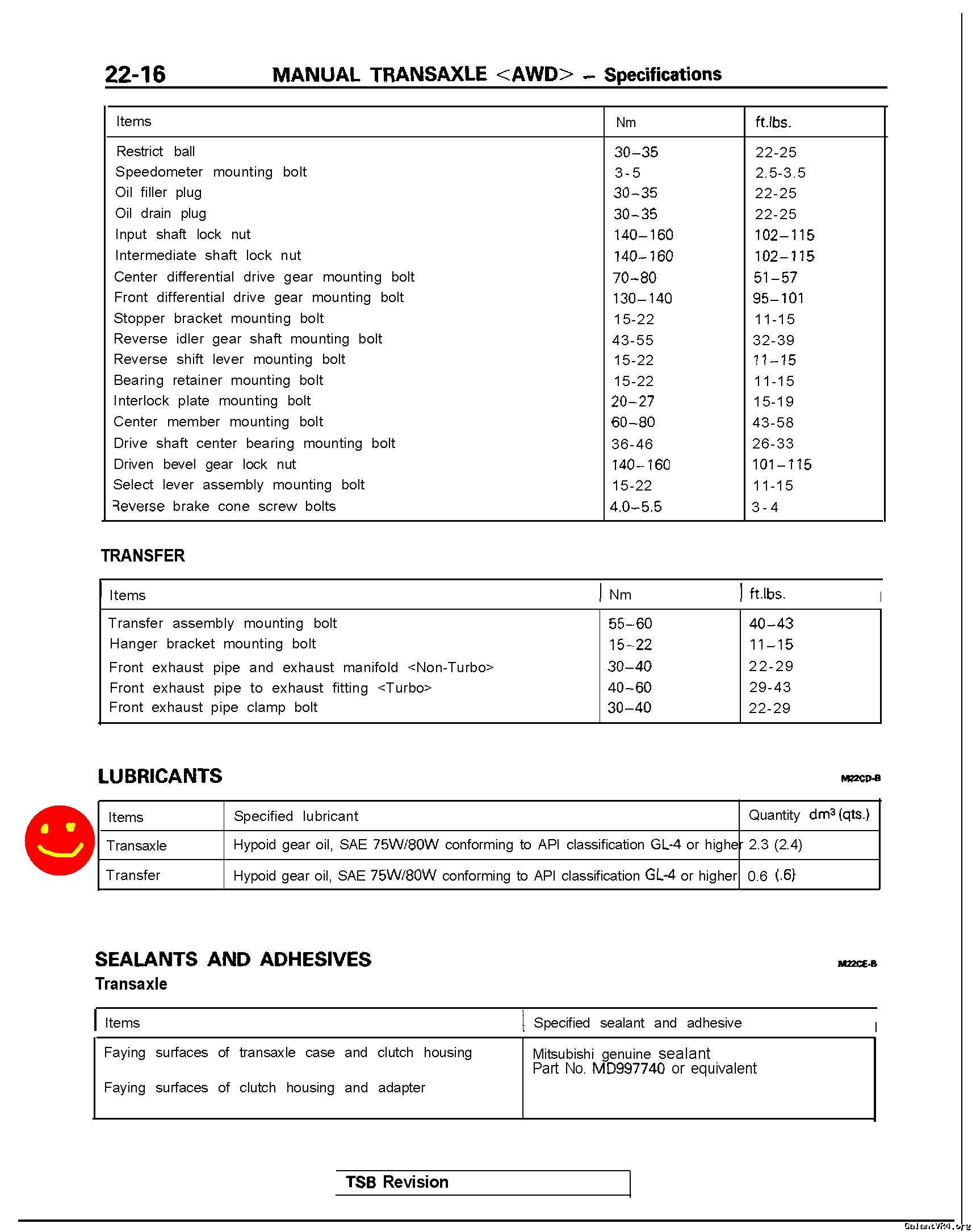

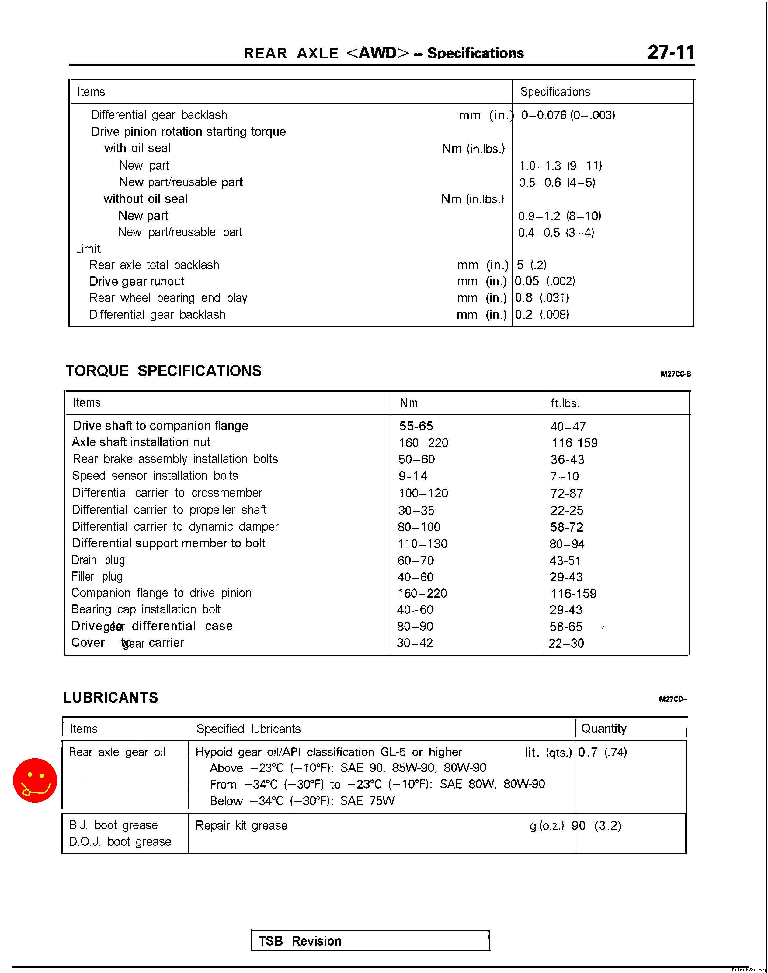

ok so tomorrow im buying a 91 GVR4 and i think im going to use 10w-40 engine oil and 75w-90 gear oil. my questions are how many quarts does the the engine, trans, transfer case, and rear end take? Do the trans, transfer case and rear end take the same gear oil? Do i have the right idea as far as the engine and gear oil weight?

Transfer case and rear end can use the same oil. It's good to use something heavy duty like Redline shockproof. Transmission oil is a little different since the oil also has to aid in shifting. Put in something too heavy duty and it's difficult to shift, something too light and it won't protect the gears as well. Search the site for people's opinions about what they like for transmission oil, as they're widely varied. I personally use Neo RHD. I don't remember the capacities for the tranny/xfer case/rearend off the top of my head, sorry.
