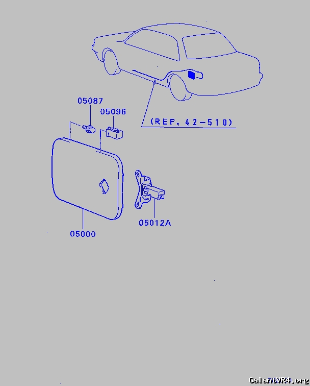

You need to download CAPS. It shows you the part and where it goes. I can't get out to the car right now to take a pic or I would.

There is an improved design available that came out in the mid to late '90s, so might be worth getting a new one. I will try to get you the pn. No working CAPS on this pc.

Here you go MB642442 (05096) Supersedes to MR970563

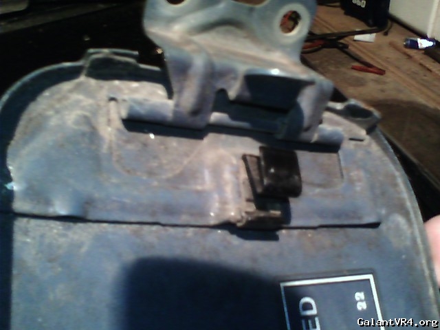

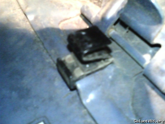

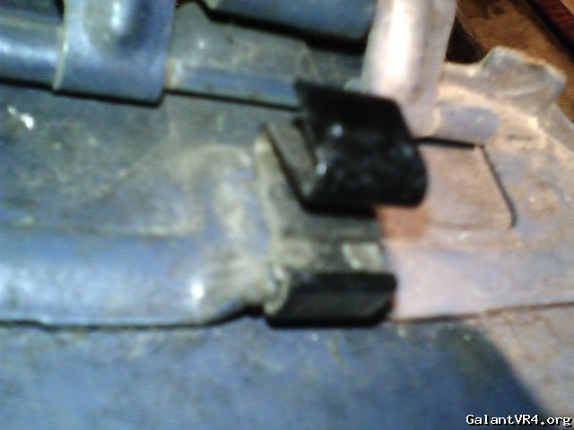

14u2nv, thanks for the pictures.
because of your picture, i figured out that i broke the plastic clip that holds the metal "S" in place.

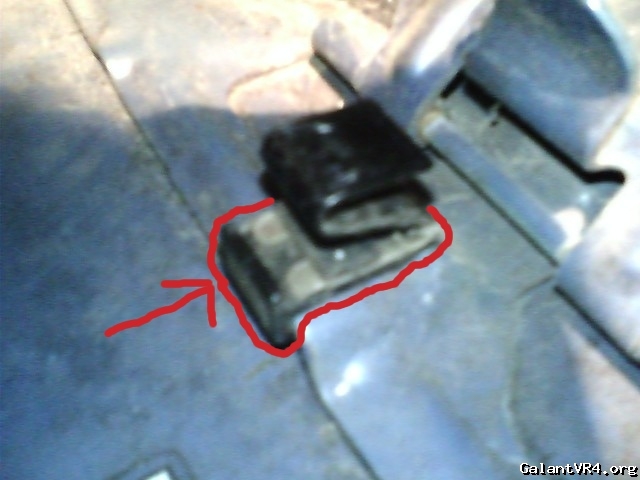

just so we're clear the part number MR970563 is for the plastic clip that holds the S-clip in place, not for the metal S-clip which i still have.
thanks
edit: i circled the part i need

The part number MR970563 is for the plastic clip that holds the S-clip in place AND for the metal S-clip which you still have. It is only sold like how it looks on the parts catalog.
11,006
As mentioned, all one piece. And it will be slightly different than the original. the improved design eliminates the clip falling off when it flexes (which the early ones can do).
