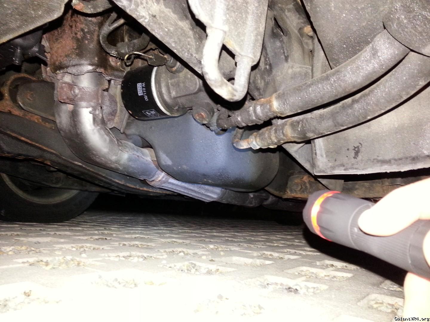

My engine is a 6bolt (i looked at the oilpan, i hope im right)

Look at the oil pan where it meets the front case, if it is flat across it is a 6 bolt
If it has a a dip to it it is a 7 bolt
Also if you pull the valve cover
The 6 bolts use a head bolt that you need a 10mm hex bit socket to remove
The 7 bolts will use a 12mm 12 point socket to remove

So.
im sorry. In the year '96 there was an enigne fail and prev. owner did a repair in the mitsu-shop. He paid near 4000$ for an new engine, and i have the bills here. They used Headstuds: MD121887, the have M12 screws.. so it would be a 7 bolt?
Pulling the whole engine down is a good idea, but not easy cause i need the car for work sometimes too..
I look to the oilpan the next days.

No a 6 bolt would have the 12mm head bolts (with the 10mm hex)
A 7 bolt has 11mm head bolts.
So if you have the 12mm head bolts, then you have a 6 bolt.
