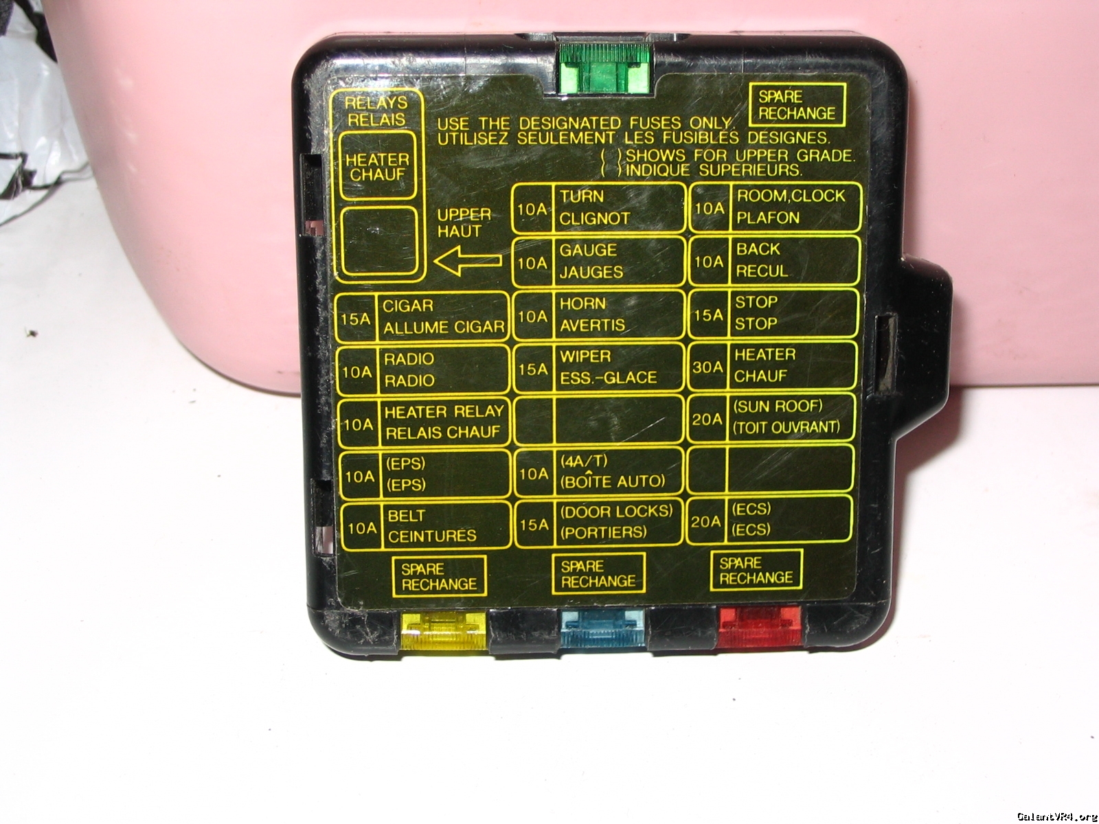

My fusebox lid is MIA, so can someone post a picture of theirs so I can read it or tell me what the headlight fuse is? My boost gauge worked fine and all then suddenly not, I'm suspecting fuse(s).
Here ya go. I had to go find mine; it too was not on the car. /ubbthreads/images//graemlins/crazy.gif

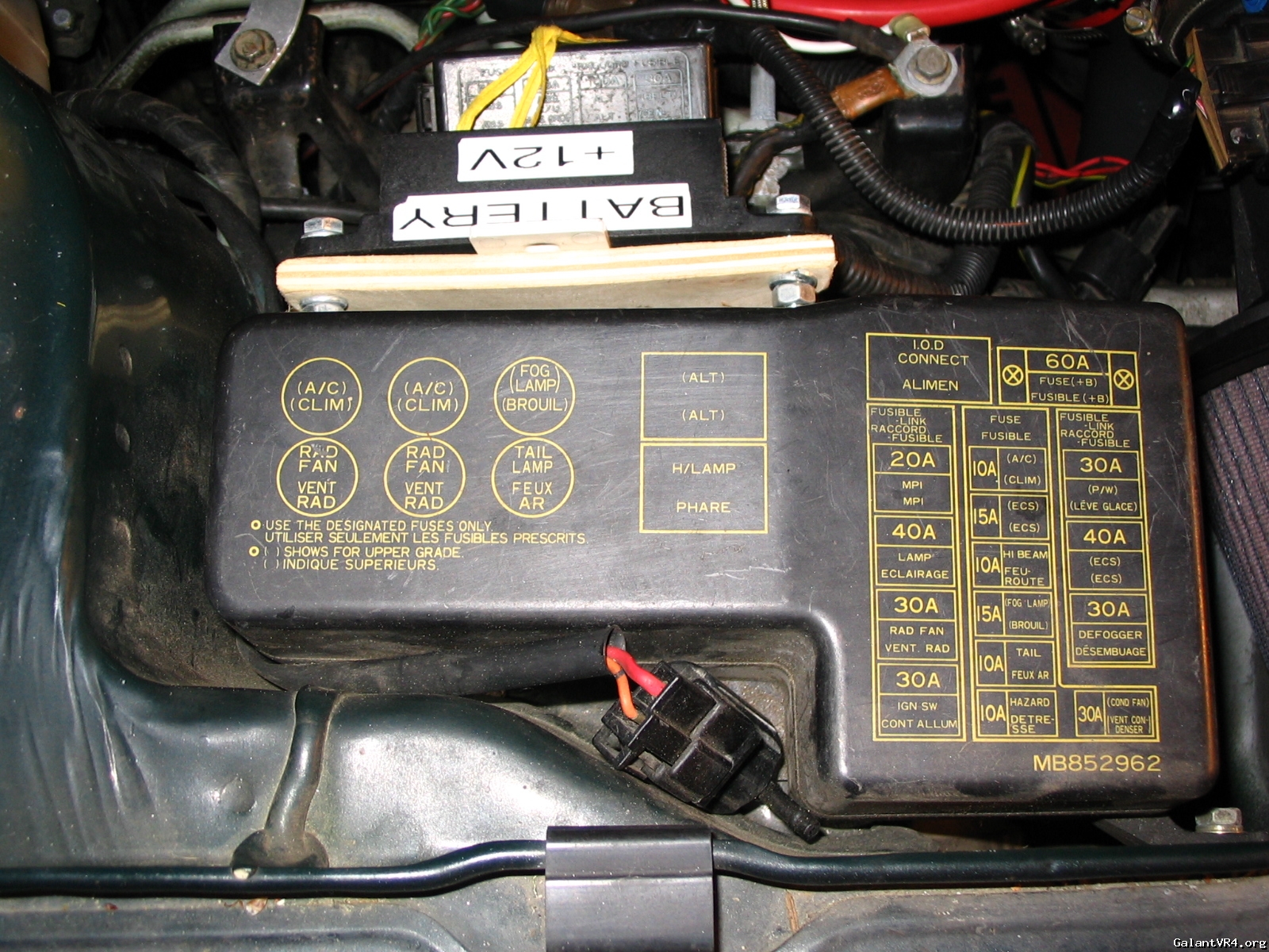

And while we're at it, here's the underhood fusebox.
