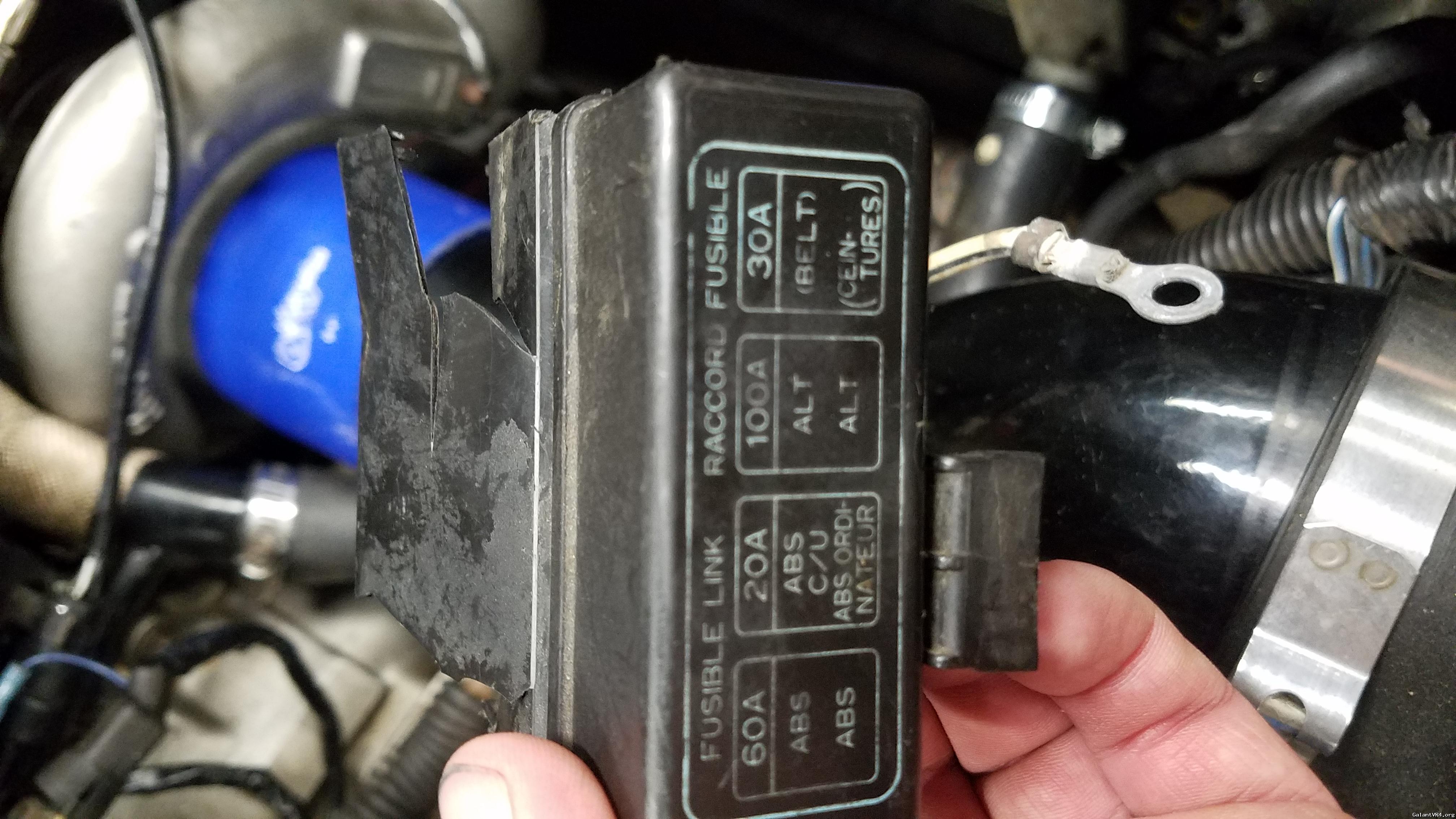

Fuseable link belt fuse what is it for?
snohacking
Mar 16, 2010
233
Menomonee Falls, Wi
What does the belt fuse on the fuseable link control. I would like to get rid of the fusible link and clean up the wiring. I am going to use an inline fuse on the alternator since I relocated the alternator and rewired with 4 gauge. I no longer have abs so I don't need the other 2 fuses.
I don't have power steering if that matters
10,992
Likely supplies the moving seat belt motors, since those operate without the car on, when you open the door.
