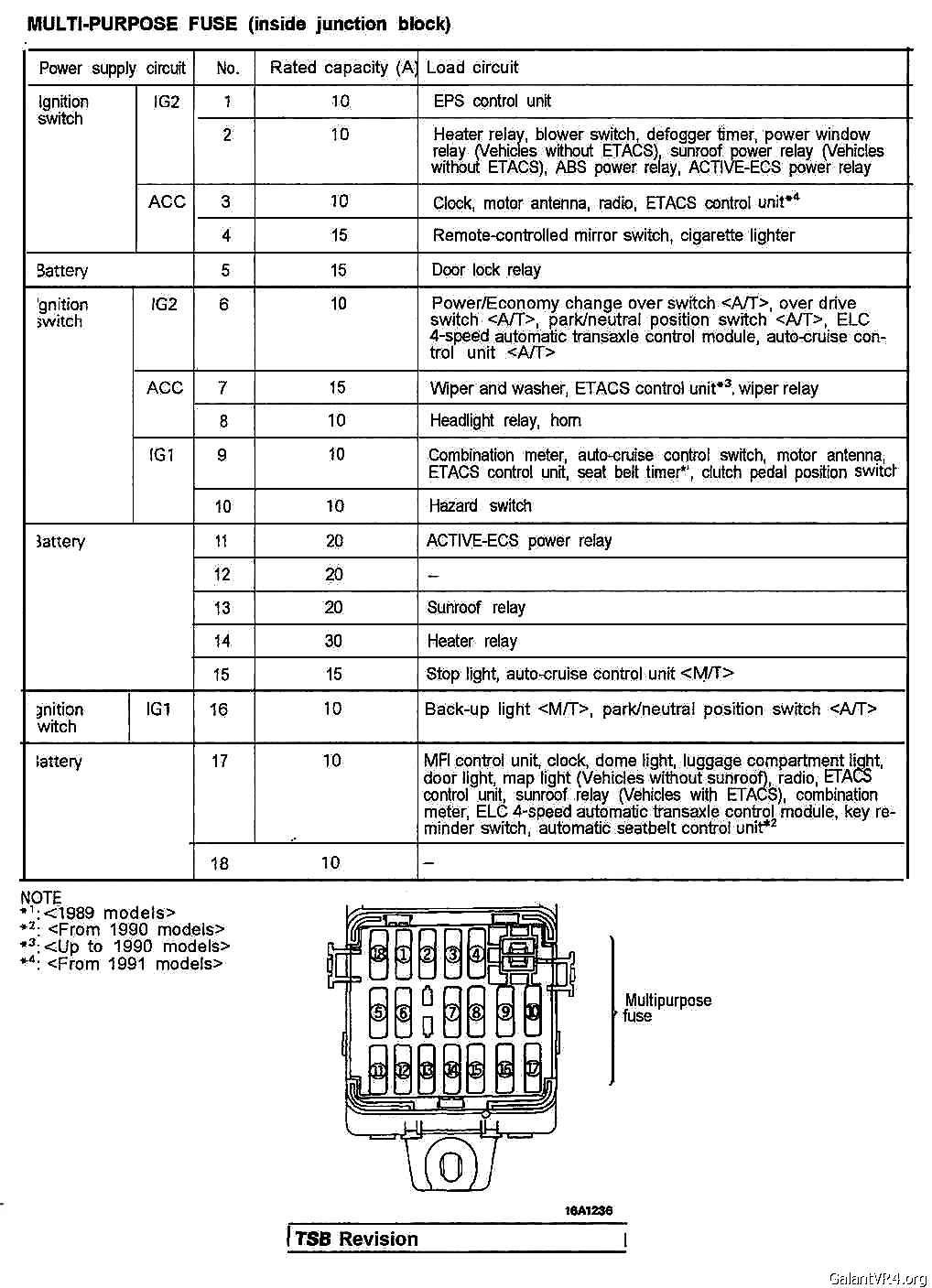

Anyone have the fuse diagram for our in-car fuse box? I searched, and looked in the Info Archive but its not there. It would be a good thing to have in the Info Archive. Plus, I need it. /ubbthreads/images/graemlins/grin.gif

Hey the pic is broken. /ubbthreads/images/graemlins/mad.gif

Yes please re-send it. Something is screwed up obviously!
edit: its working now, thanks for reposting!
