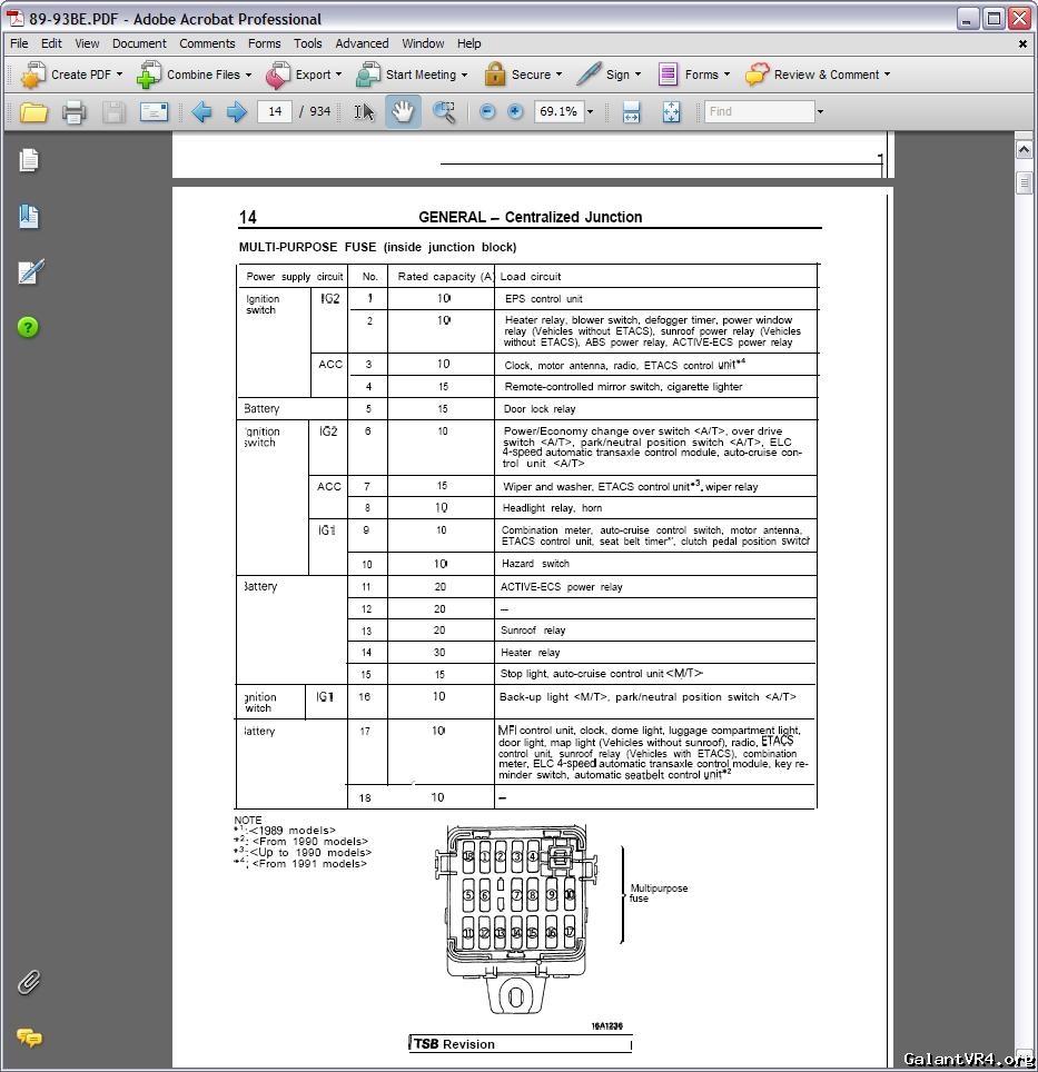

Does any one have a diagram for the interior fuse box layout? My a/c and heat does not blow any air at all so i want to check the fuses first before i check the actual blower/motor, but there is not a fuse box cover so i need a diagram to figure out where all the fuses are. thanks.

/ubbthreads/images//graemlins/worthy.gif Thank you so much. /ubbthreads/images//graemlins/smile.gif
