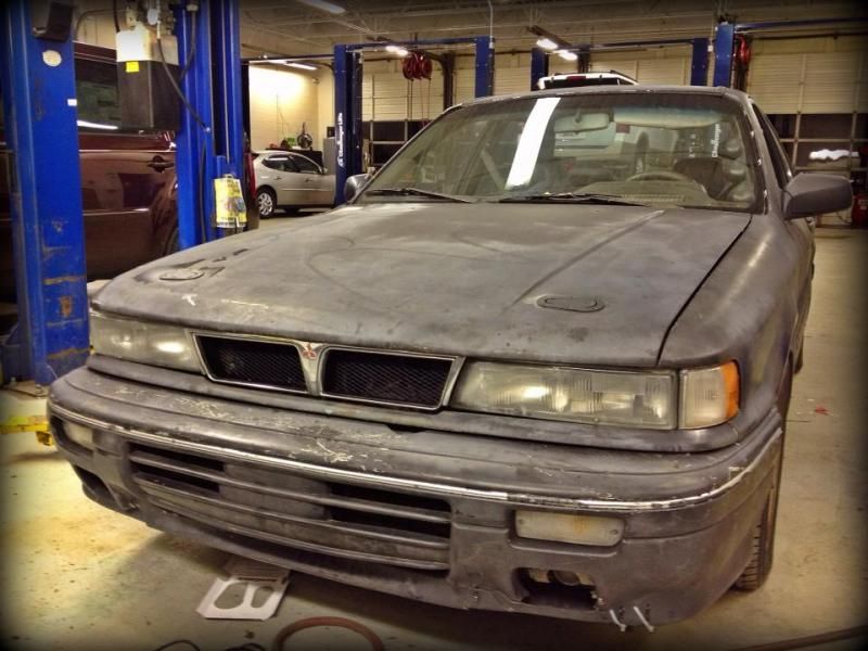

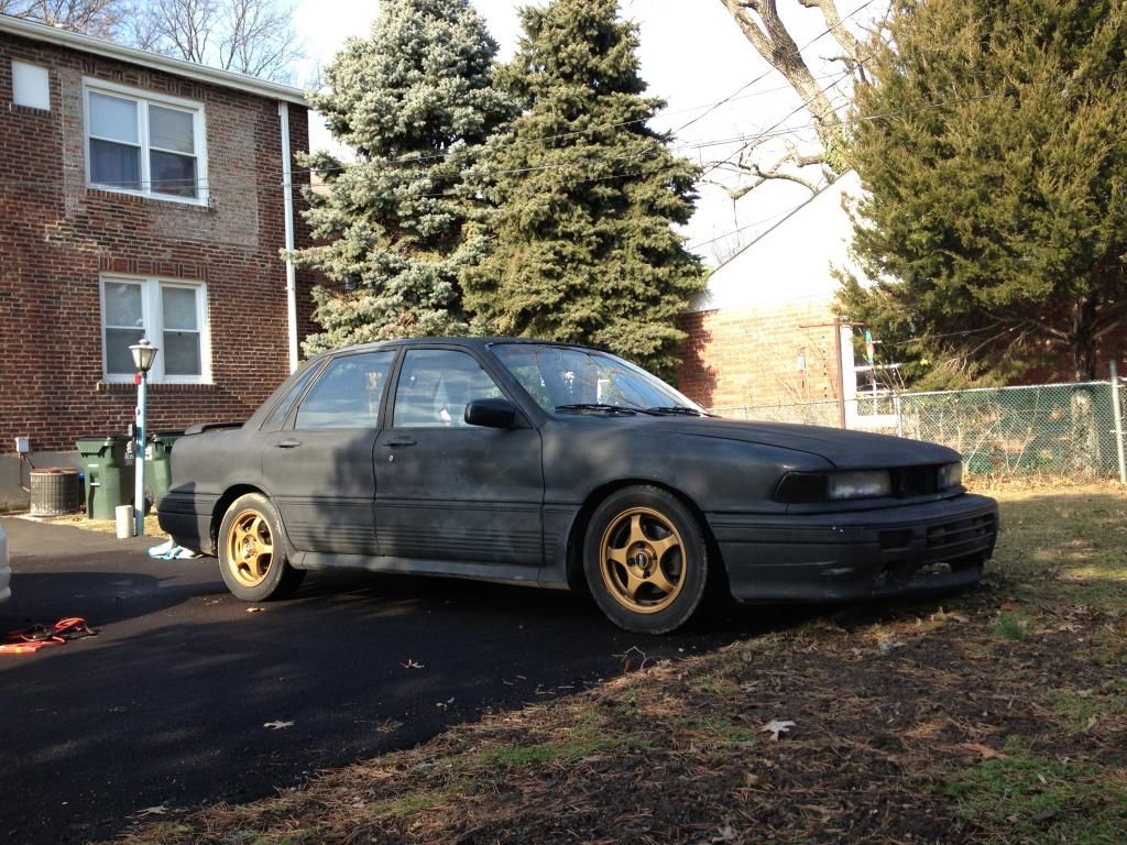

I've owned this Galant for about a year now. The car has come a long way since purchase, I'll try and keep this thread updated as much as possible.
Unfortunately the badges were all ripped from this car. Has been rattle canned chalk board black, And overall looks like its been used and abused. Picked this thing up with 253,xxx
![047.jpg](/proxy.php?image=http%3A%2F%2Fimg.photobucket.com%2Falbums%2Fv299%2Fnitrobasher%2F047.jpg&hash=351b75ab3f6bfc26d8dfae012320a65a)
Drove to Tennessee from Missouri to pick it up...
![016_zps0ad273cc.jpg](/proxy.php?image=http%3A%2F%2Fimg.photobucket.com%2Falbums%2Fv299%2Fnitrobasher%2F016_zps0ad273cc.jpg&hash=8b5b753ce4ef61d510727badb1d14e10)

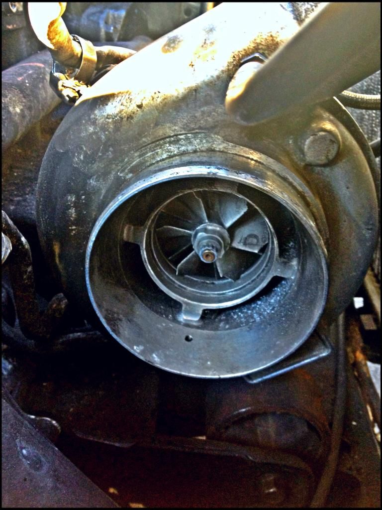

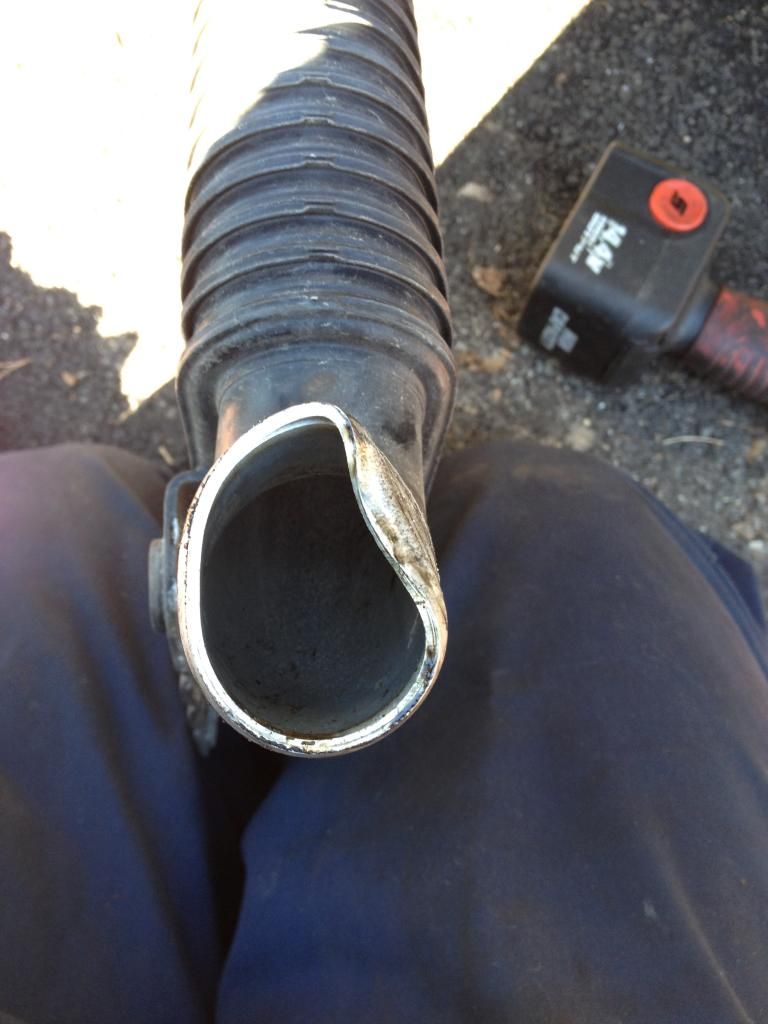

Started tearing it apart to assess the damage and get an idea of what I was in for... First thing I found was an FP3052, vband housing with tial waste gate. Car was also equpped with GM MAF and Turbo back exhaust. Unfortunately the FP turbo had seen better days. I quickly found the reason this car wasn't building boost. Upon further tear down I found a mesh screen (probably used as a filter) was sucked through the turbo, I found bits of it on my MAF screen as well...
![021-1_zps97bc32ba.jpg](/proxy.php?image=http%3A%2F%2Fimg.photobucket.com%2Falbums%2Fv299%2Fnitrobasher%2F021-1_zps97bc32ba.jpg&hash=4884a80f4c3e253bf1ba813405b29b27)
![0062-2.jpg](/proxy.php?image=http%3A%2F%2Fimg.photobucket.com%2Falbums%2Fv299%2Fnitrobasher%2F0062-2.jpg&hash=454c022a4b057948166f3dc55bb4ce8b)
![0072-2.jpg](/proxy.php?image=http%3A%2F%2Fimg.photobucket.com%2Falbums%2Fv299%2Fnitrobasher%2F0072-2.jpg&hash=28a6df1f9853b3be6ba270d11c587e62)

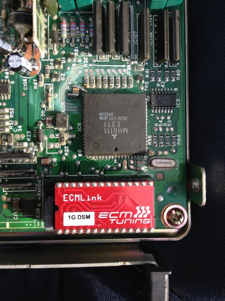

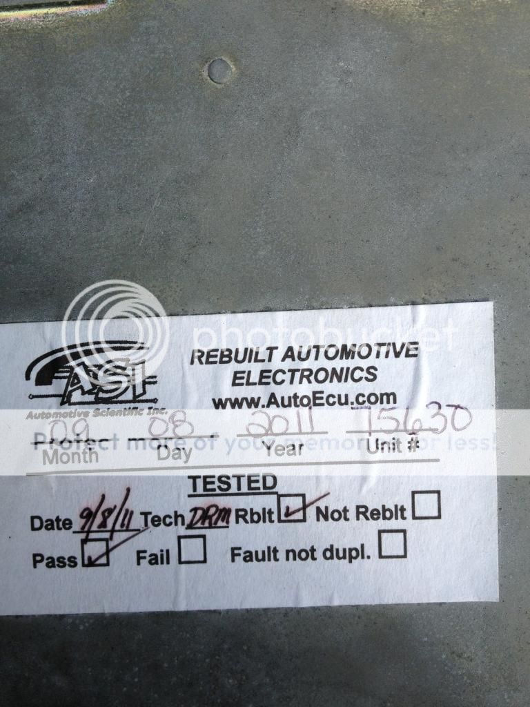

I began pulling the interior apart to clean and try and freshen it up a bit. Pulled the ecu to look for any signs of damage and found a rebuilt sticker on the ECU from 2011. Sweet. When I pulled the cover boom, ECMLink V3 full. Super awesome find! The previous owner was not aware the car was equipped with link. (at least he didn't talk about it)
![025-2_zpsbe1a49bb.jpg](/proxy.php?image=http%3A%2F%2Fimg.photobucket.com%2Falbums%2Fv299%2Fnitrobasher%2F025-2_zpsbe1a49bb.jpg&hash=50478693c4673554abf5ea753517d3f0)
![026-2_zpsf8132ce2.jpg](/proxy.php?image=http%3A%2F%2Fimg.photobucket.com%2Falbums%2Fv299%2Fnitrobasher%2F026-2_zpsf8132ce2.jpg&hash=a457c2000930350ad4661b25898dcb35)

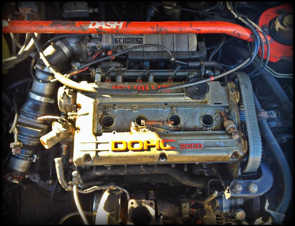

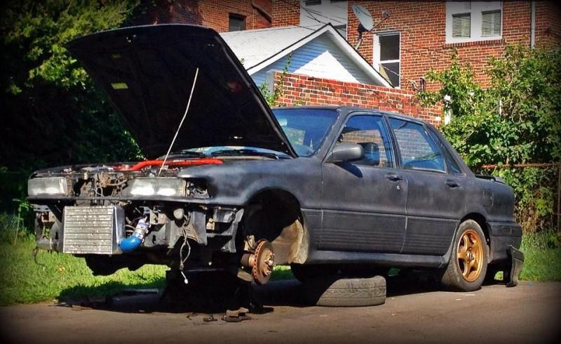

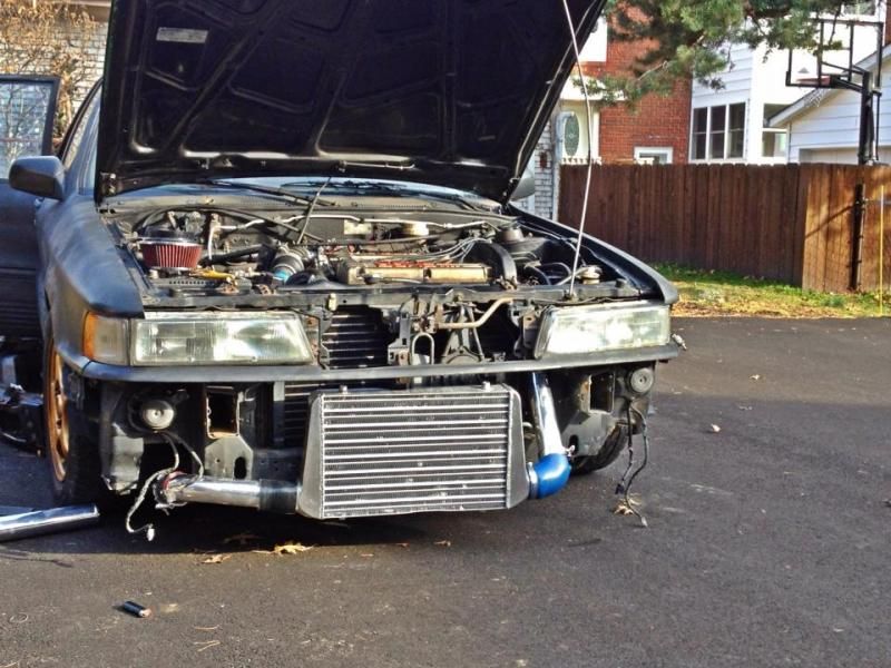

First things first. I wanted to get up to date on all the maintenance items this thing needed.
Front Lower ball joints, Inner & Outer tie rod ends, Both front and rear wheel bearings, Timing belt/ Water pump, BSE kit, Thermostat, Coolant Hoses and an entire front engine gasket set. This engine was puking oil when I first got it. I have no bigger pet peeve than leaking engines, drives me absolutely insane! Unfortunately I don't have too many pictures of the maintenance stuff.

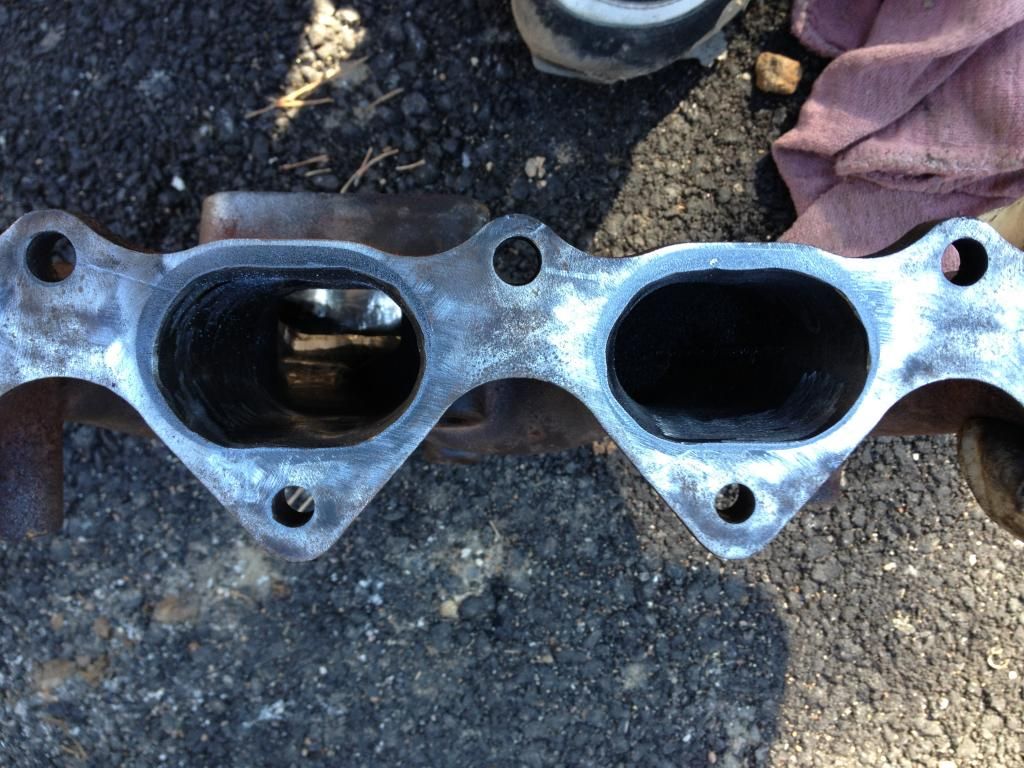

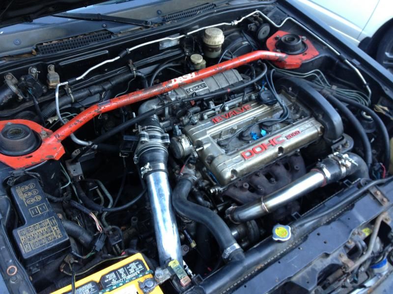

I've been stock piling parts on the side while the maintenance stuff has been happening. The FP turbo will need rebuilding so for the time being I put a baby 14b on. While I had it apart I ported the stock Manifold and o2 housing. I installed the FMIC with 2.5" hard pipes. Got some FIC 1050cc Injectors, Fuel Lab FPR, LC-1 WB, AEM BoostGauge, AerpCatch Latches,

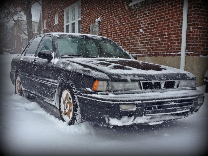

I've put 500 miles on the car since everything has been done. I still have a lot ahead of me but I feel confident the car isn't going to break down or leave me stranded which is always my number one goal. Now that most all of the maintenance has been done I'll be focusing more on making a bit of power, as well as a bit of body work in the future.
St. Louis just got record snow storms and the galant has been a champ in this weather, pulling me anywhere I need to go...
![052-4.jpg](/proxy.php?image=http%3A%2F%2Fimg.photobucket.com%2Falbums%2Fv299%2Fnitrobasher%2F052-4.jpg&hash=cd9271f7b0996cbfc0855688e8759a76)
![051-3.jpg](/proxy.php?image=http%3A%2F%2Fimg.photobucket.com%2Falbums%2Fv299%2Fnitrobasher%2F051-3.jpg&hash=9cdfc8c74b61bd23fff128e6efab635a)
