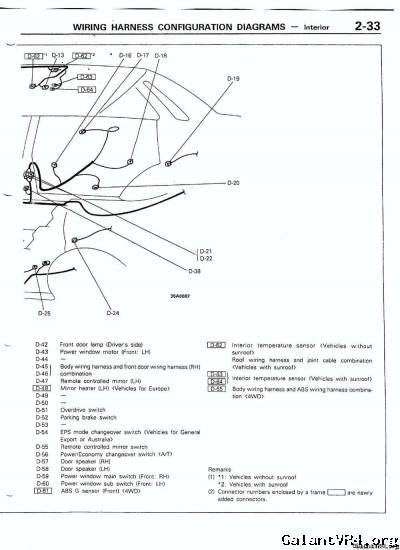

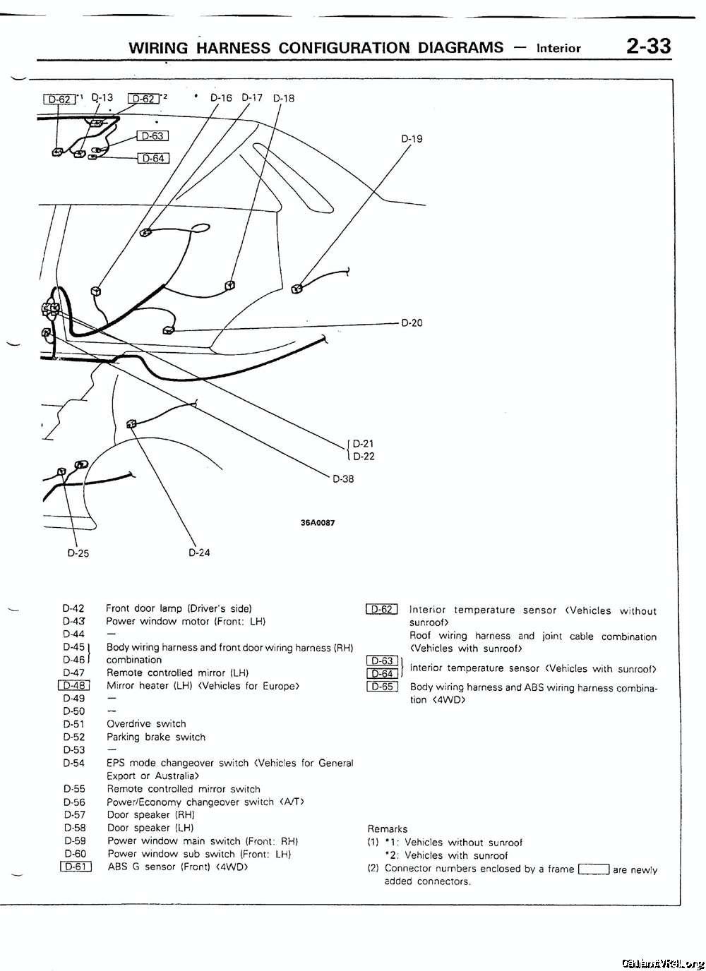

With your hands-on experience, you gotta be right. I verified that I got mislead by the documentation where it refers to two grips (D63 & D64) for interior temperature sensor in models with sunroof. Document image:
