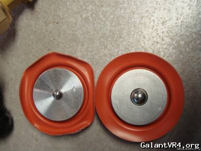

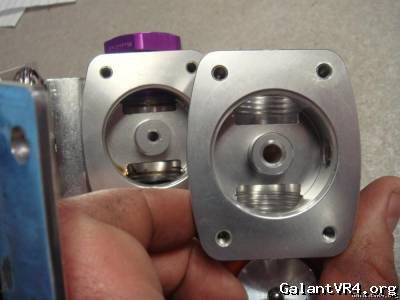

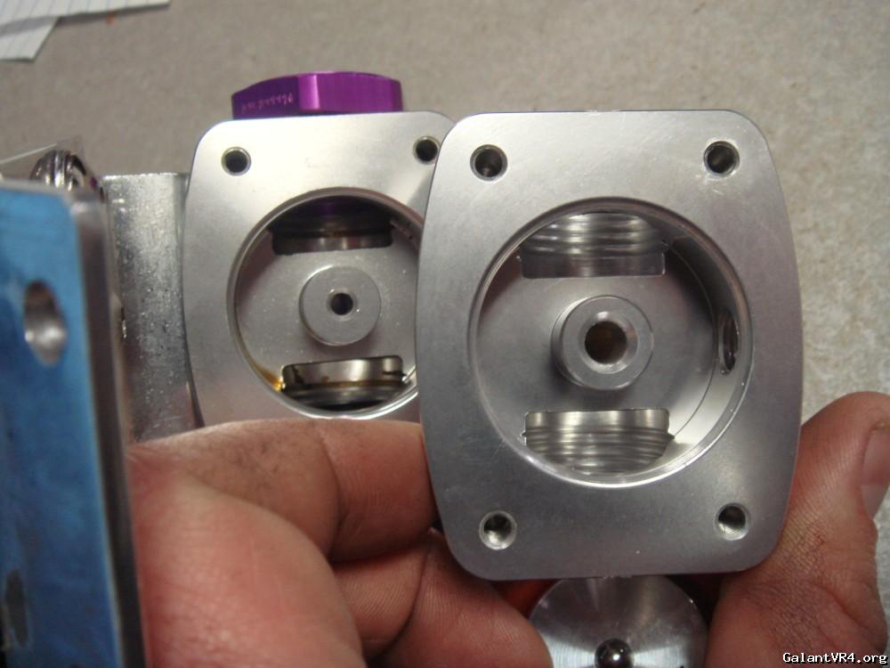

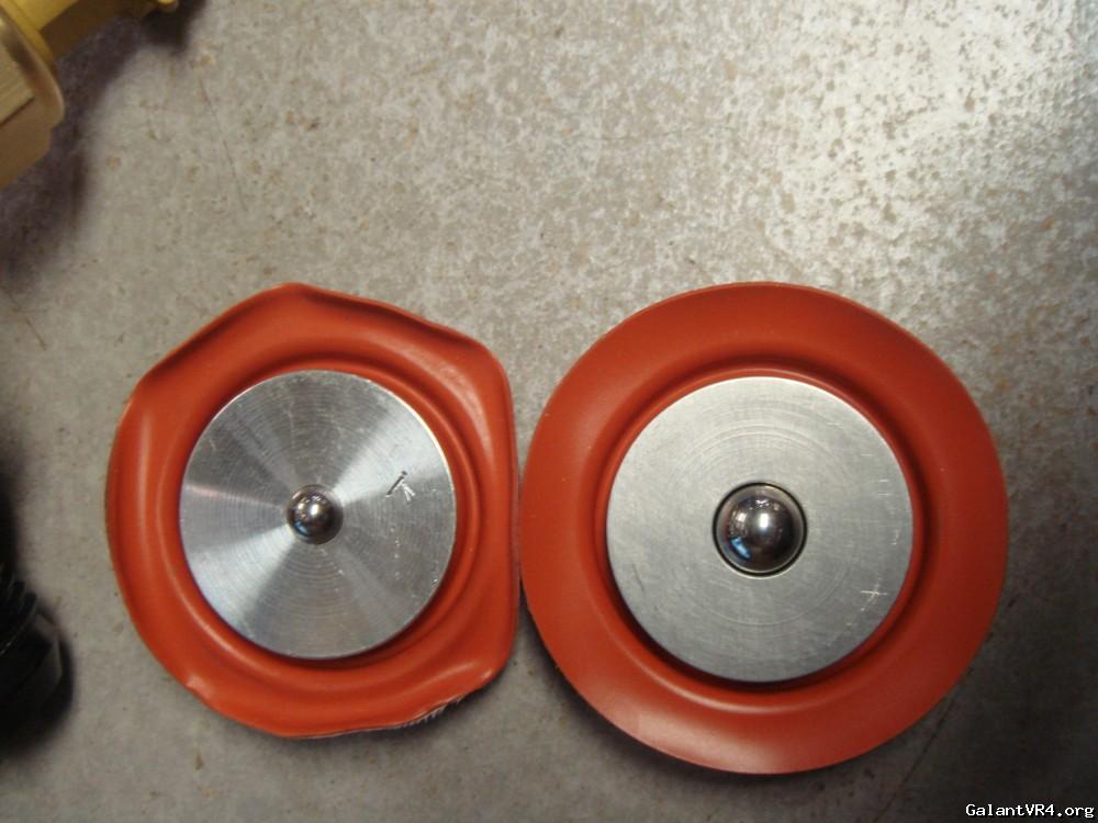

Got the car running last night with 37 psi so new regulators working will right some new details and pics soon /ubbthreads/images/graemlins/grin.gif
onesickcrx
Jun 3, 2007
1,076
NY
I didn't take the time to measure it which is uncommon for me, but you can clearly see its a whole lot bigger.
The proof is there I was out flowing the regulator, I put this new one on nothing else changed it worked perfect set to 37psi. I found a test done on setup similar to mine with smaller fuel lines made 470lph at 13v mines 14v so that's probably the difference /ubbthreads/images/graemlins/crazy.gif
