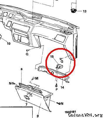

Also known as MFI Relay. CLICK here for relay & pump schematic.
Stock location...
^^^ Thank you very much, finally I could find it and plug the fuel pump wire as it used to be before using the Haltech. The car works again /ubbthreads/images/graemlins/smile.gif
