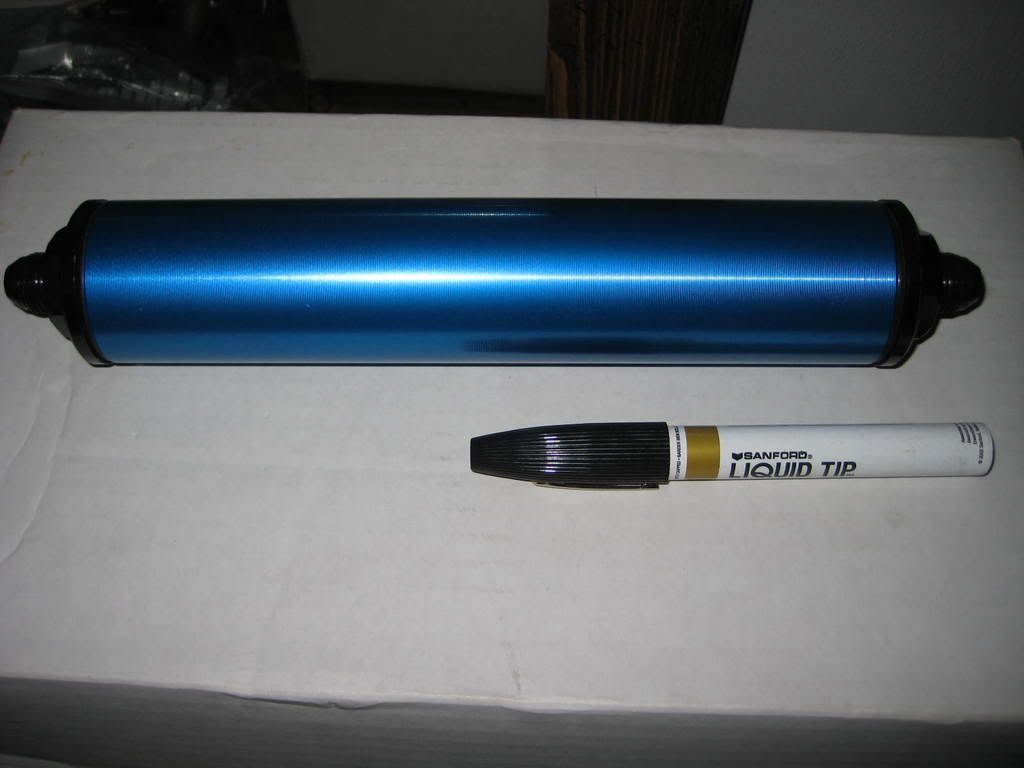

Quoting belize1334:
Yeah, I think if I were going -6 from tank to rail I'd just bite the bullet and put an Aeromotive filter inline too and be done with it.
you can buy this one from all star. it cheaper then aeromotive and you dont have to but the fitting.
i have ran both for years with out a problem
