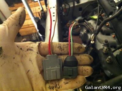

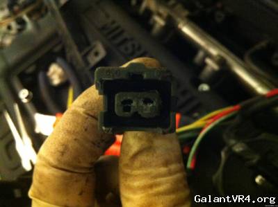

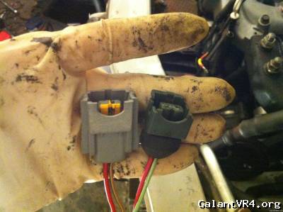

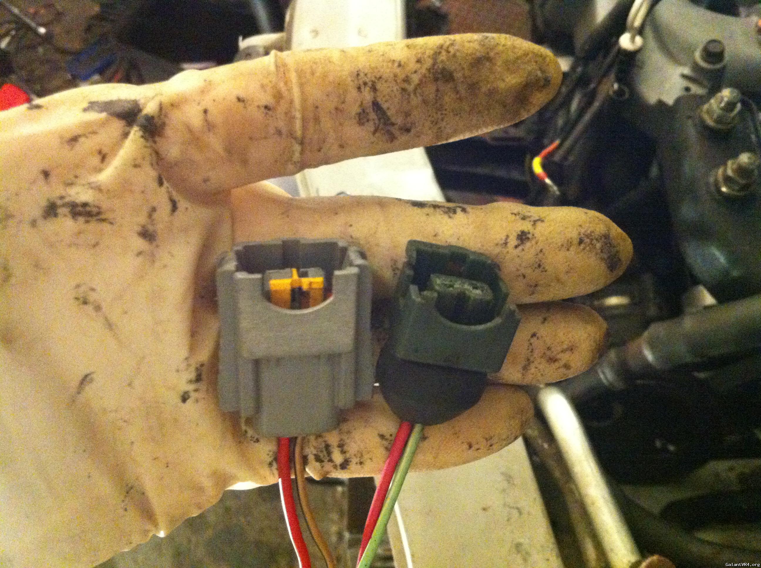

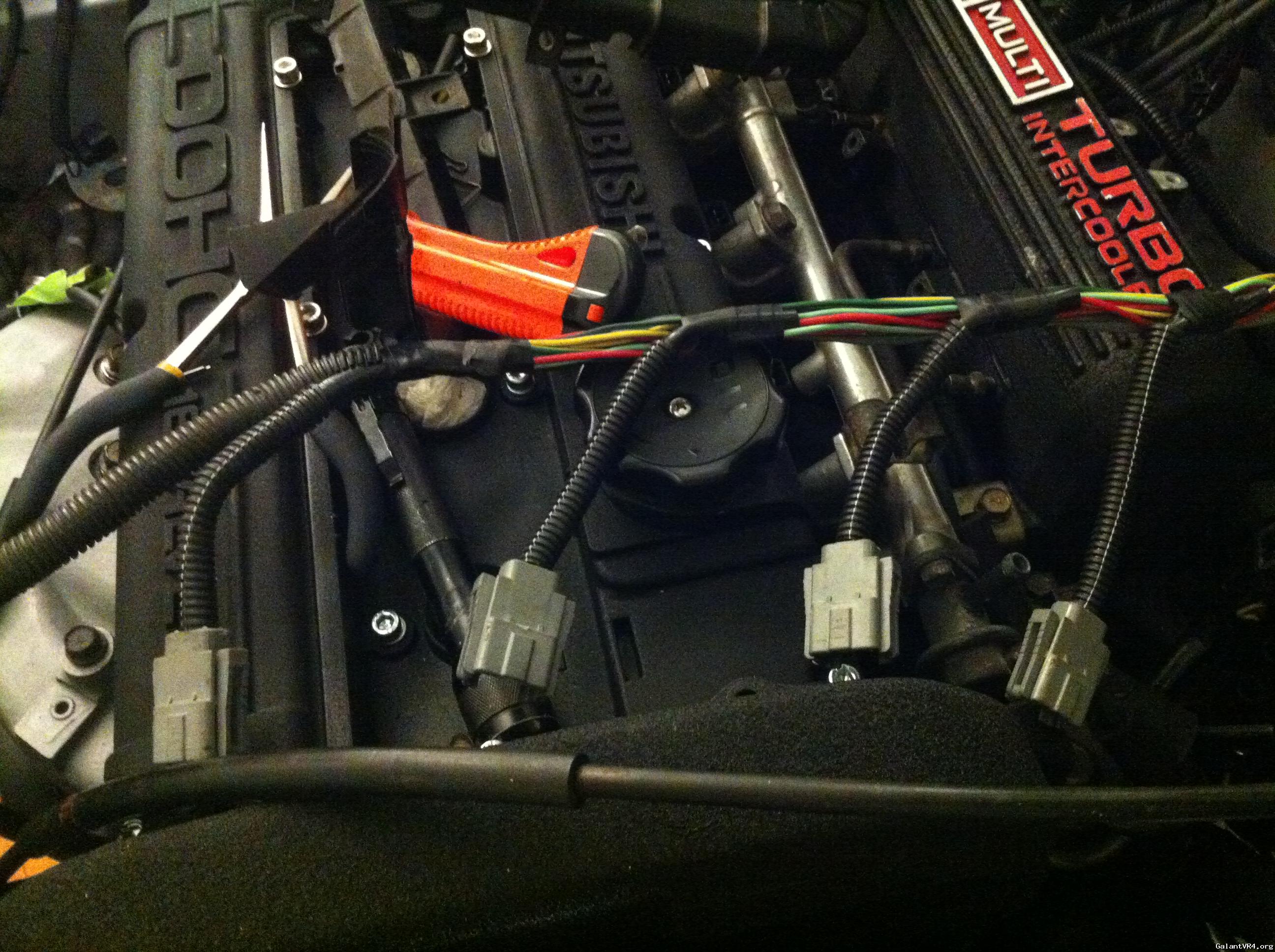

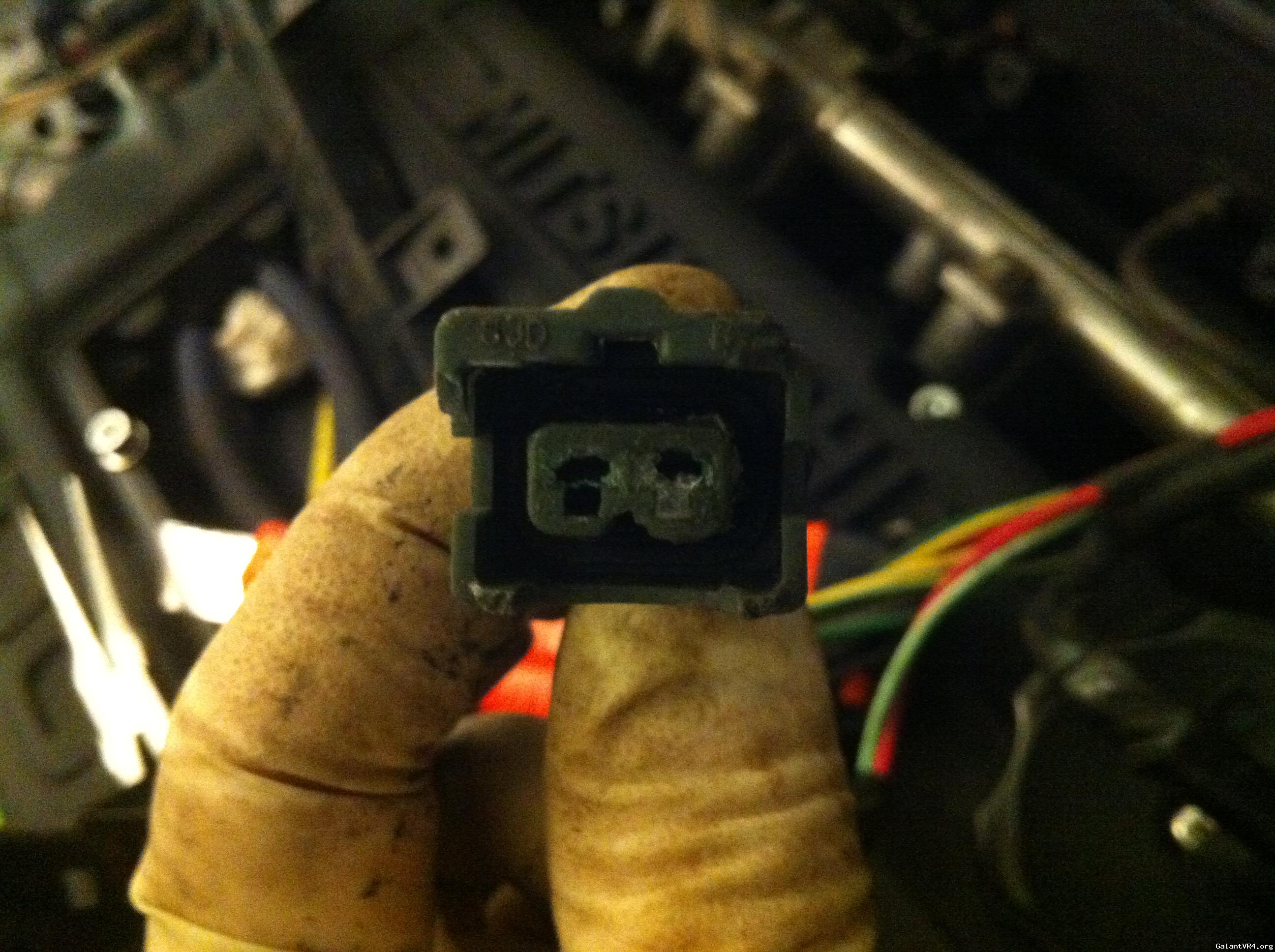

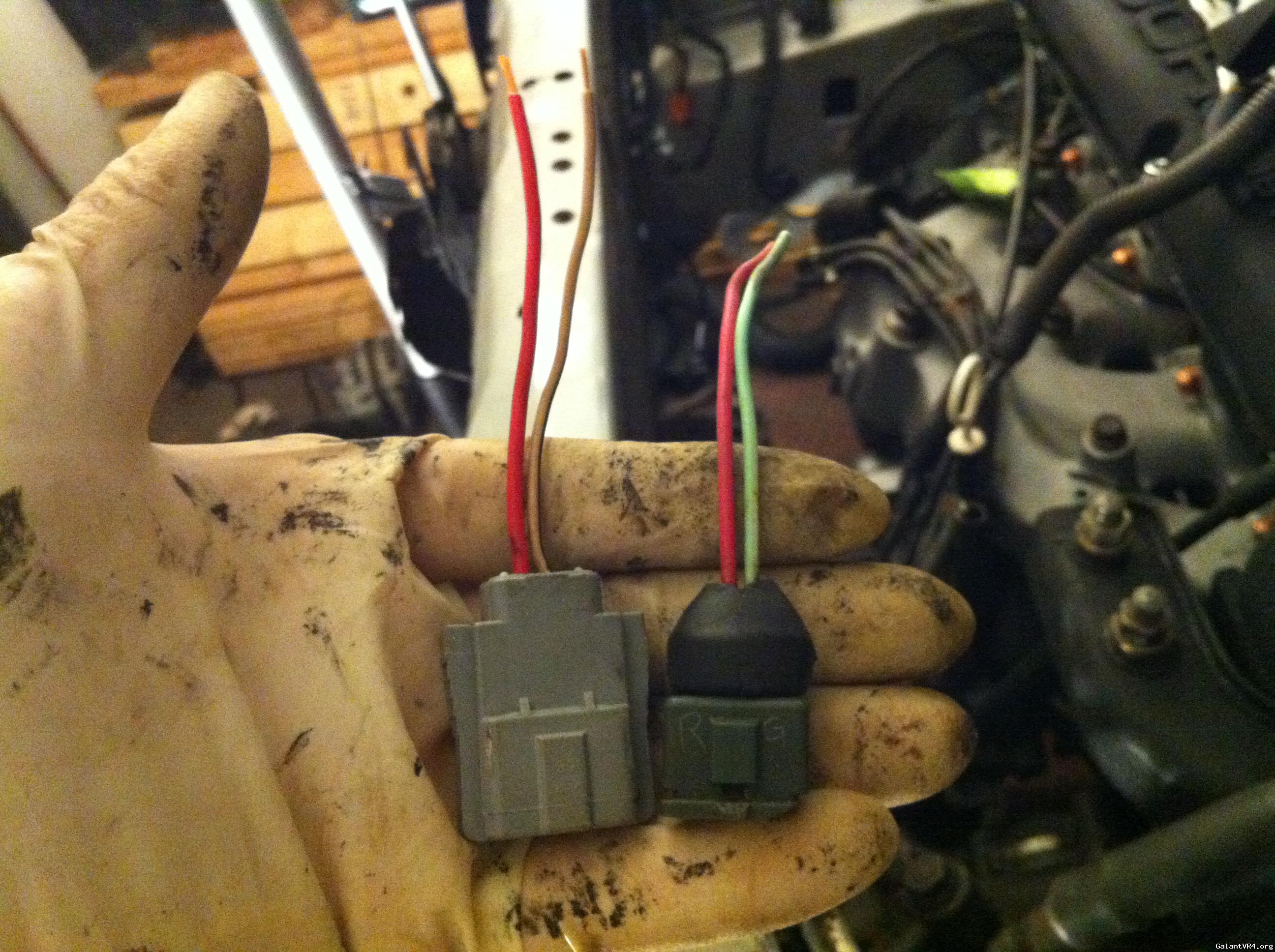

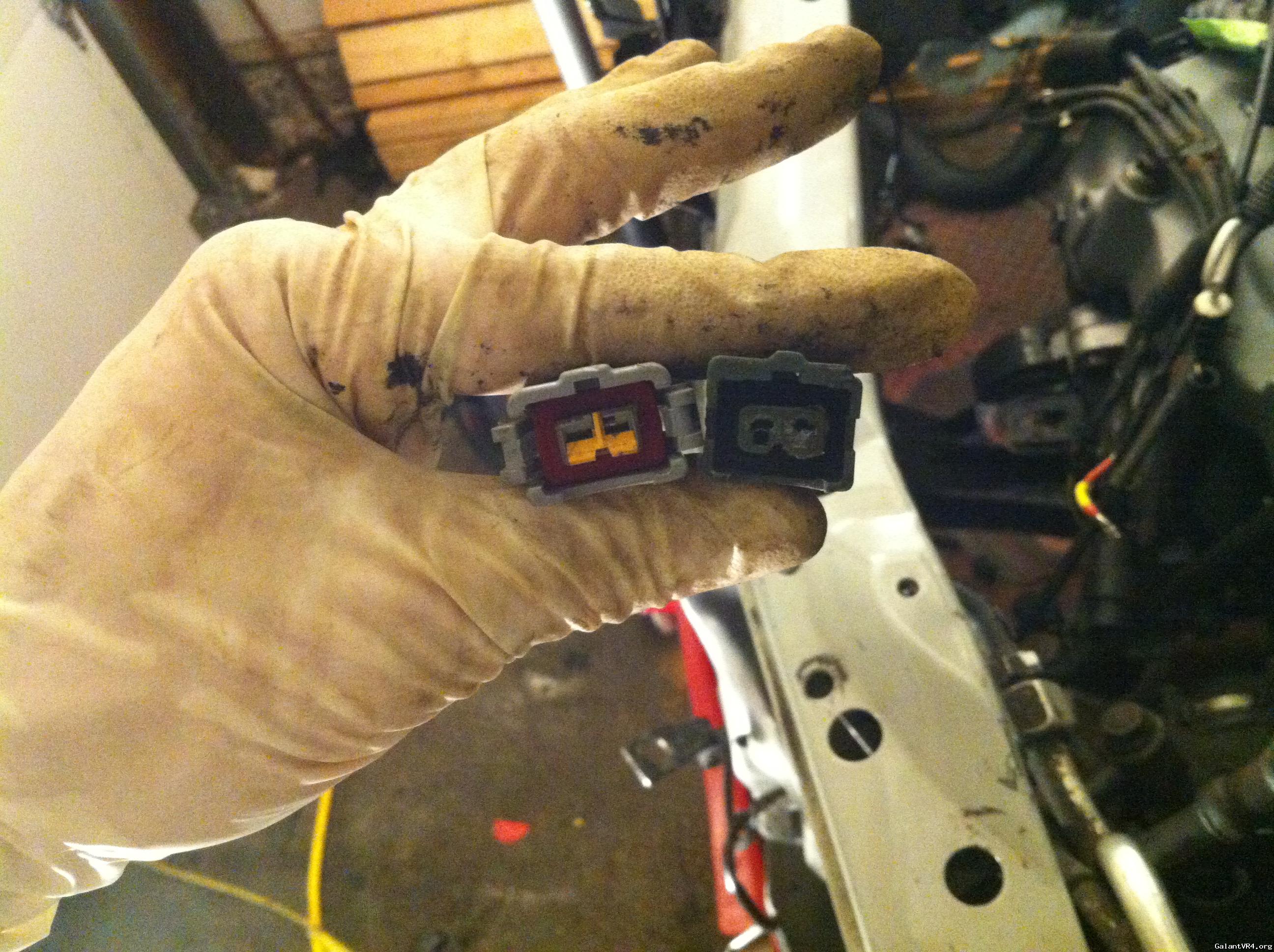

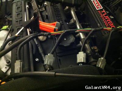

I strongly suspect these are and having worked on Caravan's with these same injector connectors, Caravan injector connectors - quick release style.
Mine came from Ebay and had some portion lightly sanded so no one would know the OEM the came from. They were cheap, so I bought them right away because I wasn't aware of
the pick and pull yards in my area anymore (which were around unbeknownst to me just a 20 min drive away).

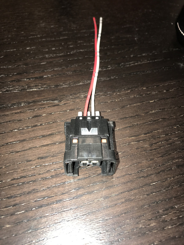

I've got them if you are interested in new ones:
These are a good match to the 2G ones found in 97-98. Mitsu only used these for a couple years before going back to the earlier style. I probably would use the earlier style connector if I was doing a harness, but I've had enough people ask about them that I sourced them.

They are not the same terminals between the 1G and late 2G style connectors, the connectors are not even from the same manufacturer. Whether or not you can use them, I don't know.
Spoolinup was selling another squeeze type connector that was similar to the 2G, but not the same. You could use the 1G terminals in that. And I think it was a cheaper option.
I've seen the downsides of using the wrong terminal in a connector. Improper terminal retention, poor contact with the mating connector, etc. I would be wary of doing that, but I am sure Spoolinup has done some real world testing on this before saying it is OK.
Before doing that, I'd consider using the 1G connectors, and making a quick release connector somewhere else inline.
Edit: I think the pic that Flying Eagle posted, shows the Spoolinup type of quick release injector connector. It is slightly different than the 2G.

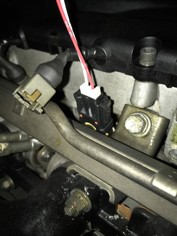

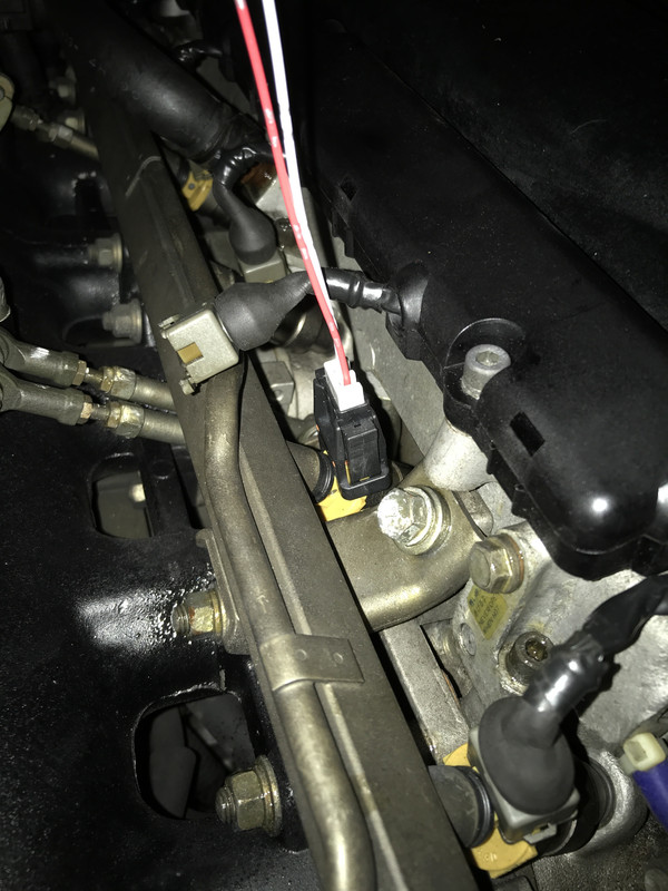

I just found some in my stash. I thought I had bought some new ones with pigtails years ago but couldn't remember. Perfect fit for a gt-r.

What year GT-R? Must be an older one, because that type of injector connector with the rubber boot extending off the back is a really old design.
