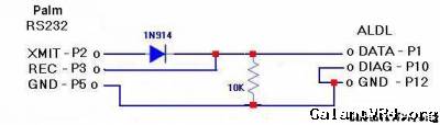

Awesome, Got a palm pilot, now I just need the cable /ubbthreads/images/graemlins/smile.gif
MuffinMan7580
Aug 6, 2011
142
Fort Bragg, NC

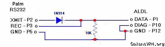

Or you can just build your own cable.
1N914 is a diode. They kind of act as a check valve, so that line you see on the diagram refers to a line on the diode. And then there is a resister (10k Ohm). You use a DB9 computer connector. The ALDL side is the OBD1 connector under your dash next to your fuse panel next to your left foot. You can buy everything at a Radio Shack.
