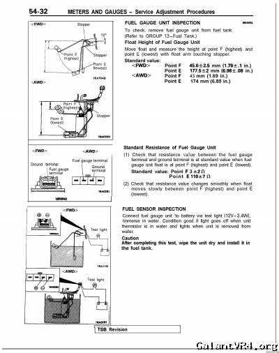

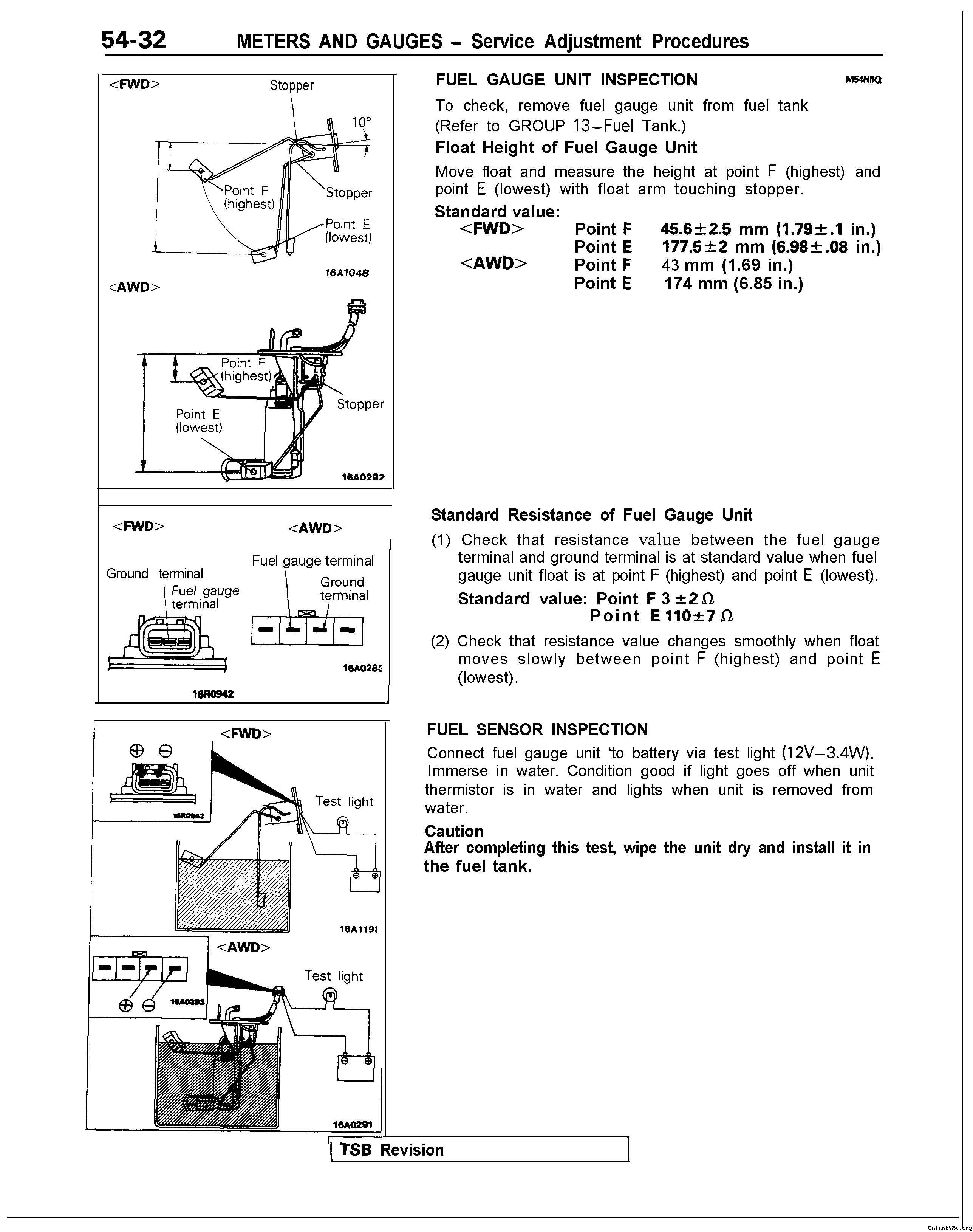

Here's how to check the gauge sender. Easy to just pull the connector and do the resistances At nearly empty and full, no need to lift the unit out the tank. If the resistances are out of tol (at the top) then maybe break into the tank and look at float heights.
This should not be difficult to find there are stickies to service manuals all over here. This is the US manual available on lilevos site.

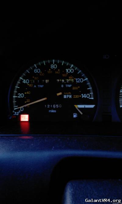

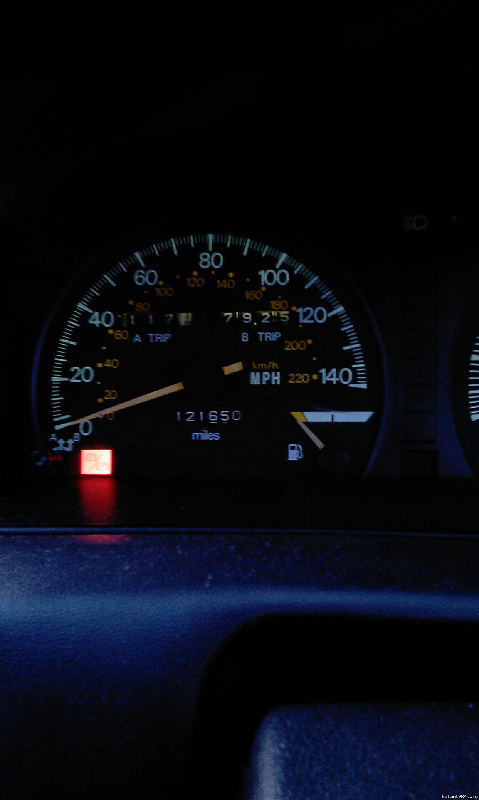

Here is my gauge this morning in the carpark at work. No warning light showing (jdm gauges use the same head and sender but no yellow band) Light came on on the way home so i'll snap a pic and post that tomorrow so you can see where the needle is.
The warning light is off a seperate sensor hanging down off the sender unit. It is not related to arm mowement at all.
