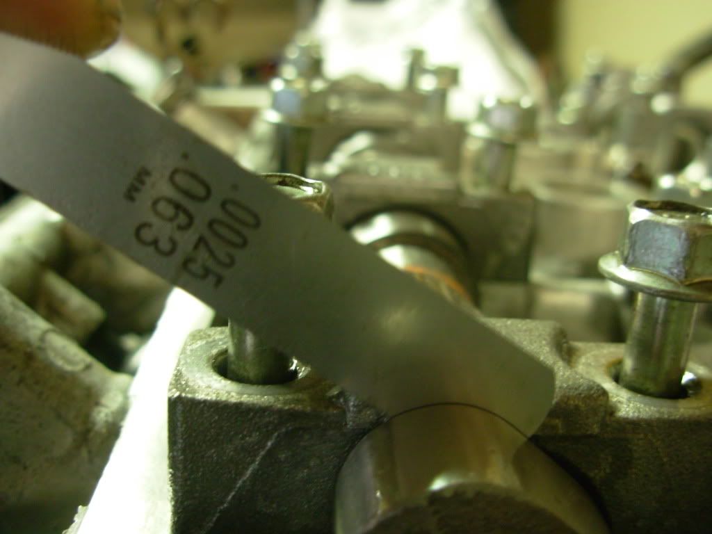

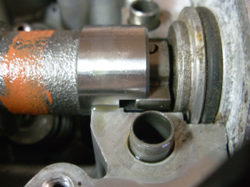

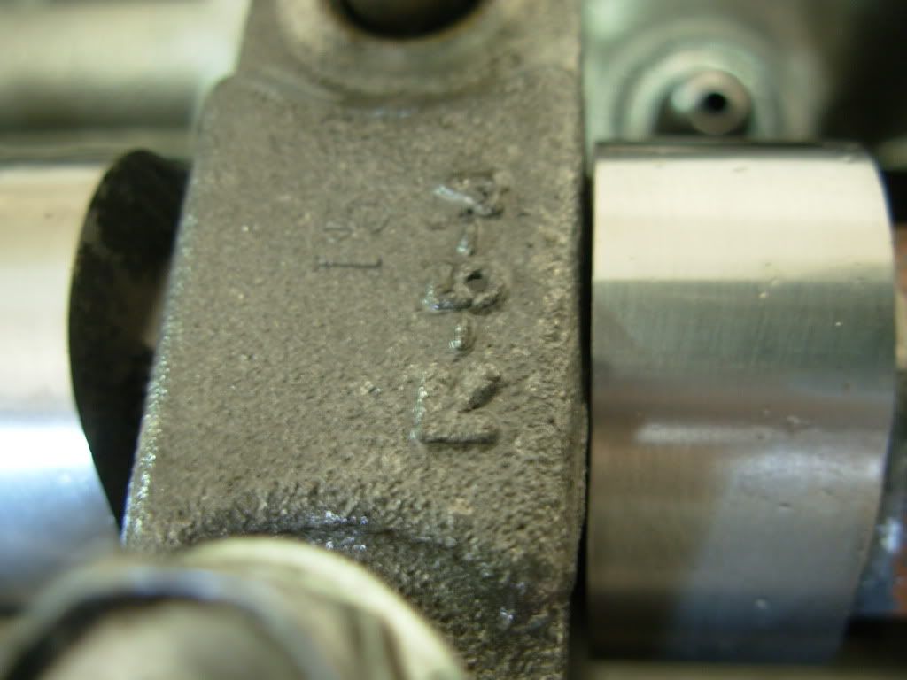

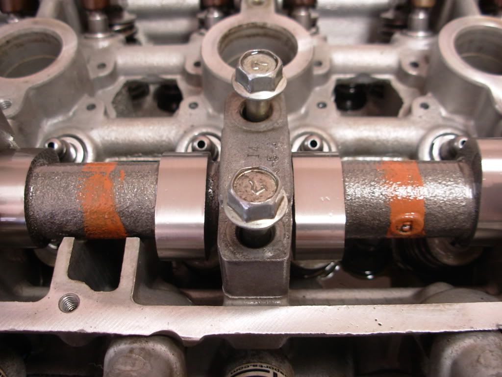

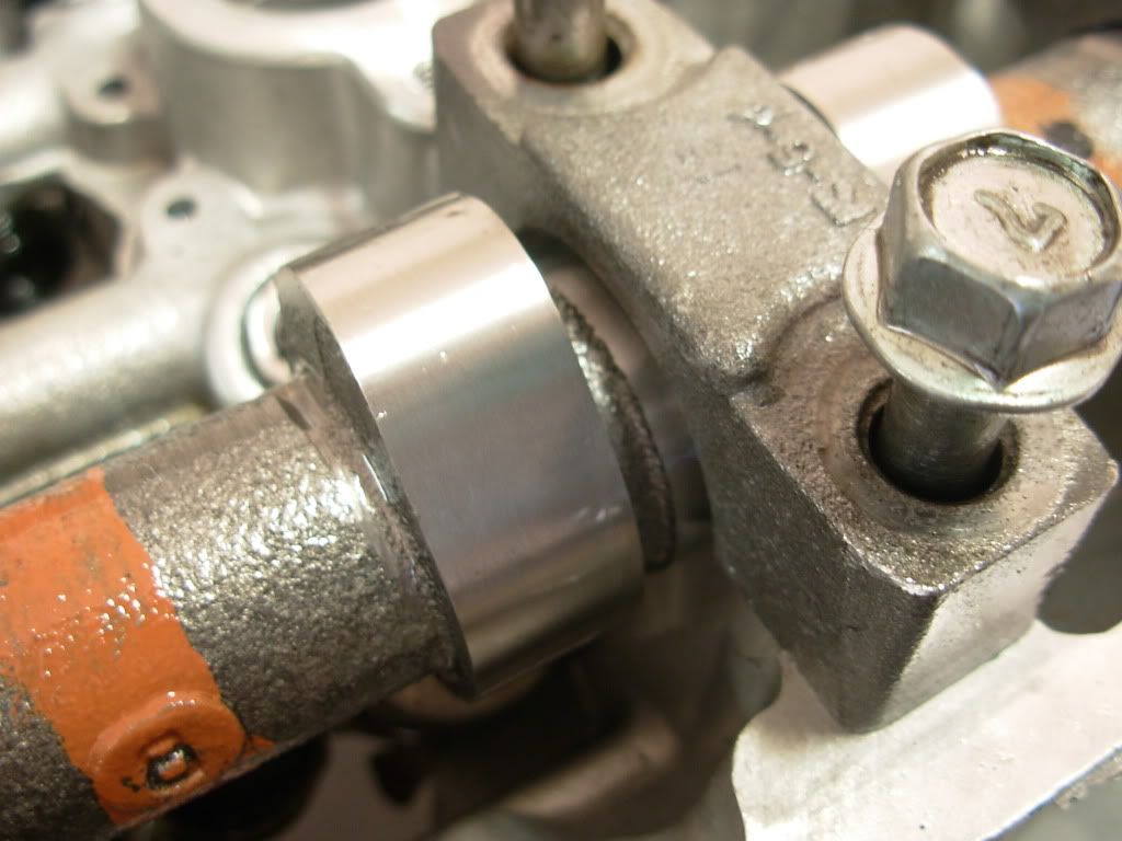

I'm really not trying to sh*t on these cams as I actually ordered a set of S1's for my last build. I found that the lobe sets (Lobe pairs and bearing) offset more and more as the cam goes from the gear side to the CAS side. By the time you are at the last cam cap the bearing area is barely in the cap on the head and the lobe is almost hitting the cap. I had < .0025 clearance. I was really excited about these cams and when I called them they just told me they use the same cores as BC and someone else and kind of shrugged me off. They did let me try another set and then gave me a refund though so the customer service was excellent. I just ended up going with used HK$ 272 combo and am happy with it on my 16G.
Pics.
Too short!
