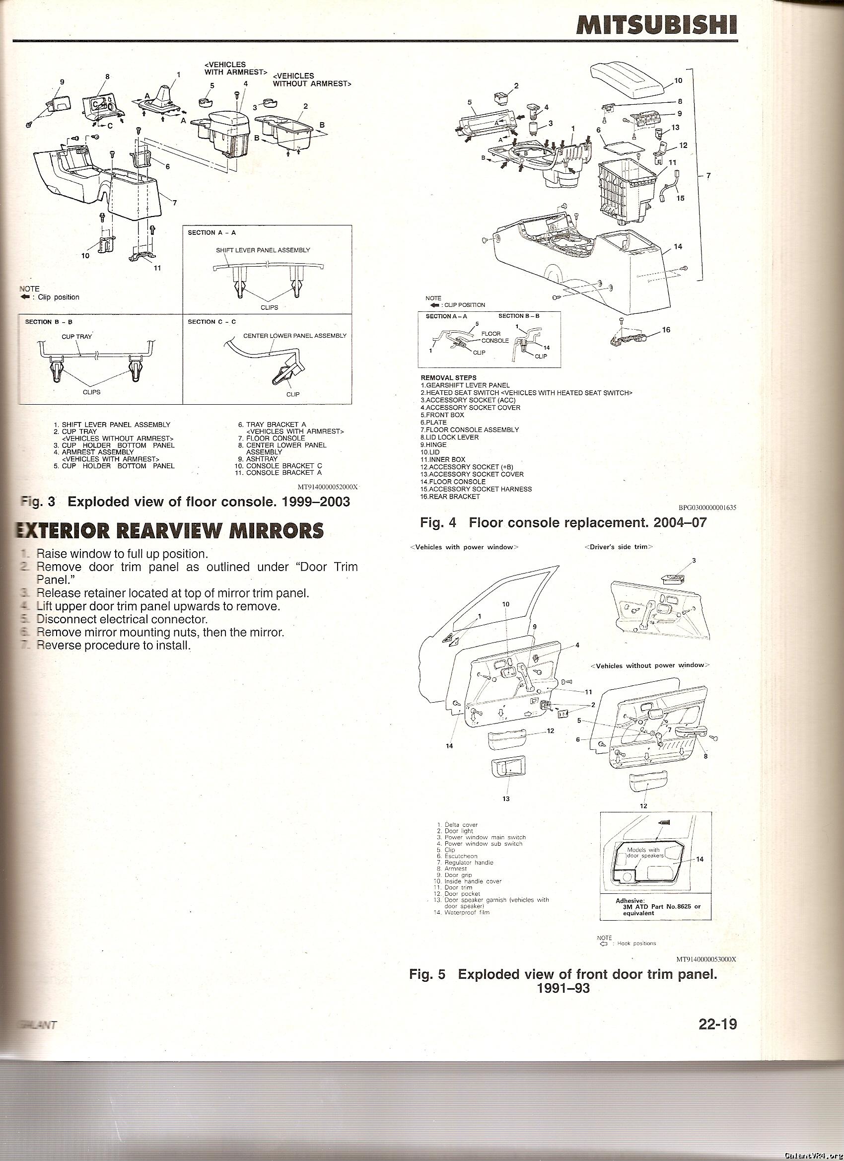

Can anyone tell me how to remove the speakers in the front doors? Mine a re blown and I cant figure out how to get the speaker cover off. I tend to break things when I just pry. Is it just the little grill that comes off? If so how do you get it off without bending it or breaking it. Thanks

Yeah I just did this a few days ago. Door panels gotta come off. bunch of phillips heads then pull up on the panel.

EDIT: Oh, I forgot... If you haven't taken the door panel off before be sure you remove all the screws, then pull UP, not out.

Be very careful pulling UP on the door card. The clips that hold the bottom of the card tight to the door are very brittle and will rip the cardboard really easily.
DO NOT pull the door card out. Just up.

Or considering that mine, as I am sure many others, have already broken, just get some black self tapping tek screws and fasten the bottom of the door down that way. Now instead of trying to wrangle it back on with those silly rear panel mounts you remove them and screw it back on the bottom with two screws.
