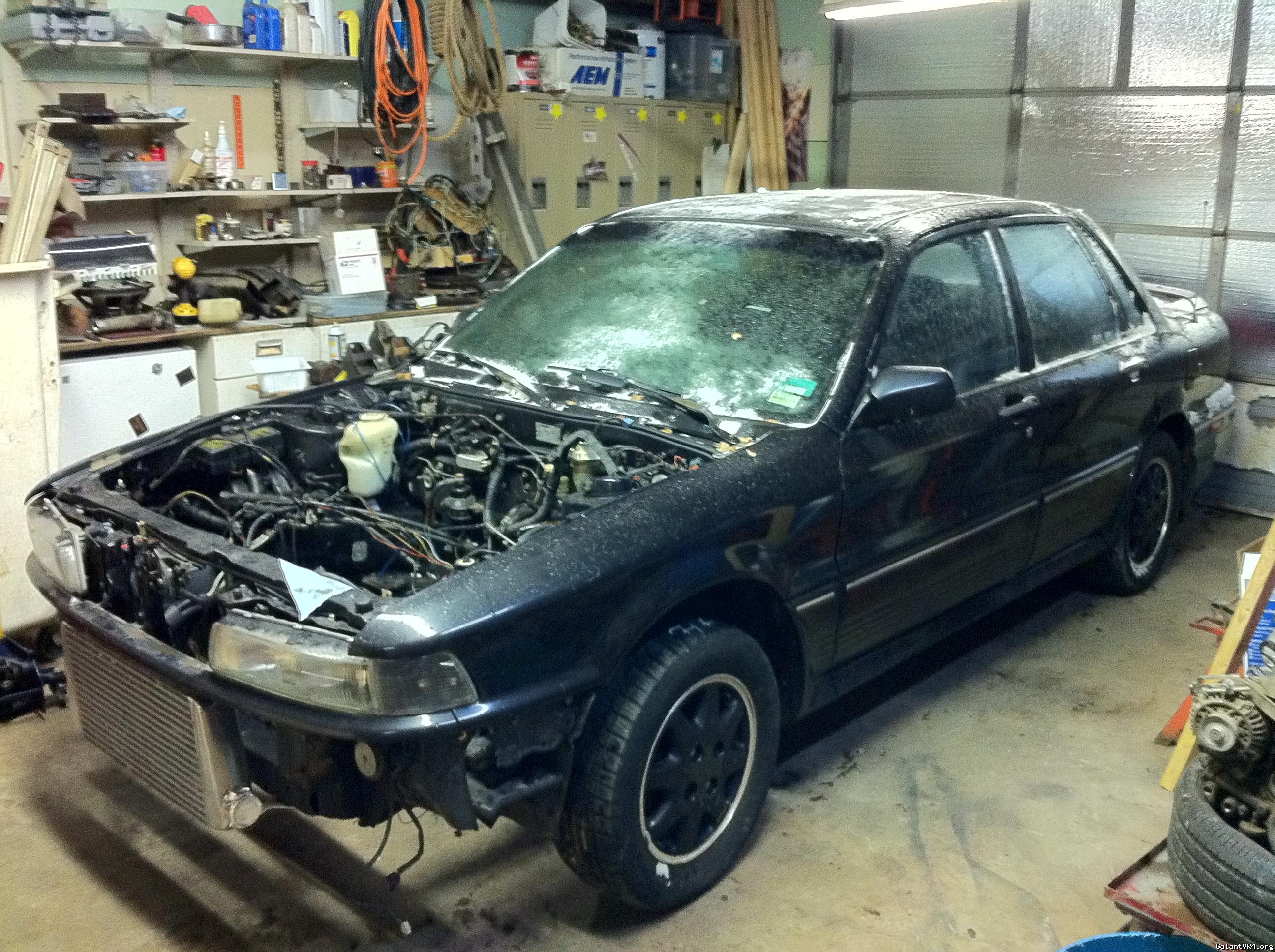

Heading to knob noster, MO around 3pm tomorrow to pick up the transplantee for my galant. If all goes well, I will have a running car again within two weeks. I'm pretty excited. Donor is a 90 tsi/fwd, that comes with a spare engine, both are supposed to be running condition. /ubbthreads/images/graemlins/smile.gif I'll post some pix when I get it.

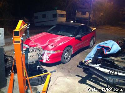

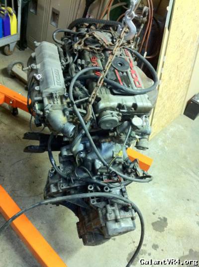

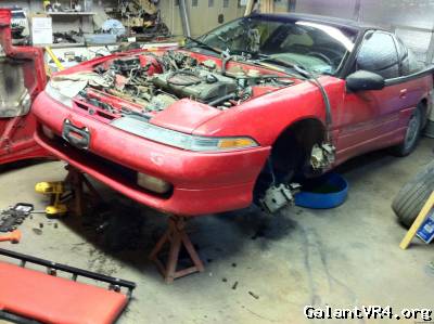

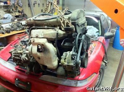

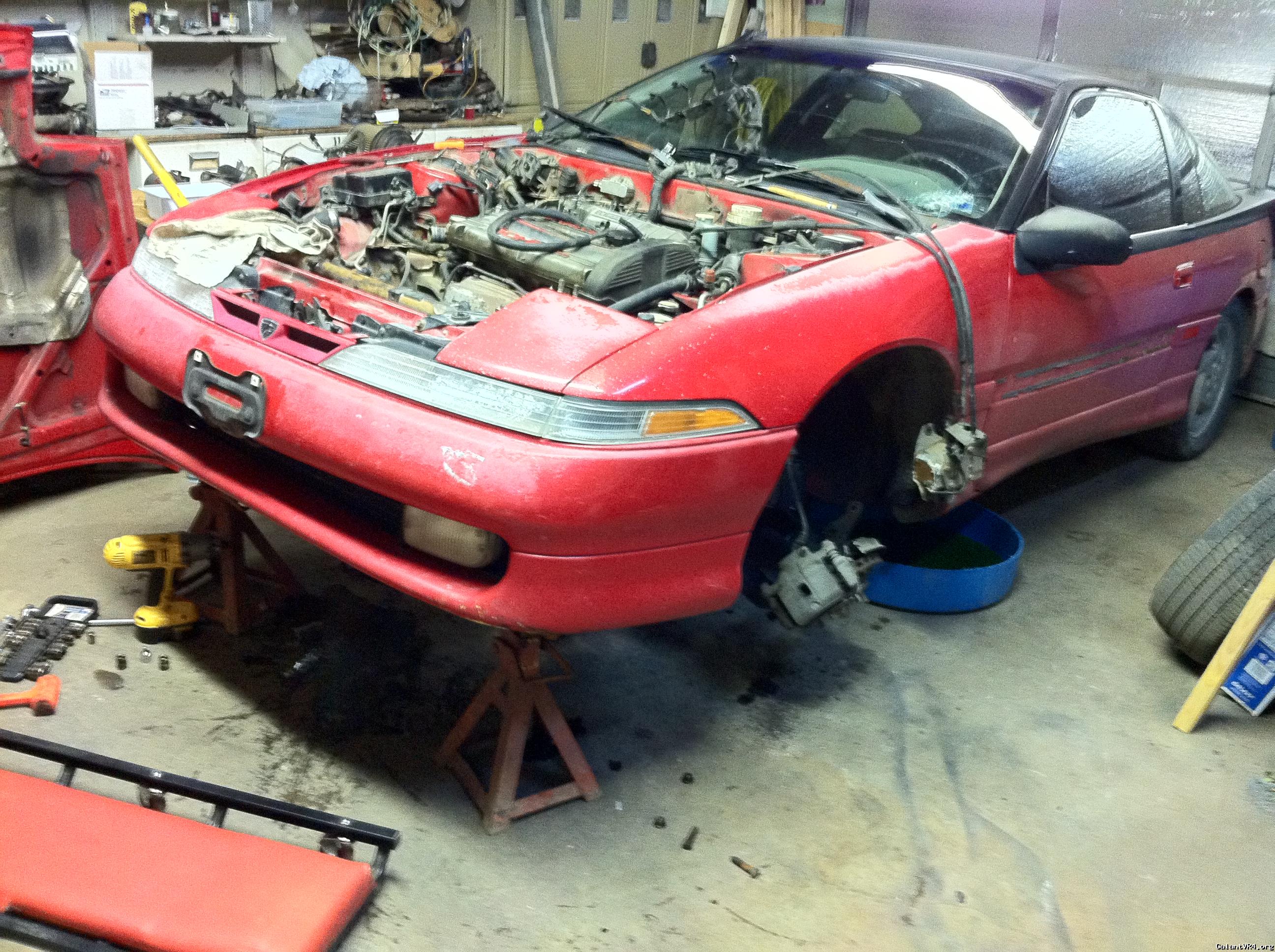

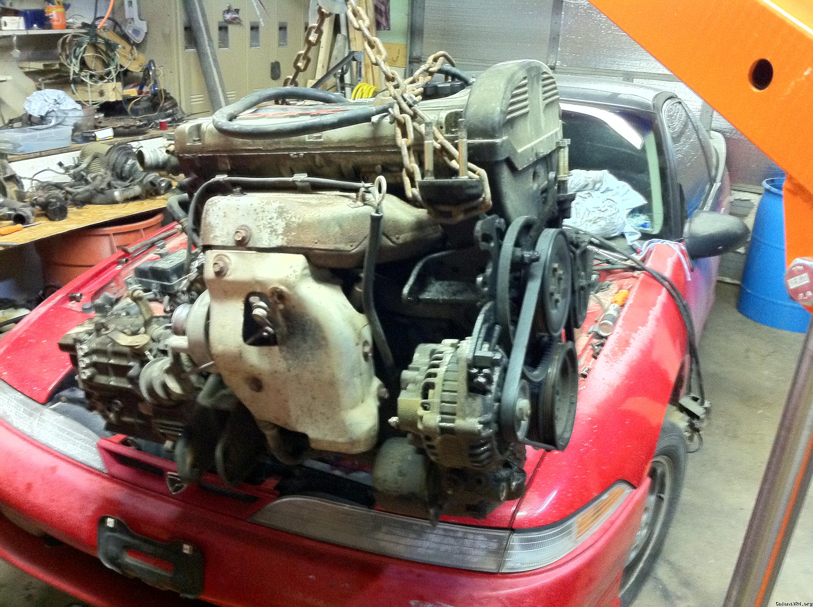

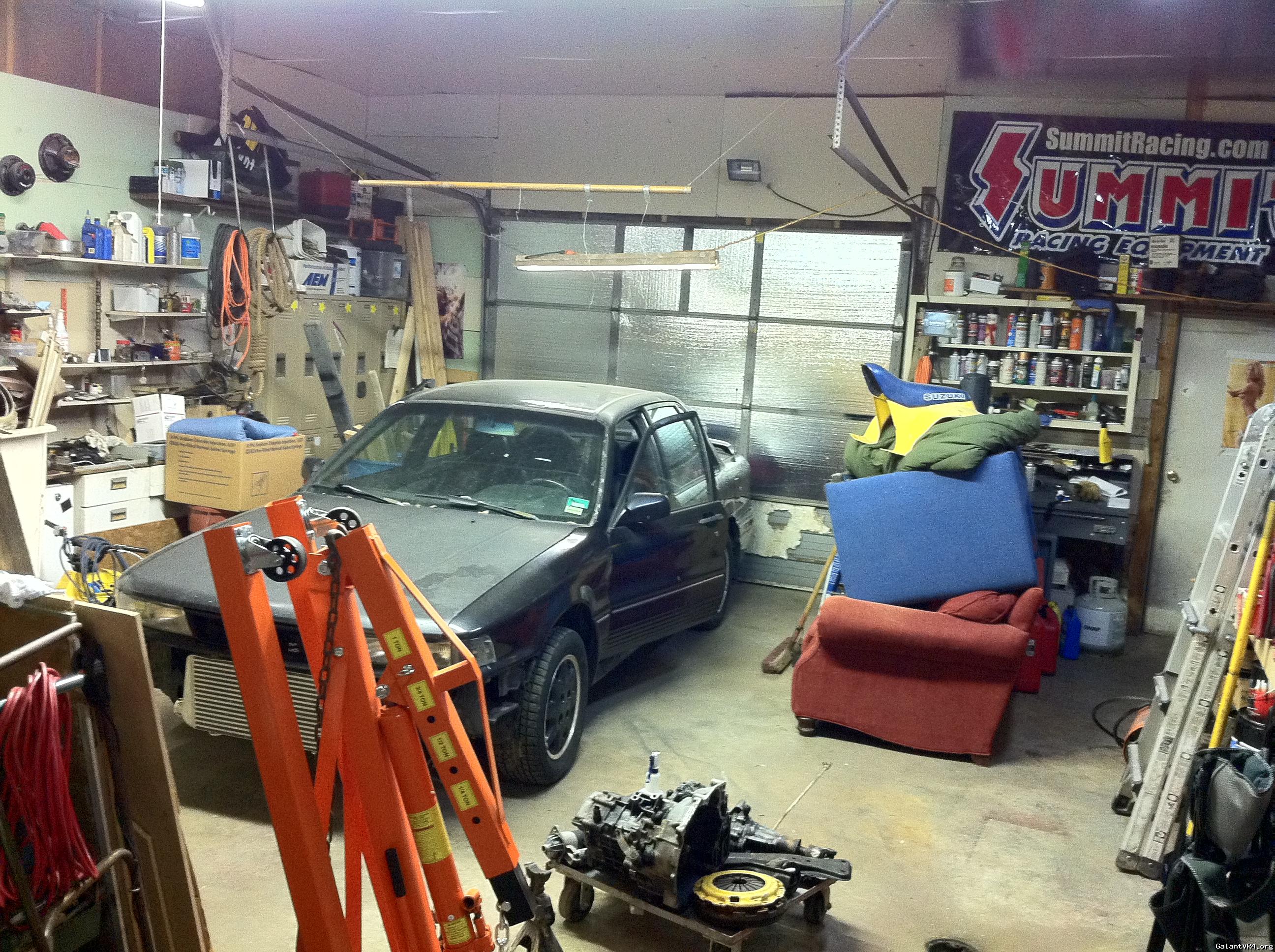

Home. 6hrs and $750 later, I have these:
Car runs great, burns some oil though. Spare engine looks good. Tranny is either shot or has the wrong cables, won't find first or second. Pulls hard though, and holds idle perfect. Now time to start the transplant. /ubbthreads/images/graemlins/devil.gif
Not bad for $750, if you can't get 1st or 2nd it's a different year tranny. I had a tranny like that for one of my older Talons and had to drill a hole in the shift lever with a different rod for everything to line up.

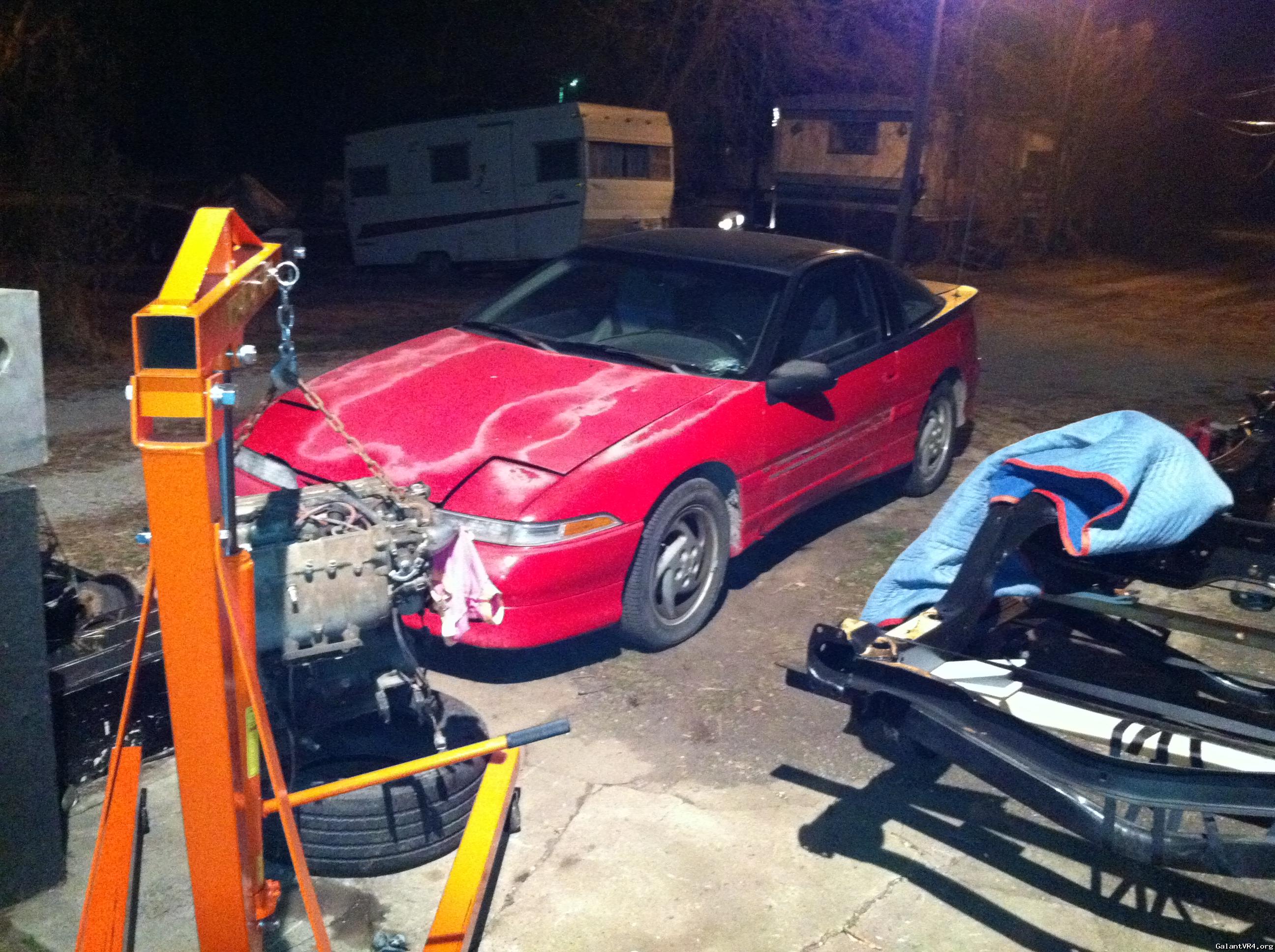

Well, shifting problem is somewhat solved. First still won't go in, just grinds. Car still has a 90 tranny/brackets and cables, but had a 91+shifter with base. Put a 90 shifter back in, now all gears are good but first. They probably ruined it trying to figure out why it wouldn't work. Oh well, that's an easy rebuild.

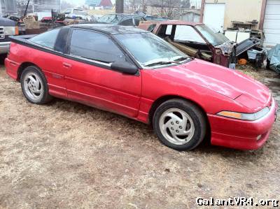

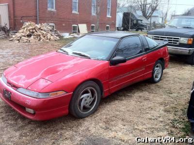

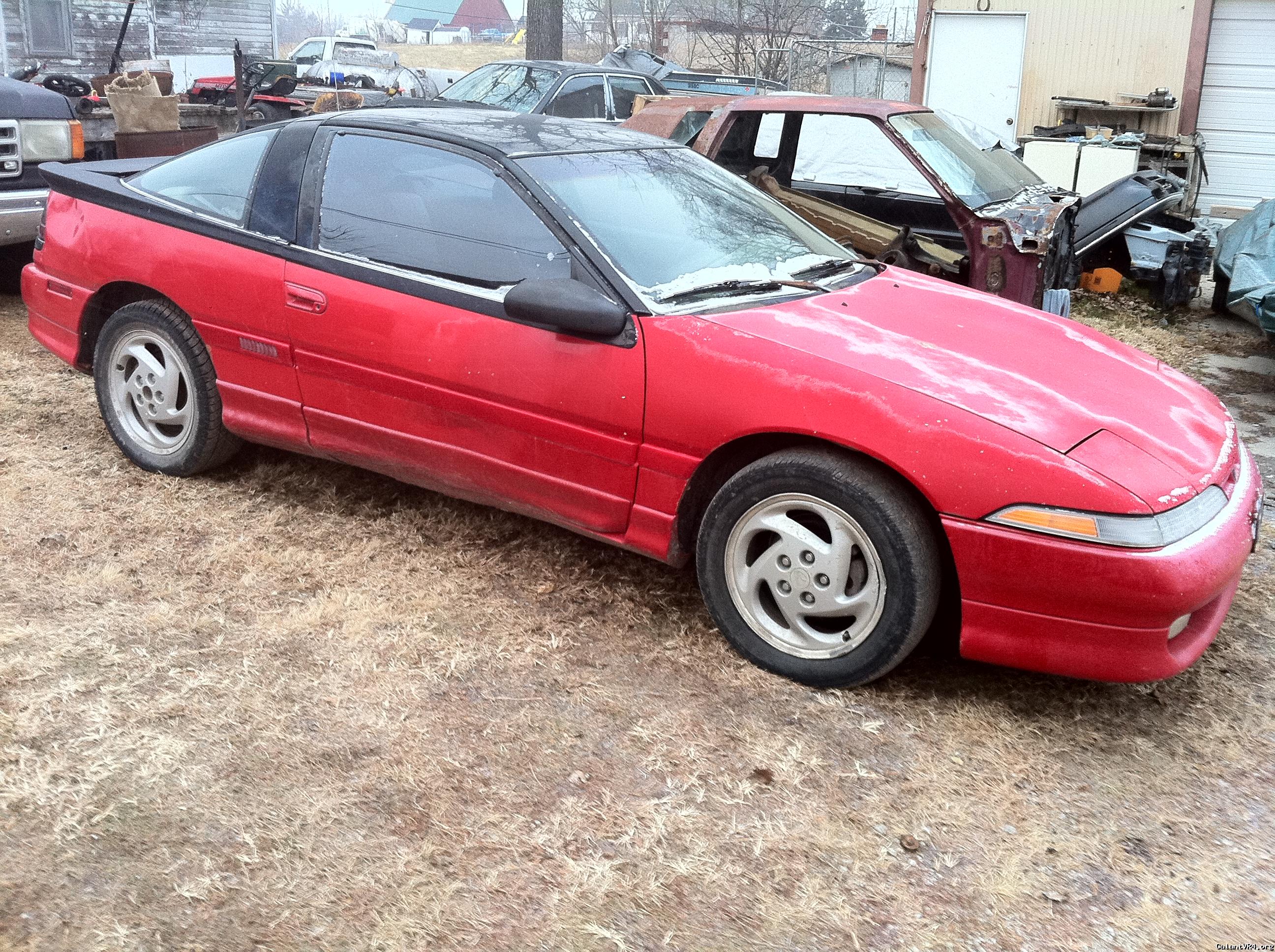

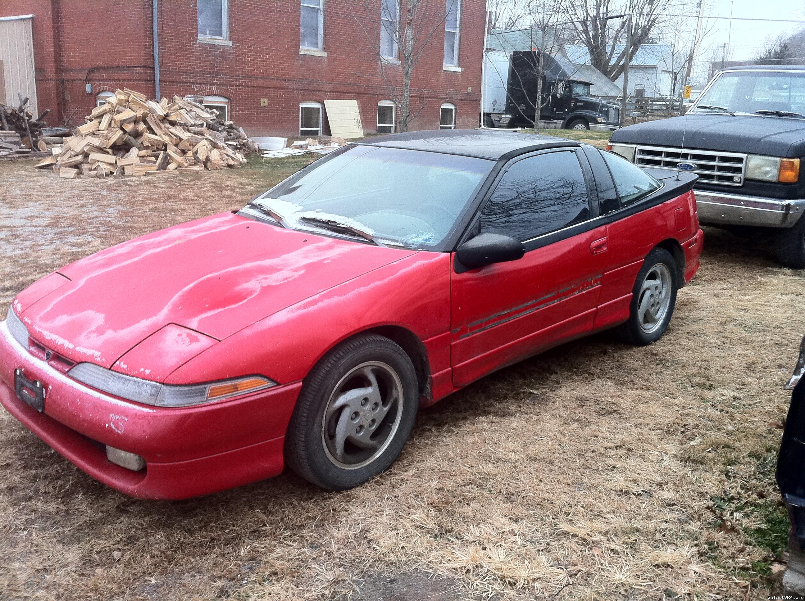

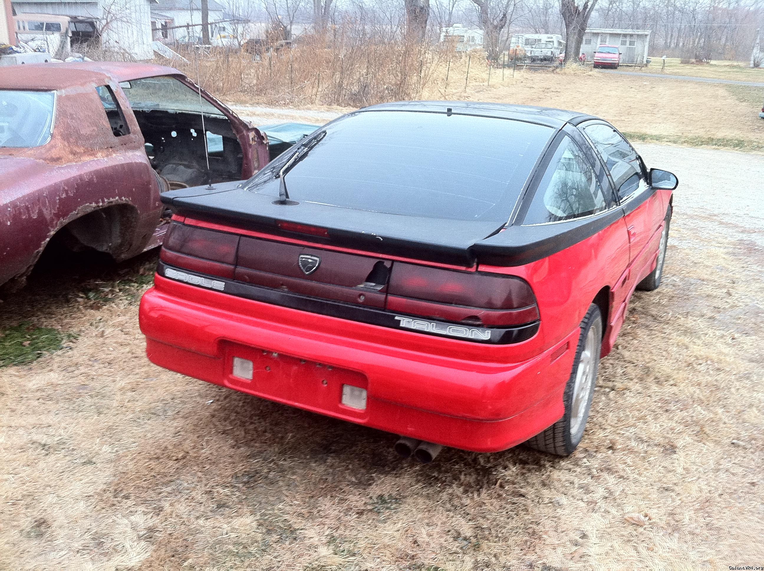

Any ideas on what the talon is worth? It's a 90/fwd/turbo, no engine or trans, interior is pretty rough, see pix for condition of body. Seems like a pretty solid car. I want to get rid of it now that I got what I want, but don't know what they go for. Last resort will be scrapyard, but I'm gonna hit craigslist first. /ubbthreads/images/graemlins/dunno.gif
