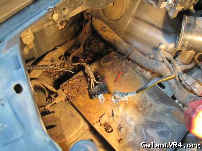

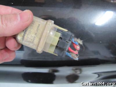

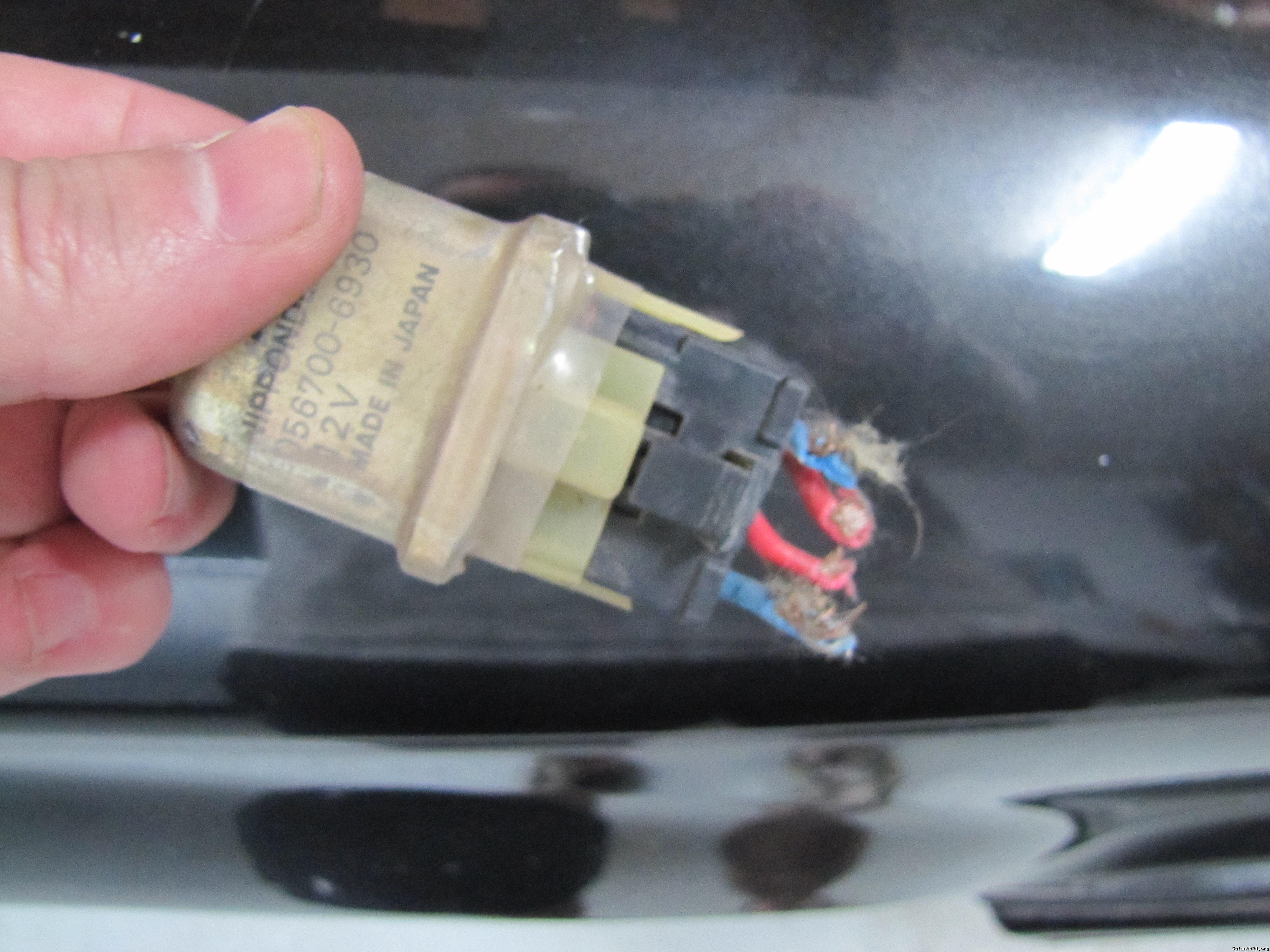

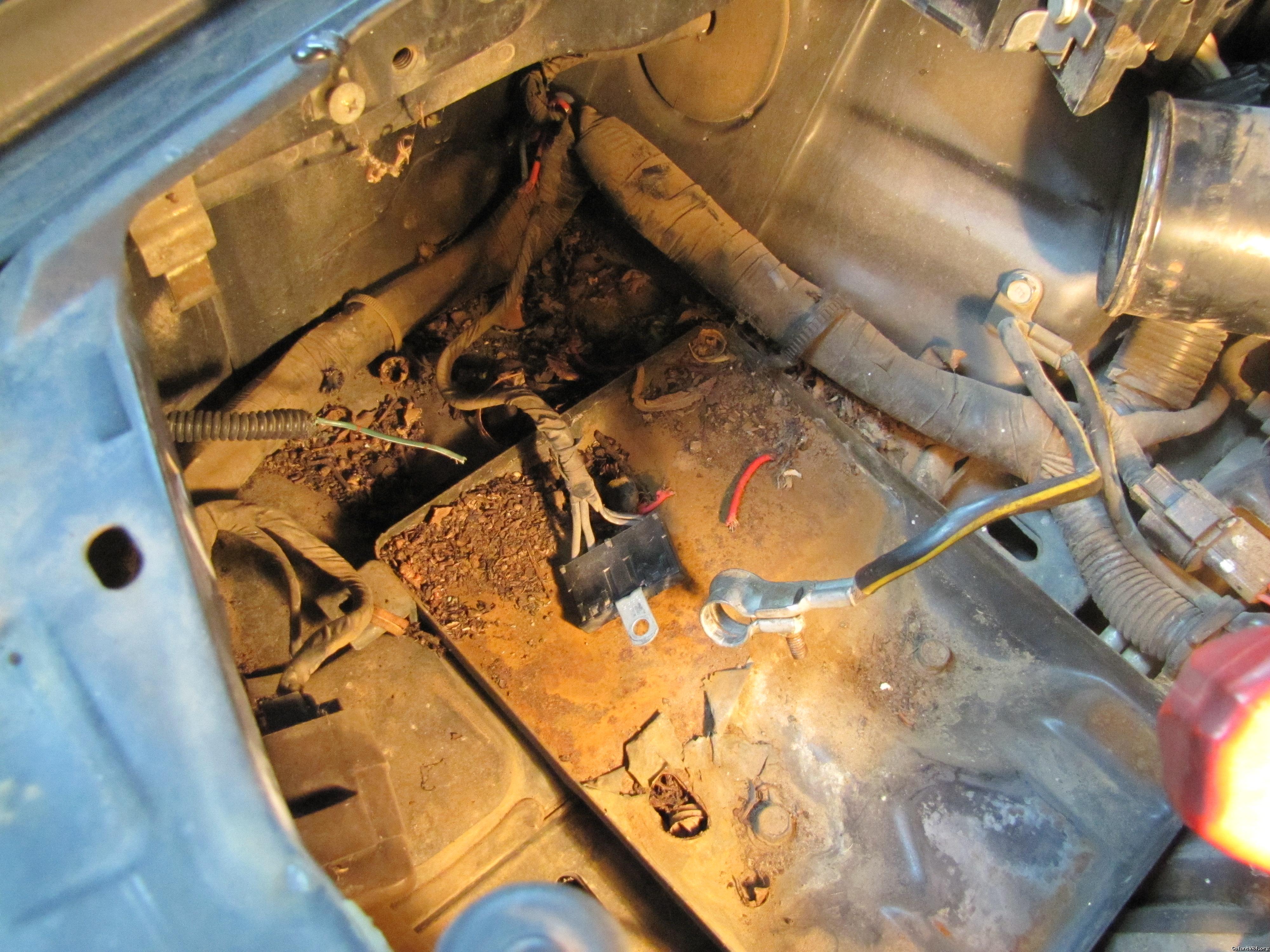

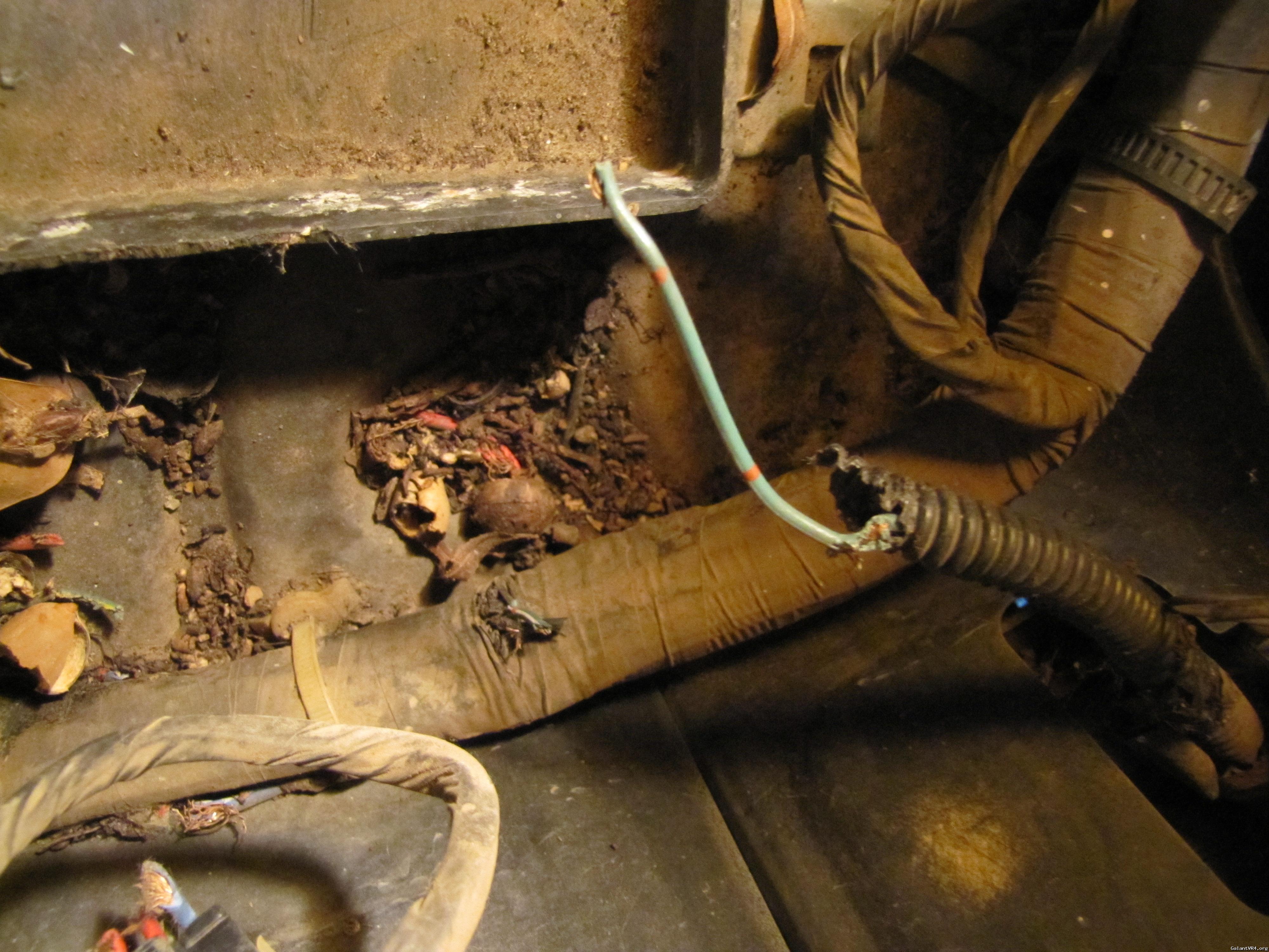

After reading the manual we found the relay we had been looking for. It appears the darn varmints had decided to eat the wiring to the relay, turn signal and ground block. Looks like I will be making a trip to pull part for some leads, as it nearly ate the wire up to the plug.

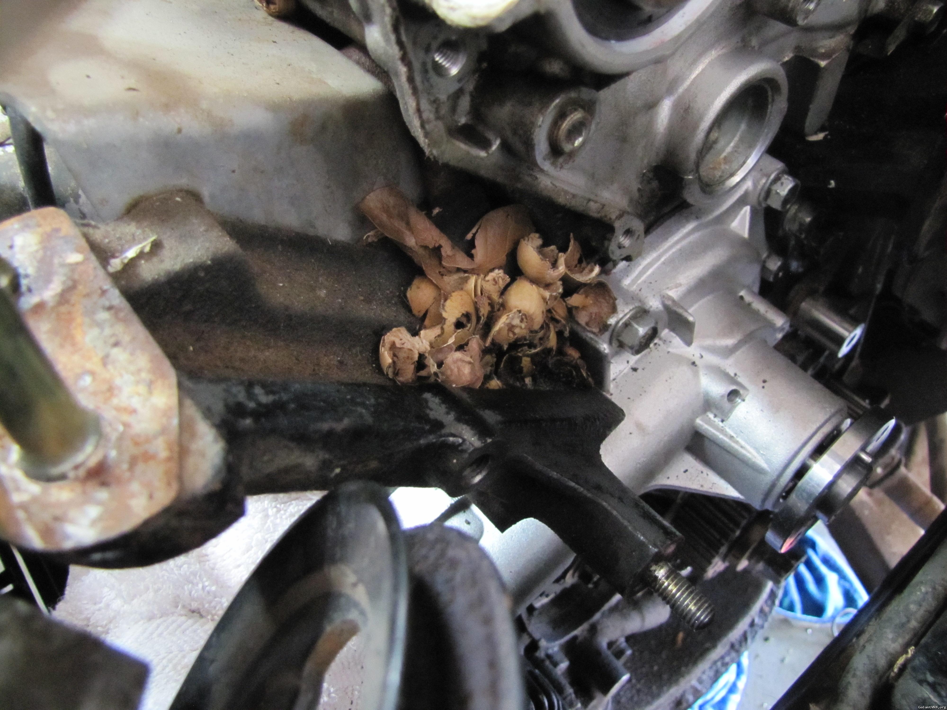

I found this all over under the hood. If I don't get all this stuff out, my car is going to either catch fire or it is going to smell like roasted nuts every where I drive.
There would be some dying going on if I caught the darn varmints that created a mess like this in my car...

On my old Talon, I found out that mice really like the insulation on O2 sensor wiring and that mouse urine stains raw aluminum.
