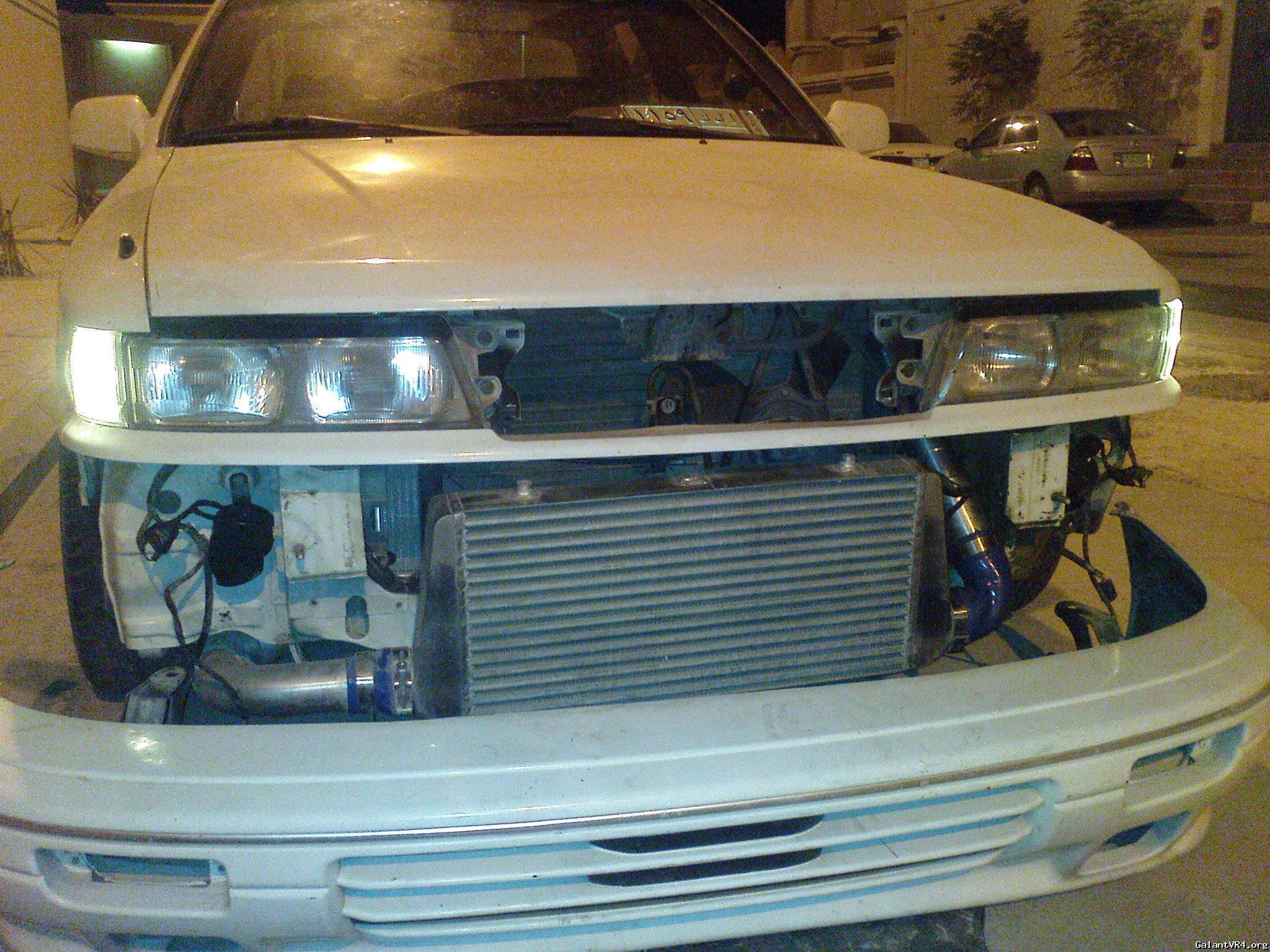

Nabeel
Jul 14, 2006
264
K.S.A
Had to cut only the lower side of the bracket. Give space to the intercooler & save some weight.

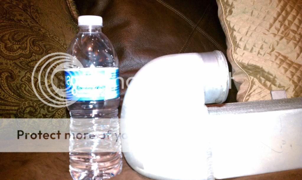

I just woke up and tried to find some measuring tape but no luck, here's the horrible reference point on the intercooler.
