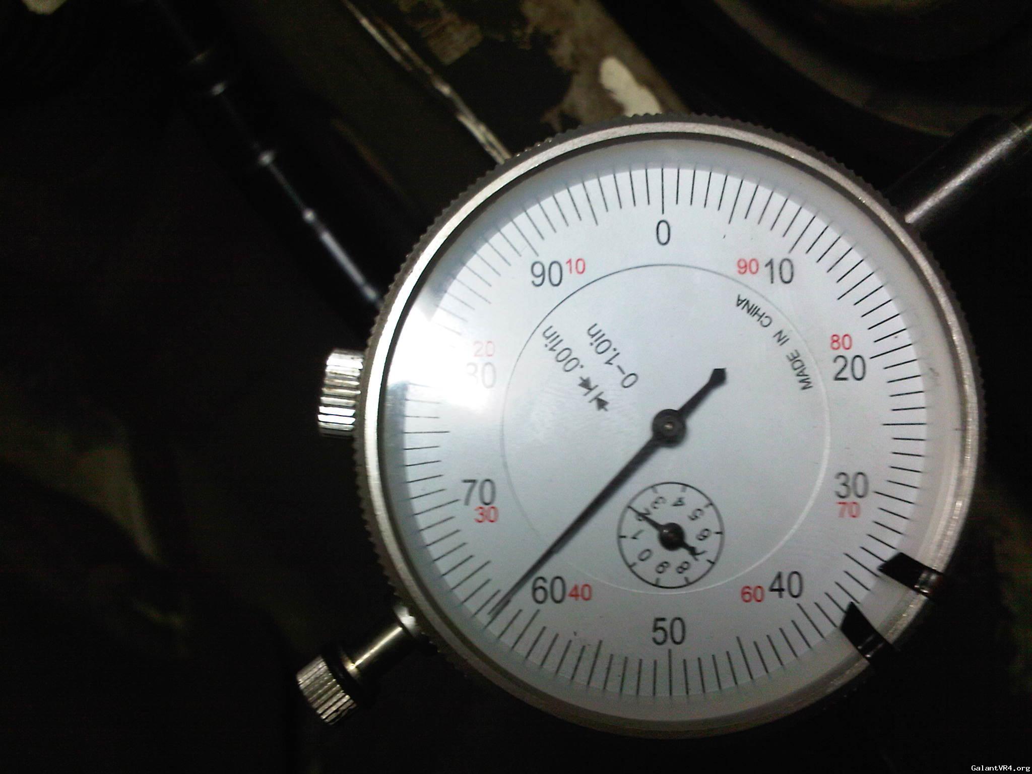

IMO just take out the driver side fender splash shield so you can get clear access to the crank pulley. Push the pulley with your foot firmly, don't push it off the jack or whatever you have it on. You will be pushing the crank towards the flywheel side of the engine. Put your dial caliper on and zero it. Then press the clutch. This will push the crank balk the other way. Now you can see if you are outta spec. This is a bit crude, but if it is as bad as you say, this should confirm the obvious. Hell, if it is bad enough, you can actually see the crank move. If you can see it move when you press the clutch (someone else pressing) it is *really* dead.

Im not really trying to figure out how to test for crankwalk. I pretty confident it crankwalked, but I have a dial indicator so ill check it out after work and get a reading. My question is more along the lines of what I would need to do in order to fix this while the motor is out of the car.
Ill test for CW when I get home with a dial indicator.
Here is My Crankwalk status. pushed the crank all the way to the passengers side. Set the dial indicator to "0". Pushed the clutch in with the pedal, and this is what I got..... /ubbthreads/images/graemlins/frown.gif..... Pushed it back to the passengers side and it ruturned about "5" past "0" so add 5 to that number and there is my crank thrust measured very crudely.

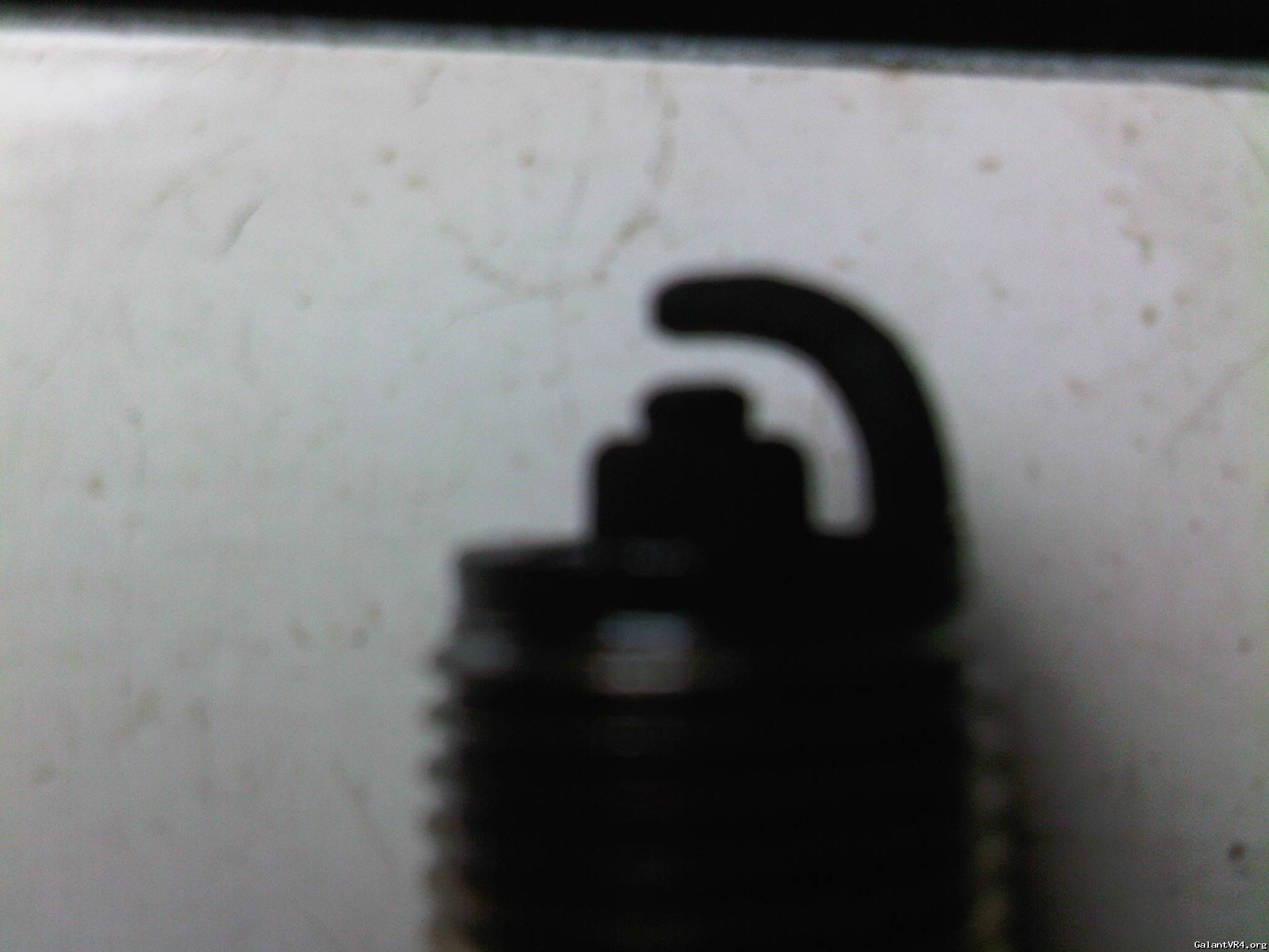

Here is the spark plug from cylinder 2
