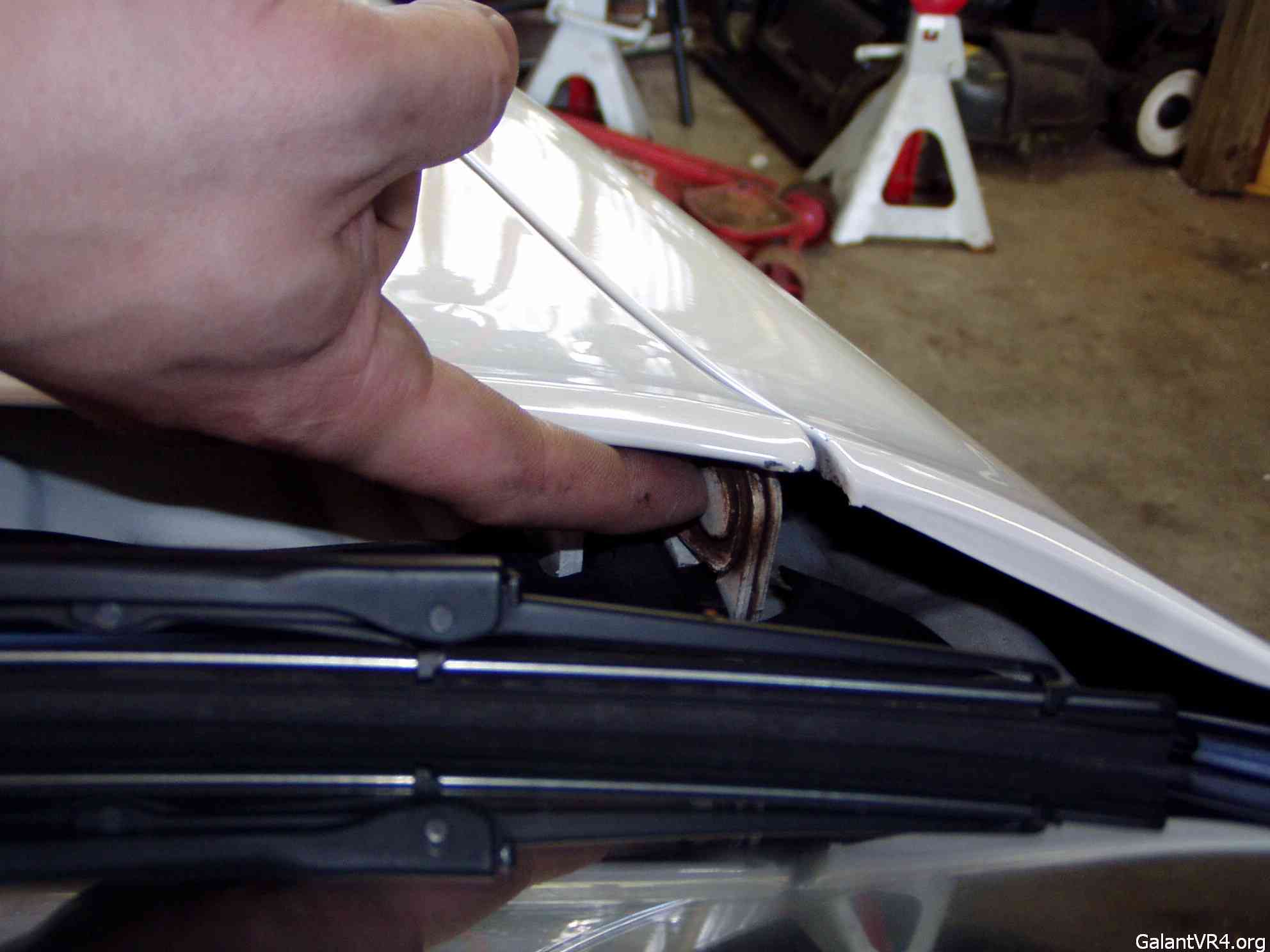

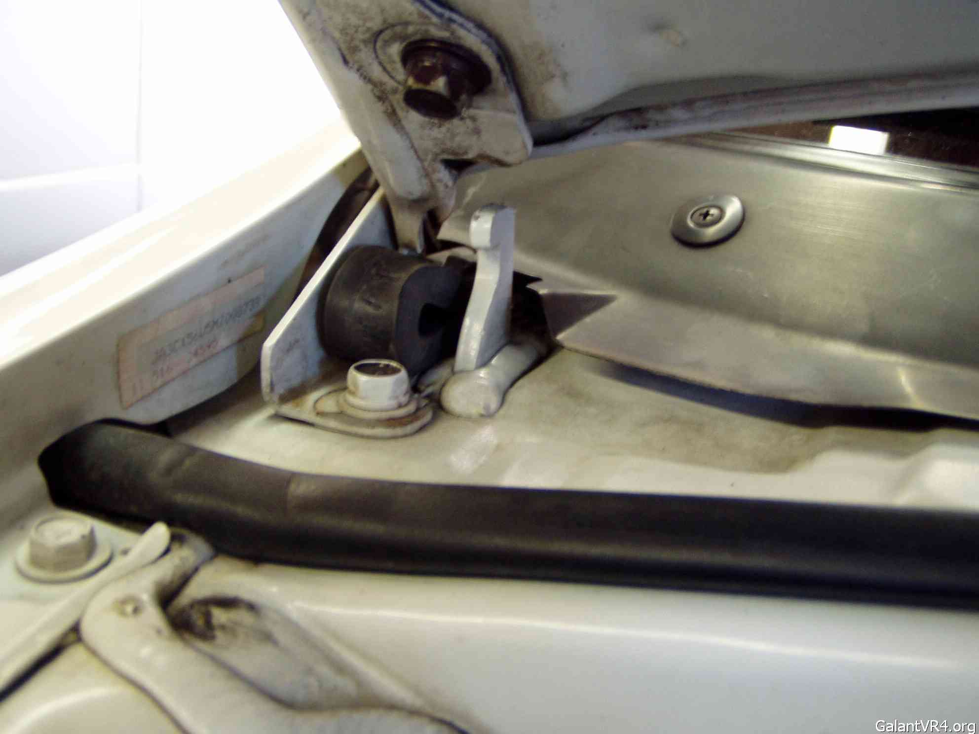

I found that the hood hinge on both sides (mostly passenger side) has a little play in it ONLY when the hood is closed.
Here is a pic.
To test to see if it is loose, grab the back of the hood (must be closed) right where my hand is and lift up and down several times. Mine was just loose enough to rattle.

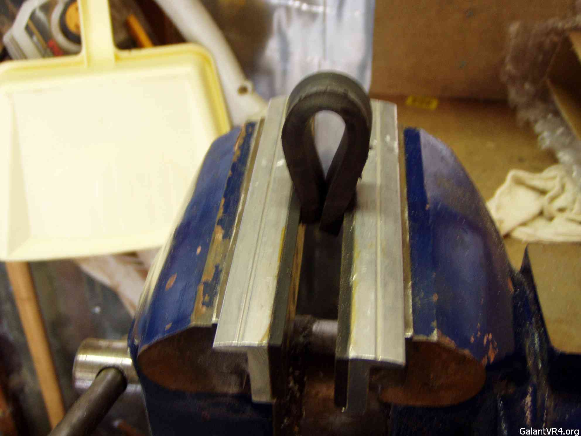

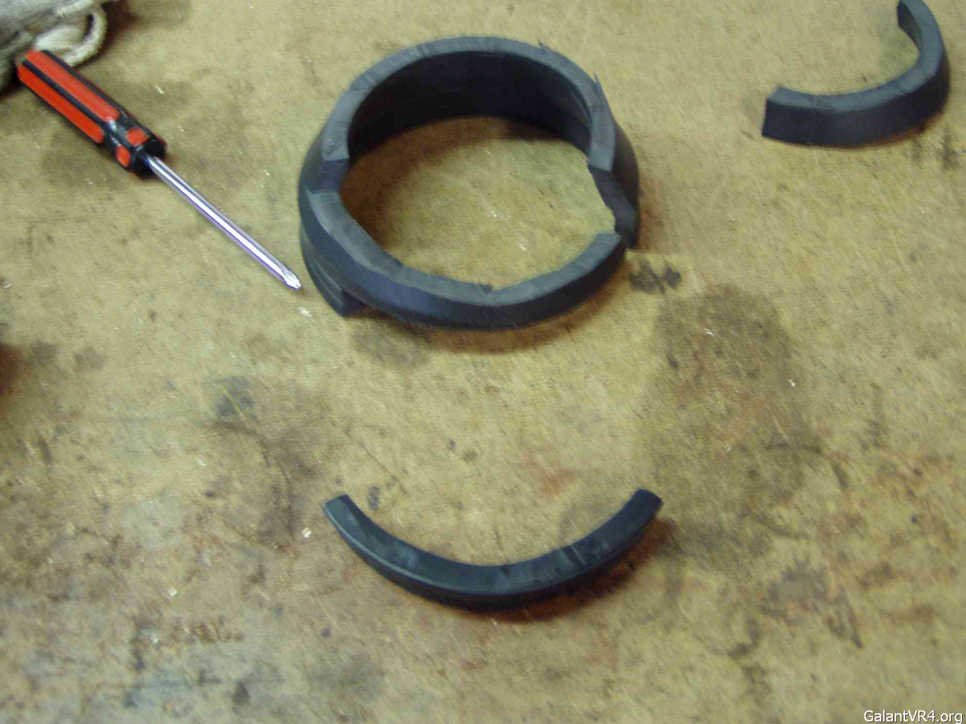

The rubber piece is from a 3" to 4" plumbing adapter I had laying on the shelf. The rubber strip is about 1/2" wide and about 6" long. The rubber is about 3/8" thick.

Here is a pic of how it is folded and stuck into the hinge.

I hope it stays put. It should, but if not, I will use some RTV to make it stay.
This worked perfectly for me. No more rattles.
