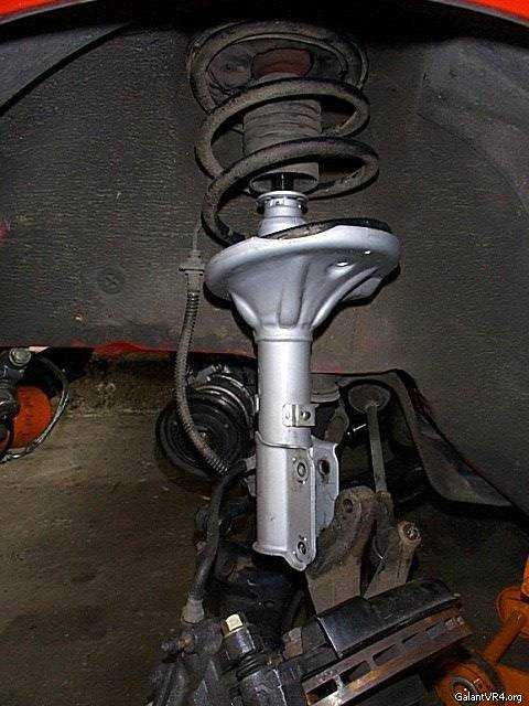

I've hit a problem. The back springs were easy. Front suspension came out OK. Putting the suspension back in the front right was difficult but I did it. With the front left I'm stuck at this point: (this is not my car it's just one off the web)
I cant seem to get the brake and wheel assembly to sit uprite allowing the two bolts that connect it to the suspension line up. I tried using a jack to hold the breaks up in place and this helped on the right side, but when I do it to this side it makes the angle of the break assembly even worse.
Its like the axle or something is not allowing the top of the break assembly move closer the the car?
Or the opposite is happening and something isn't allowing the bottom to move away from the car?
Has anyone got any idea on what may have happened? /ubbthreads/images/graemlins/confused.gif

ive never had that problem before on any of the 1gs ive did fronts on, and there was many! only thing i can say is get it as close as you can with the jack. then wiggle one of the bolts in. then grab a bfh (big f@#*&ng hammer) and hit it in all the way. be careful if it is to hard to hammer in. you don't want to mess up your threads
it looks like you did not index the upper & lower spring perch's. pull the strut Assembly back out & you will see right under the top mount (Bering) on the upper spring perch there is a small hole. you need to be sure this hole is lined up with the one on the strut (lower spring perch) vertically. if it is off the spring will sit wrong & hit the inside of the strut tower.
P.s. it would take a really big effen hammer to get it in the way it is & still be undrivable.
That's not a picture of his car/problem.
Make sure you didn't accidentally pull the axle out of the trans. That would make the angle funny.
**and if you did... put it back in /ubbthreads/images/graemlins/smile.gif
I can see about 3-4 inches of fresh grease on the axle by the rubber boot as if it has come out. /ubbthreads/images/graemlins/confused.gif What do I have to do to put it back in?
inboard cv is called a tripod. you have pulled the tripod out of the cage. rotate the axle till you feel it line back up & then slip it back into the housing. this will happen anytime you drop the spindle that far with the axle still in the hub.
Thats about a good a guess as anyone can make without looking at it. Also make sure your top bolts are still loose just to make it that much easier to piece things back together.
It worked I just had to relese the hand break and turn the axel and it went back in easy as.
