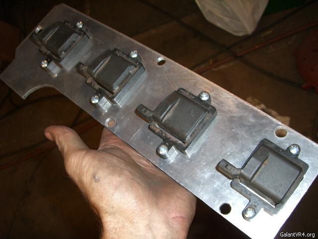

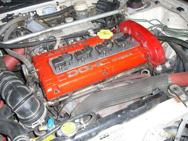

Well thanks to all you who posted anything about building COP setups (especially curtis for the wiring diagram) i have finished mine and it worked without a problem. Heres some pics for you all

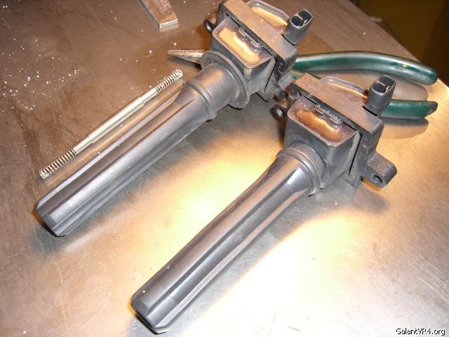

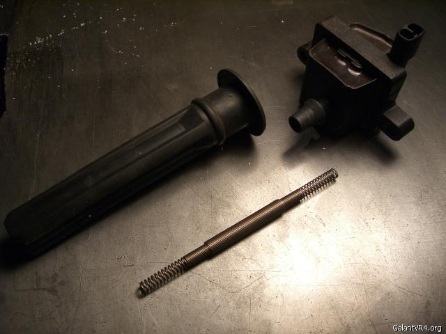

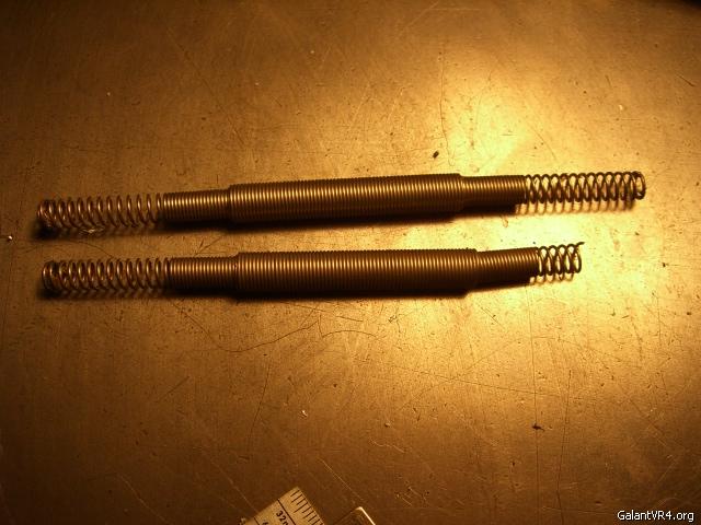

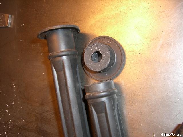

Also i did cut my coils down to fit flush and i know some of you were wondering about that so what i did was pull the coil out of the rubber boot, then take out the spring(mine are the spring style), i had to cut approx 5/8" to make mine sit flush, you will also have to cut the springsi cut some off each end, but most off the top as thats where i took the rubber out.

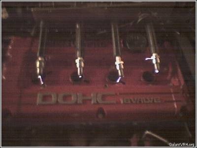

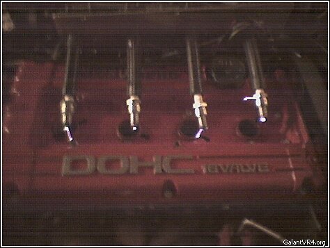

yea .020 should be small enuf, must be spark blowout, or not a strong enuf spark, let me find you a pic i saw of a guy that had intrepid coils
ok this is off dsmtuners i believe
Looks like plenty of strong spark but who knows under those kinds of pressures

It could be that the resistance in the springs in the boots. The springs measure a 6 where the aluminum rods with 2 springs measure less than 2 and the aluminum rod with just one spring measures down less than 1. I've wanted to find some copper rod and machine them so one rod slides into the other with a spring inside the hole. The resistivity of copper is much less than aluminum but aluminum is about 10 times better than steel. This could be the problem that some of you are having because Its not a gap issue because mine are gaped up about .035 or .040. But I'm running the 4 pronged bosch plugs.
May 4, 2003
11,892
Clarksville TN
One more thing for the guys running springs and wanting aluminum rods go to home depot to the metal section rack. A hack saw and a file is all you need but remember you can't just run the rod you have to have a spring because if you cut to fit perfect you could crack a plug when the aluminum rod expands.
yea thanks for the info curtis, thats good to know the resistances, ill think about converting to the rod in the near future, maybe ill even fire up the lathe and make some real fancy ones
