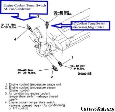

Here is a pic of the sensors in the t-stat housing:
Which one of these is missing a connector?
First guess is the ECU temp sensor ( #2, 2 wires ), if it's not connected or bad it will cause starting problems plus run in open loop all the time.

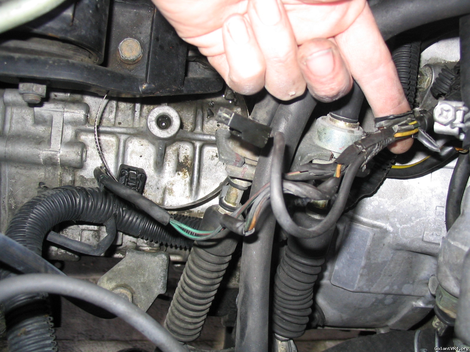

Those wires run in the harness that runs along the top of the tranny to the underside of the t-stat housing.
A little work, and you're good to go. /ubbthreads/images/graemlins/smile.gif
I think I still have a few of the pigtails left.
Pm me a shipping address, and I'll get some in the mail on monday.

Sorry I was wrong. I told you the wrong sensor it's number one on your picture. Also I was wrong in the color wire, it's yellow with a green strip.
ktmrider
Sep 10, 2007
3,128
Tempe, AZ
^^ Ok that's the temp gauge in your instrument cluster.
One wire with a regular ole spade connector will hook right back up.
Commom for folks to remove when running an aftermarket temp gauge.
