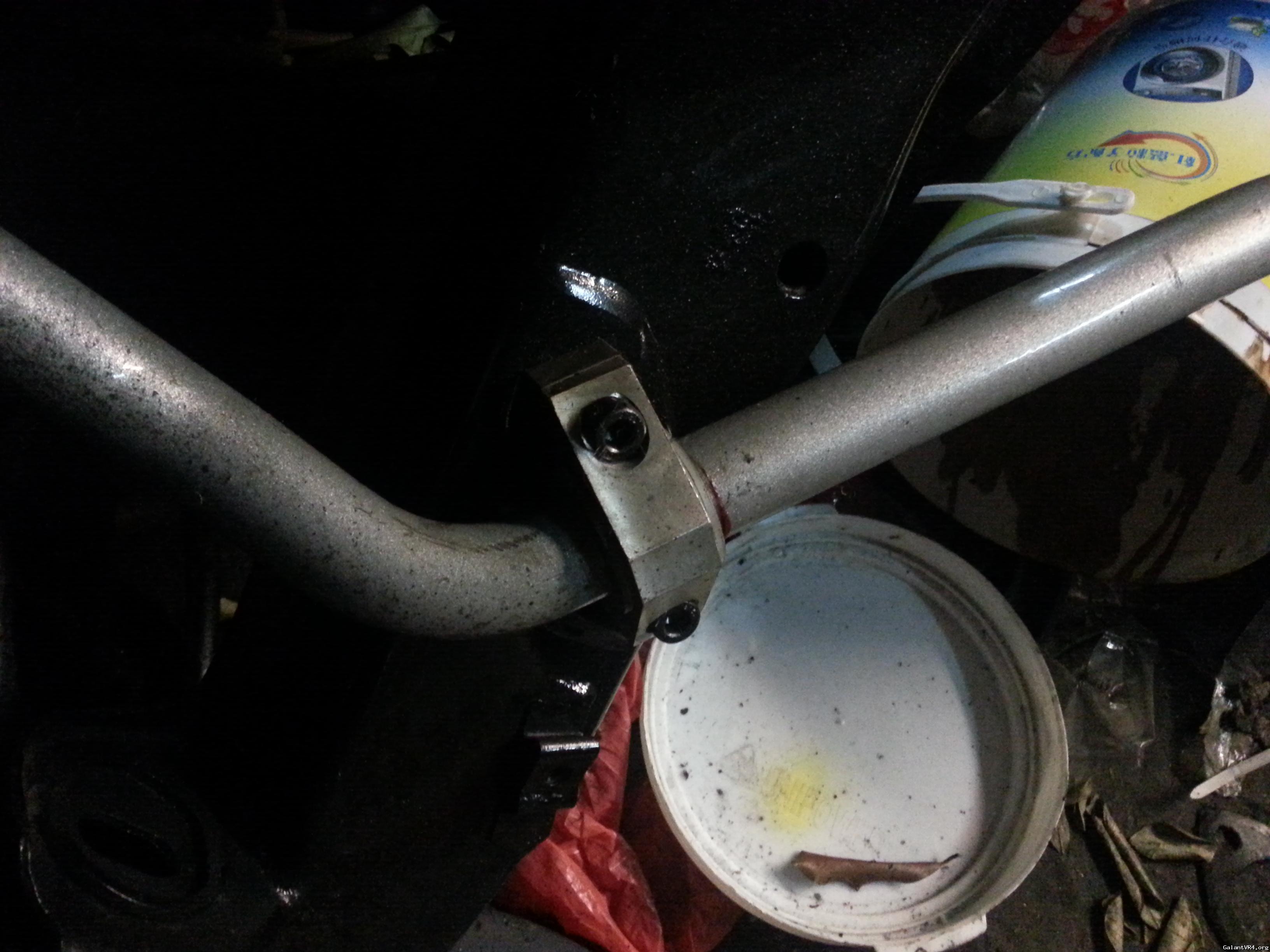

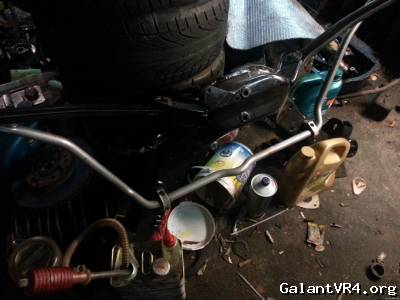

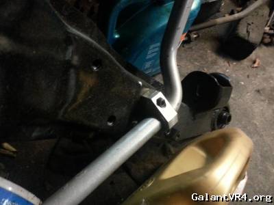

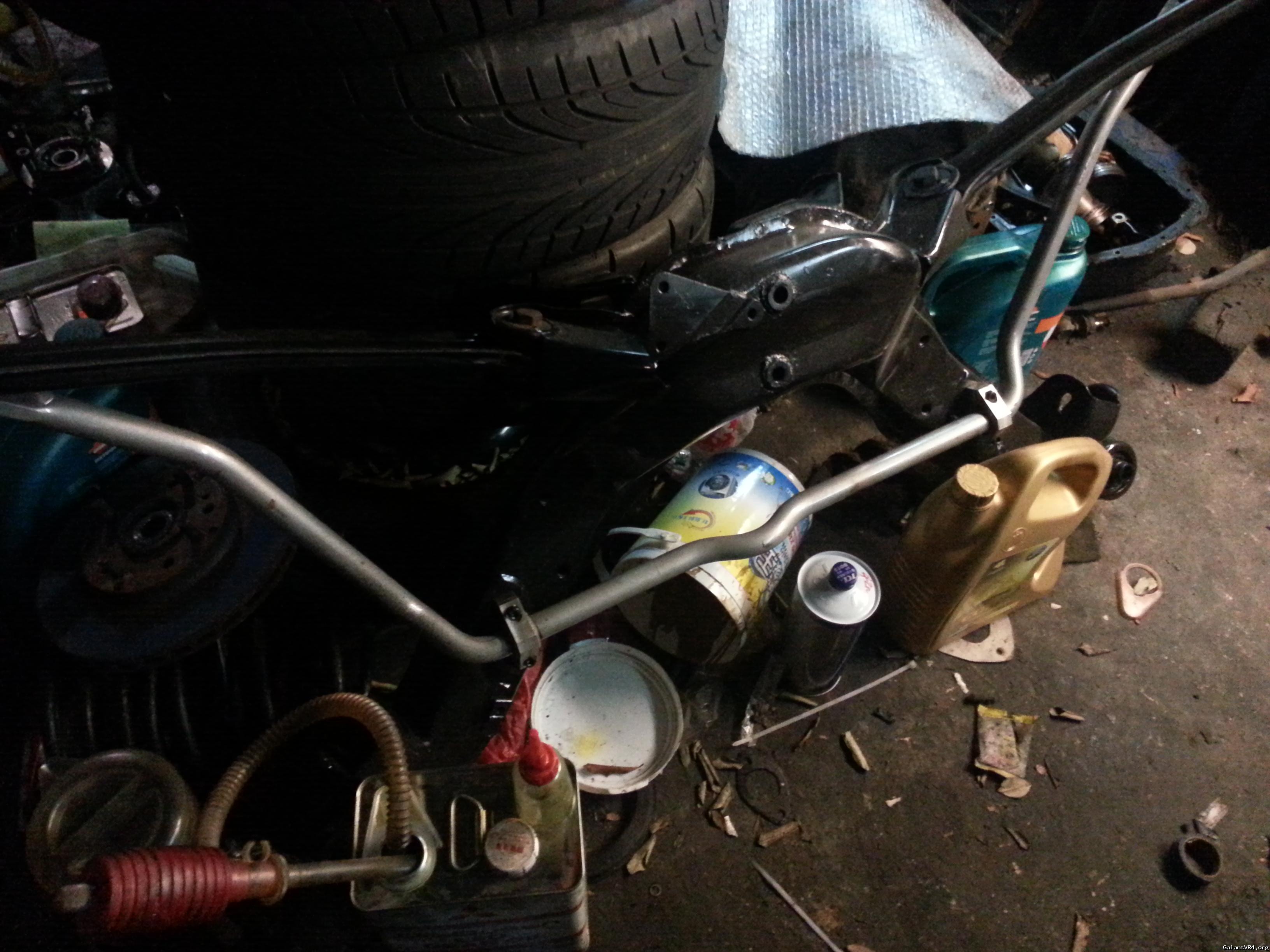

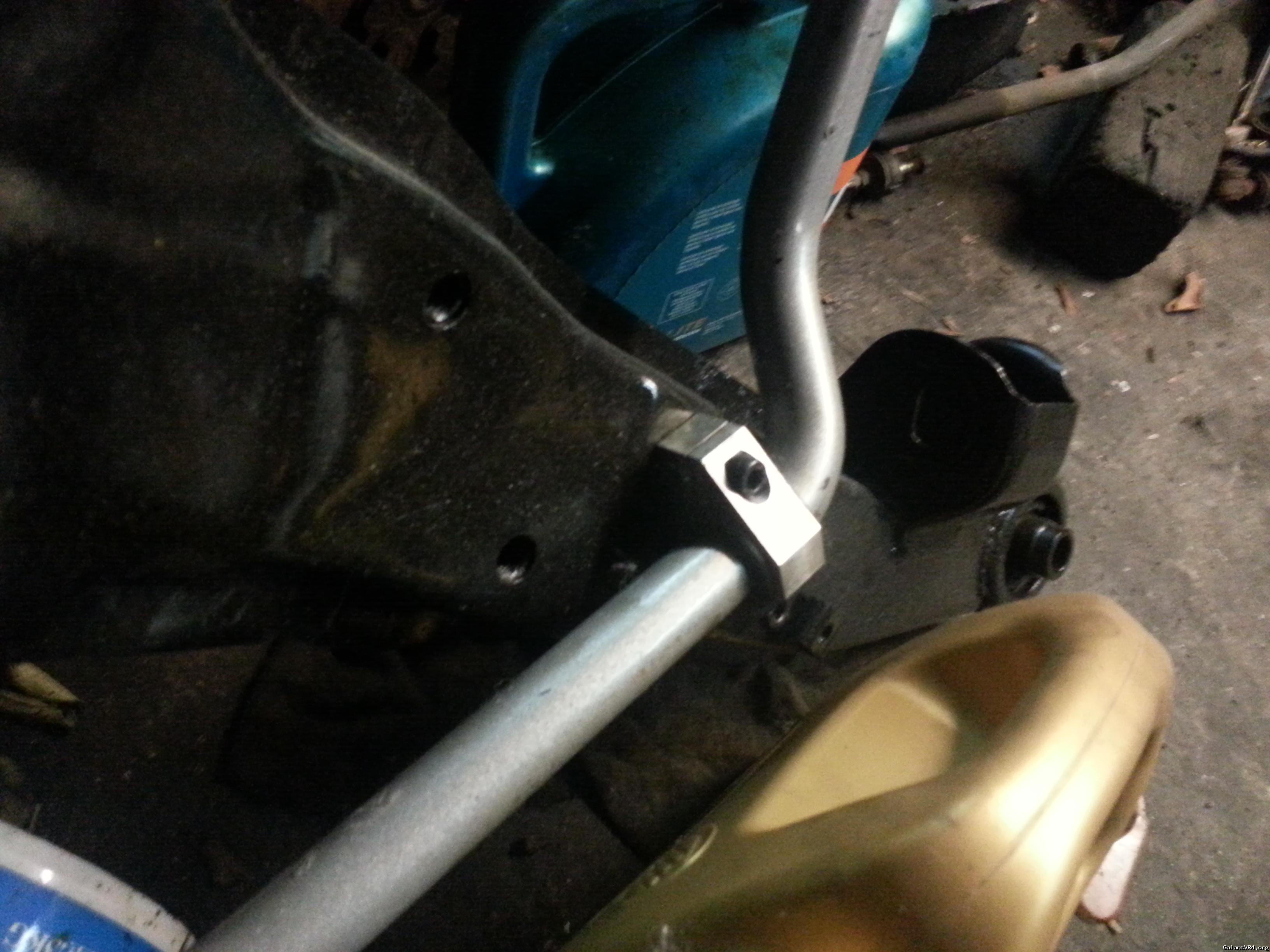

Custom sway bar brackets, big 26mm whiteline rear sway bar and Ken even scored some upgraded Brembo rear calipers and rotors that mount directly to the rear hubs without brackets. Apparently they were a 3KGT kit but we haven't found any front calipers to match yet.

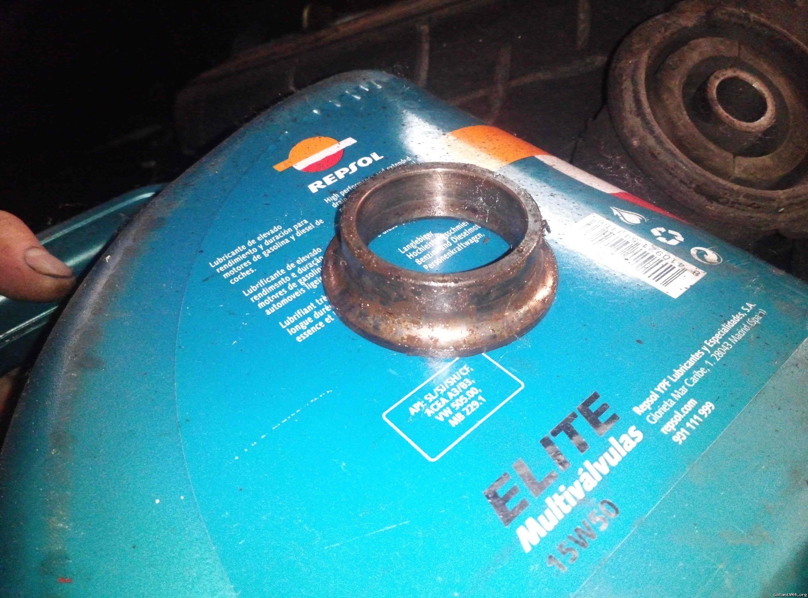

Now I have no idea what you call one of these pieces ...
There are two that fit into each side of the wheel bearing to prevent the bearing surfaces (sides) from binding. Since the bearing was essentially too far away from the axle, a 'spacer' the exact same diameter as the centre part of this piece had to be machined to space the bearing out to the correct position.

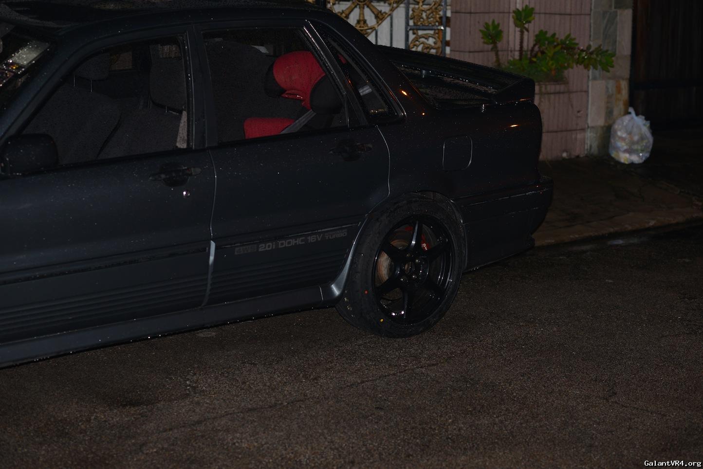

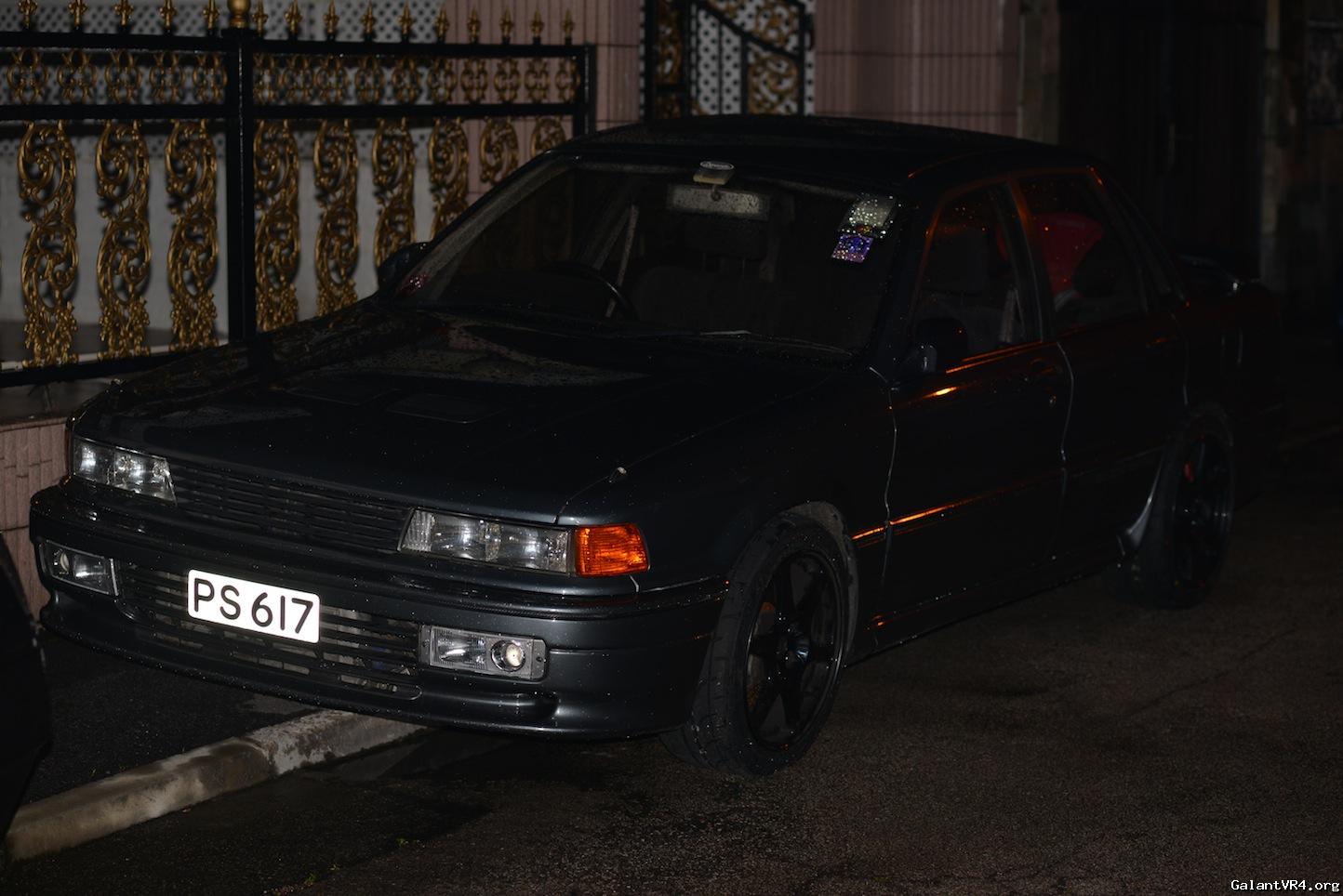

Pictures ...
Sorry, best I could do in the dark with 5 mins in between it pissing down with rain all evening.
I'll get better pics in daylight. Best I could manage tonight was a picture of the DRZ with the SSW package!

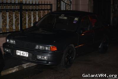

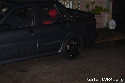

Here you go, sorry about the state of the car. It only stopped raining last night!
I'm a sucker for this look and I really like the wheels this wide. However if I'm really honest it needs a 42 offset. Still it has been a worthwhile exercise in that we learnt a few things about how to tuck the wheels a little more and this should enable us to get the Compomotive MOs on the other car to fit a little better. Anyway, I'm pleased with the result. The car rides really well and it looks good in my opinion. I may however need to raise the ride height a tad at the rear as I still get slight rubbing on bumps with passengers in the back.

Wow those rear hubs really widen the track in the rear. I'm torn between trying this or just doing a basic 5 lug spindle swap.
