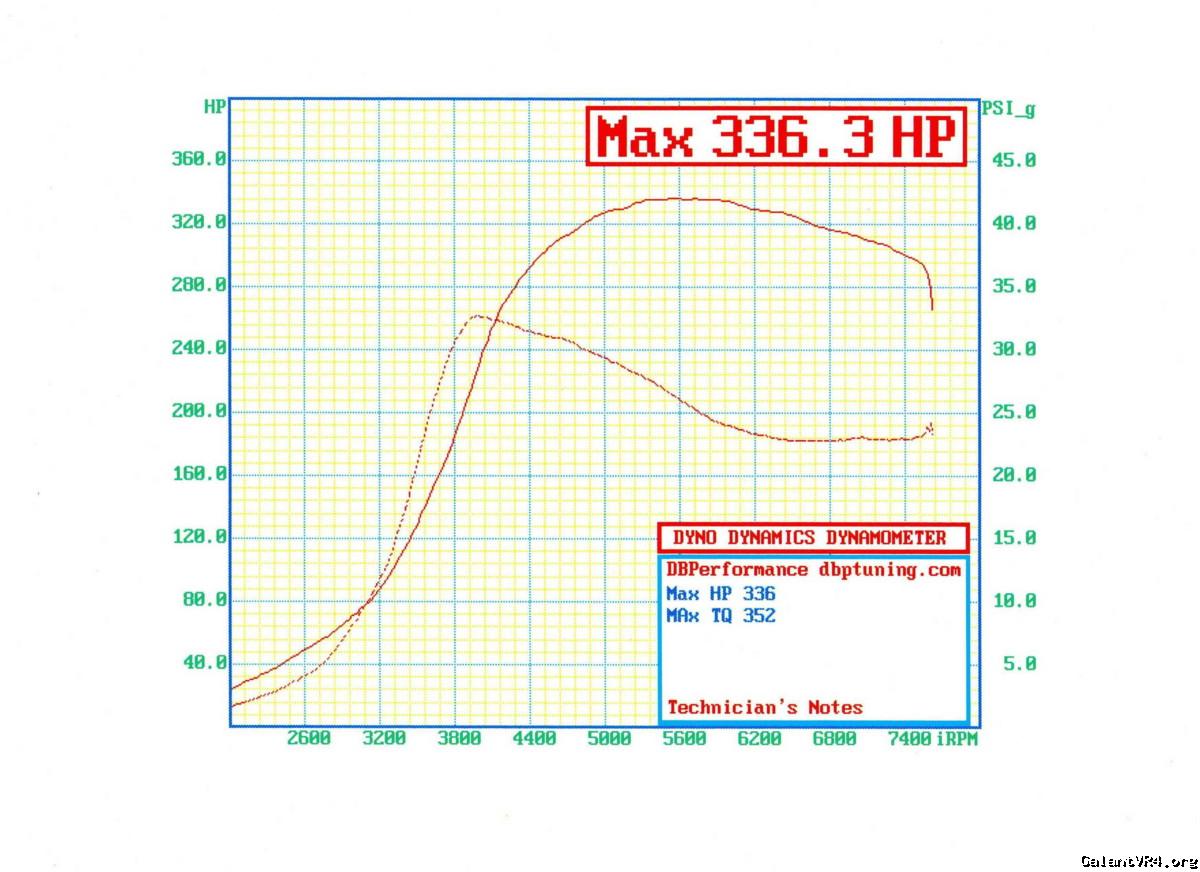

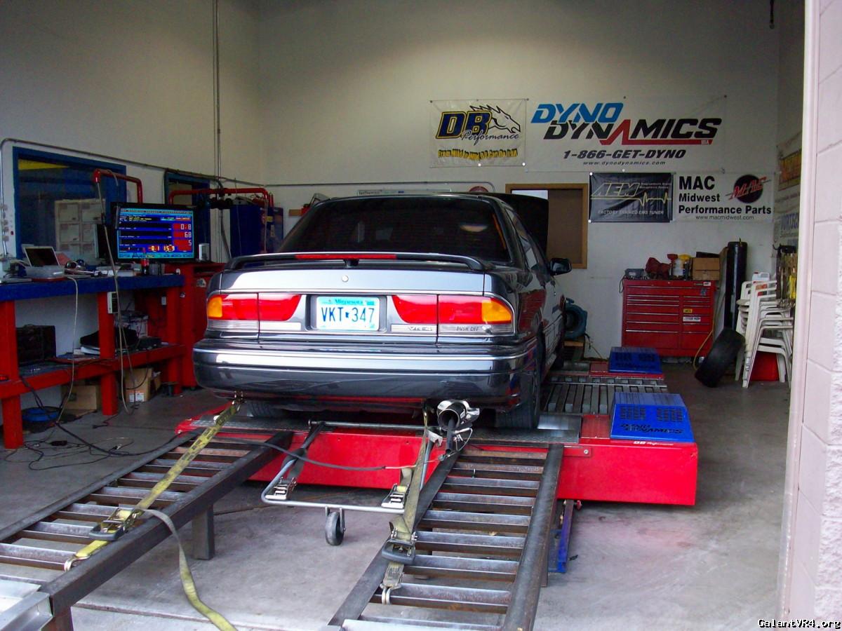

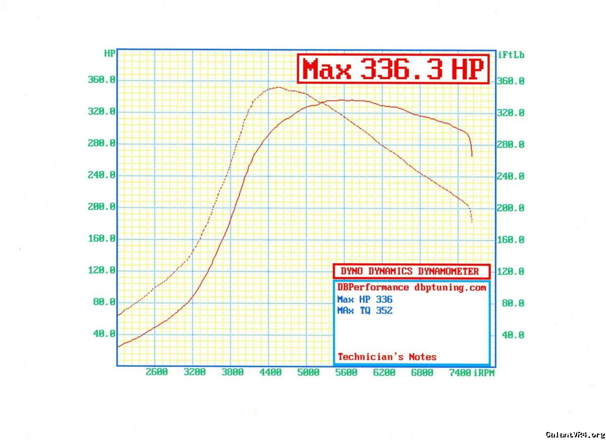

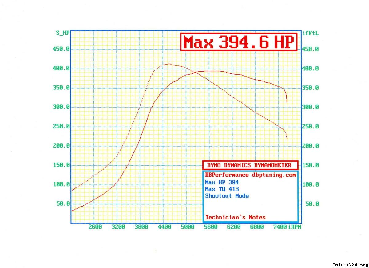

Well I finally got #30/1000 on the dyno for a tune on Thursday. Just your average EvoIII 16g setup on E70 (I love living in Minnesota where we can only get E85 for one month out of the year /ubbthreads/images/graemlins/smirk.gif). This was on DB Performances dyno dynamics dyno with Shane doing the tuning (Big thanks to him for the great tune). The first graph is of horsepower and torque, the second is horsepower and boost, the third is the corrected graph (What you would see from a dynojet), and the fourth is a picture of the slow street car /ubbthreads/images/graemlins/wink.gif. We could have spiked the boost to around 34 psi or so but we would've had to take the plugs out and gap them tighter as 32 psi was right on the edge of blowing the spark out, but it was getting late so we quit at 32psi. Well I guess I'll let the graphs speak for themselves.

What was boost falling to after the 32psi spike?
Sweet kill switch. /ubbthreads/images/graemlins/grin.gif

Yep boost was falling to 23 psi. I would love to only have it fall off to around 25 psi, so today I'm throwing in some tighter gapped plugs and i am going to try turning up the boost a little more.

Great numbers!
Remember, dyno dynamics are low reading dynos...
I've seen other brand dyno's making 50 - 100 hp more on the same setup (at the wheels)
