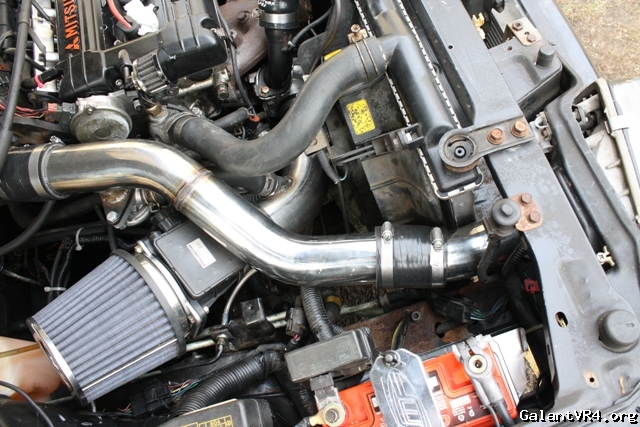

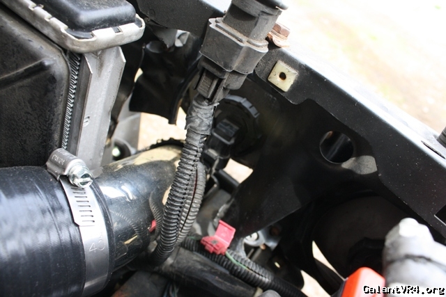

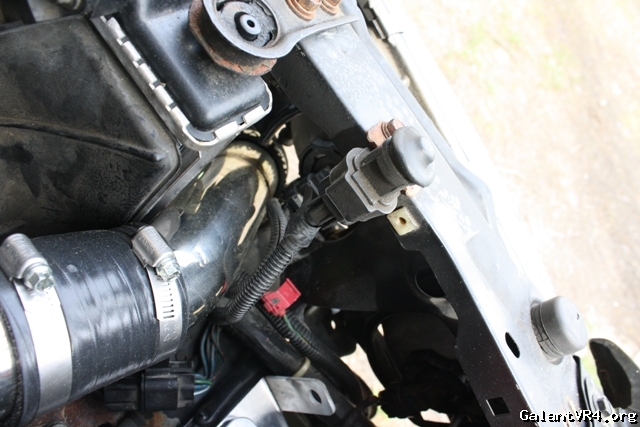

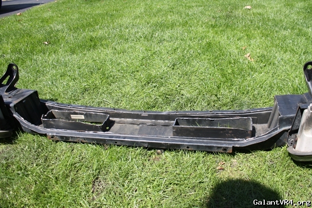

here they are:
1:bumper cut
2:from front of car--left side of intercooler.
3:large view of routing
4:zoom view of where confusion might be...as you can see in this picture; from the intercooler goes the 45degree coupler then the short pipe starts off straight and as it goes past the radiator it take the short 45 degree bend to a straight coupler to the "Z" pipe with the BOV flange on it.
5:zoom view of light being cut(also jon has a picture somewhere else on this thread)

Quoting throughfaith323:
3----
that pipe needs to be rotated like this
throughfaith323
Sep 24, 2008
530
Forked River, NJ
thanks for your input in trying to help me out...i know thats what your intentions were unless you ment it for burnopy. cause i can't rotate it like that since i used a piece of stainless steel i had left over from my exhuast. thats why mine is rotated clockwise about 45degrees. mine also did not line up perfect when it was the way yours is...i think its cause my radiator seemed to be a bit longer then the piping was made for >>> which caused my short pipe to be moved over to the left a tad >>> which left me with the rotated "Z"(upper intercooler) pipe. it worked out for me tho since the intake pipe just makes it under the "Z" pipe.
