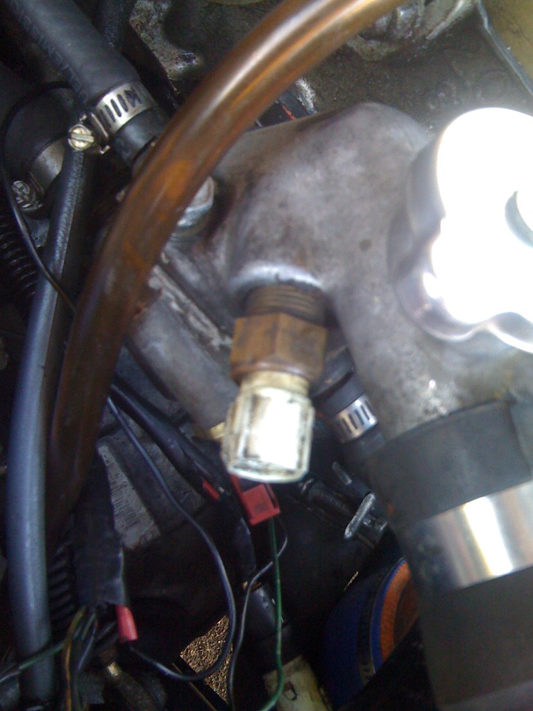

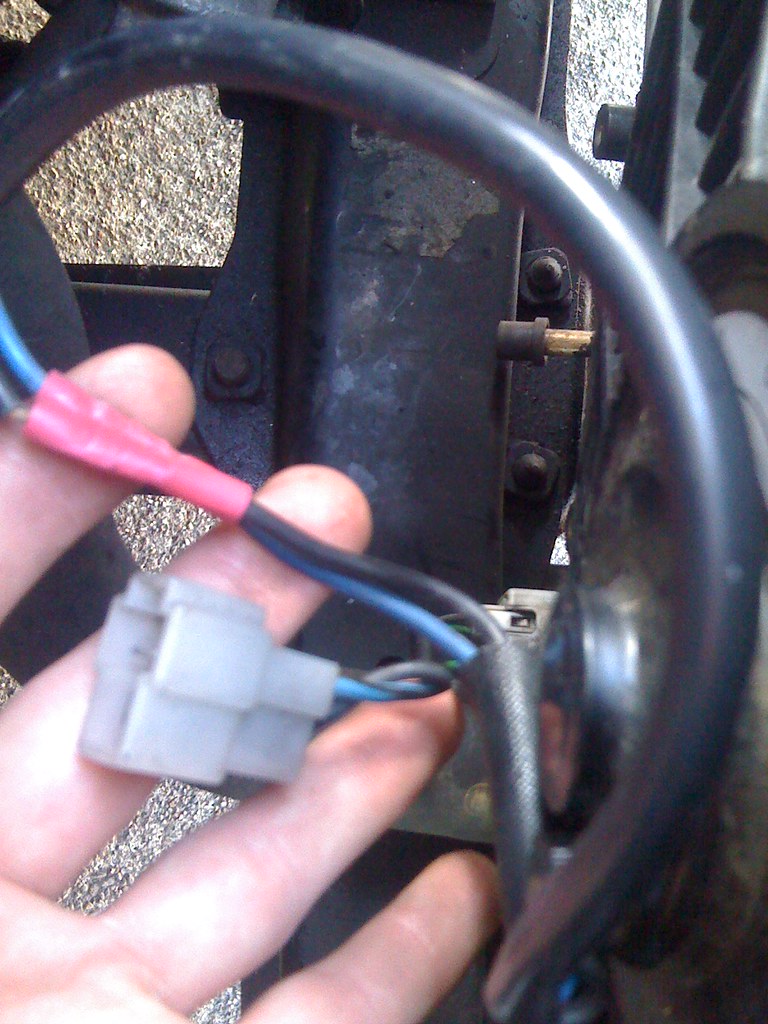

Im running a slimline fan and its always on when the ignition is on, so is the A/C fan. The slimline is wired; blue to blue, black to black? thats how it came is that correct? The single wire sensor on the back of the Tstat housing is hooked up and my logger shows proper temp, and the dash reads proper temp. Here are a couple pics.
The sensor on top in the pic has no resistance value at any temp, what is spec ohm at operating temp? the sensor on the radiator reads OL no matter what temp.
Also what does the white plug goto in the 2nd pic?

The white plug goes to another coolant sensor on the t-stat housing. If the housing isn't from a turbo car, it may have a plug instead of a sensor.
The white plug in the top pic is used for the A/C. If the car gets too hot that sending unit will turn off the a/c and turn the fans on-which sounds like your problem. A bad sending unit.
Tom
The sensors I have on the tstat are; ecu sensor, single wire sensor on back, and A/C sensor on top. Your saying I should have a fourth sensor? The plug that is dangling is not long enough to reach the tstat housing which would make me believe it is for something else.
Do you know what the resistance value should be for the A/C sensor? The fan runs whether it is plugged in or not, I can also pull the a/c fan relays and it will still run. the only way to kill the a/c fan is to pull the fuse.

The second Pic shows the resistor plug. Which is not there. I am not sure about your problem but this resistor supposed to control the speed of the fan. The switch (sensor) at the radiator under the fan should turn ON/OFF fans when reach certain temp.
