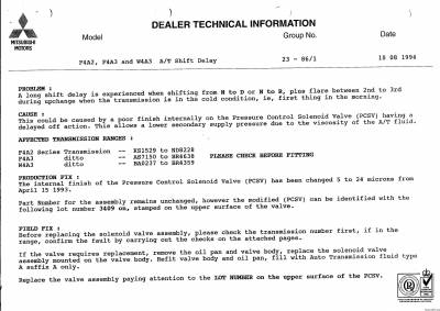

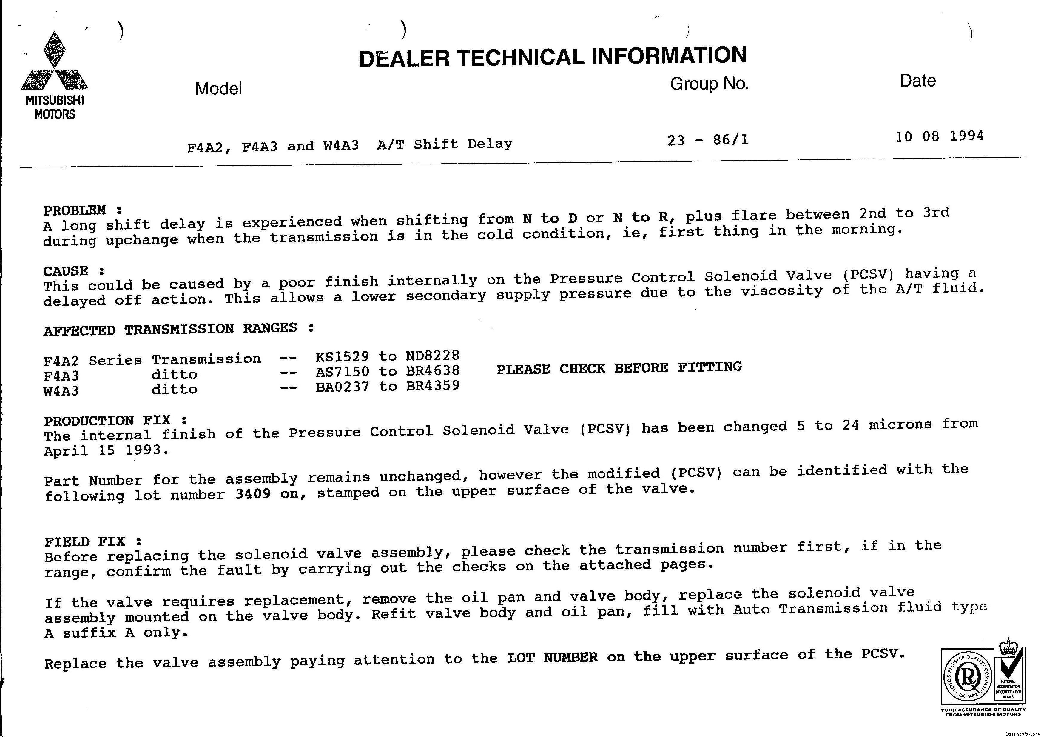

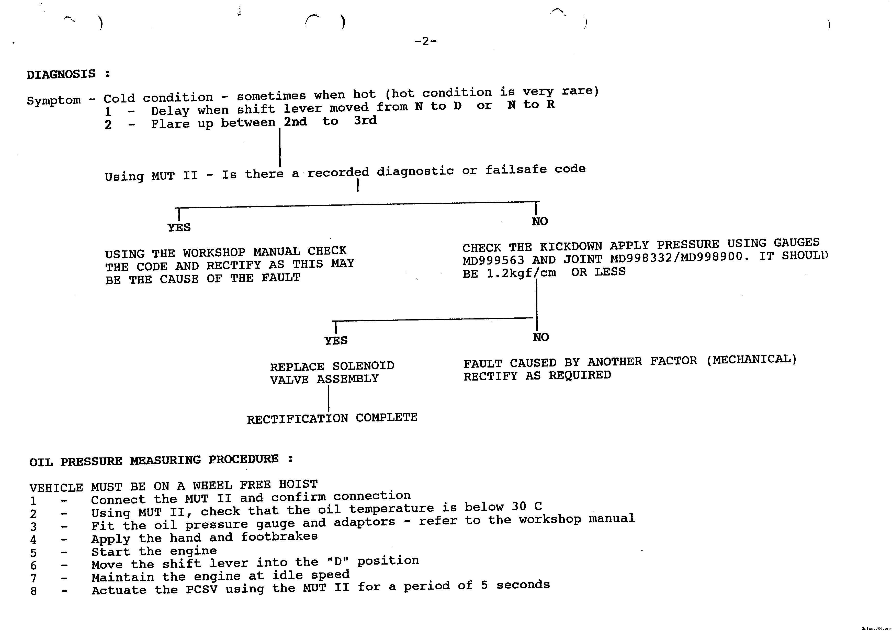

Here's the S/B:
Off topic abit, but related. (knew it was something to do with the solenoids.

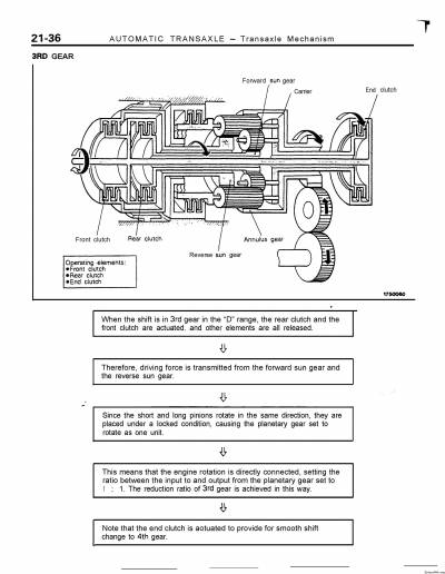

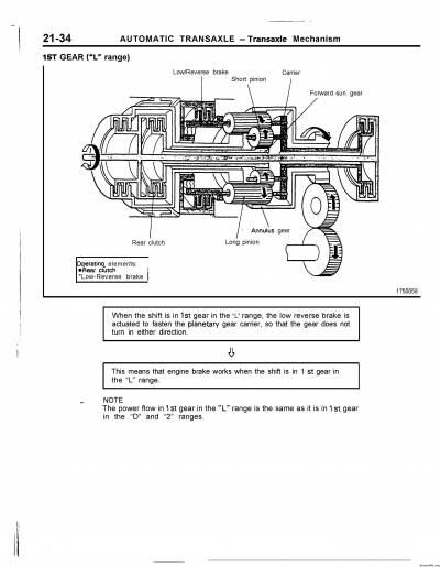

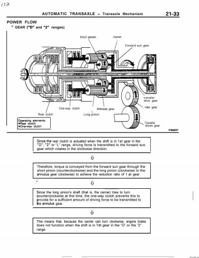

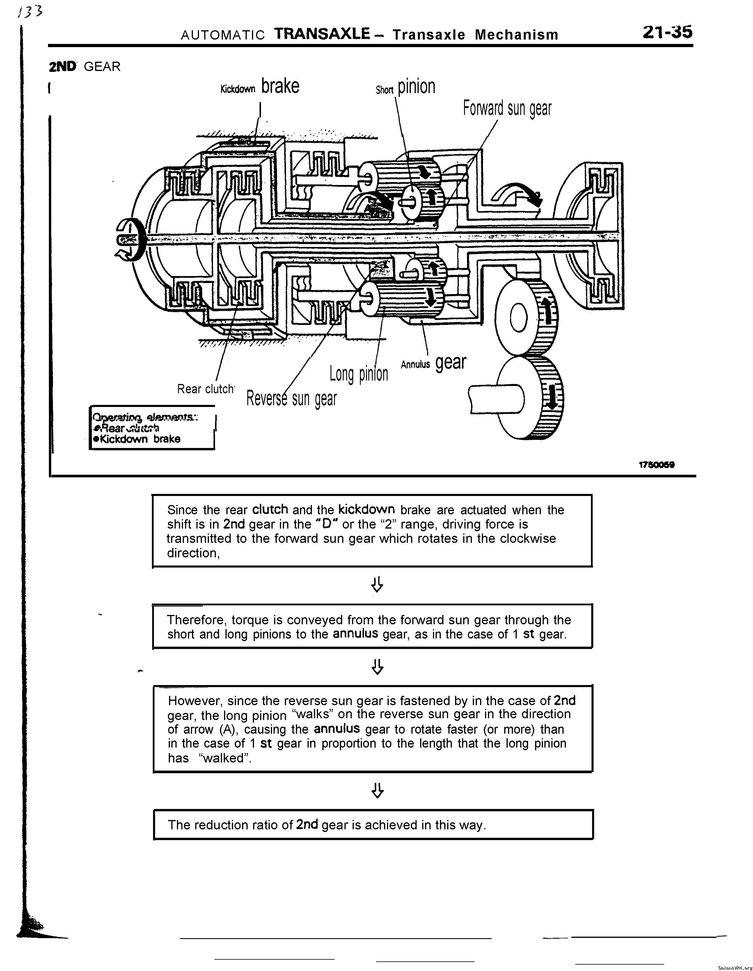

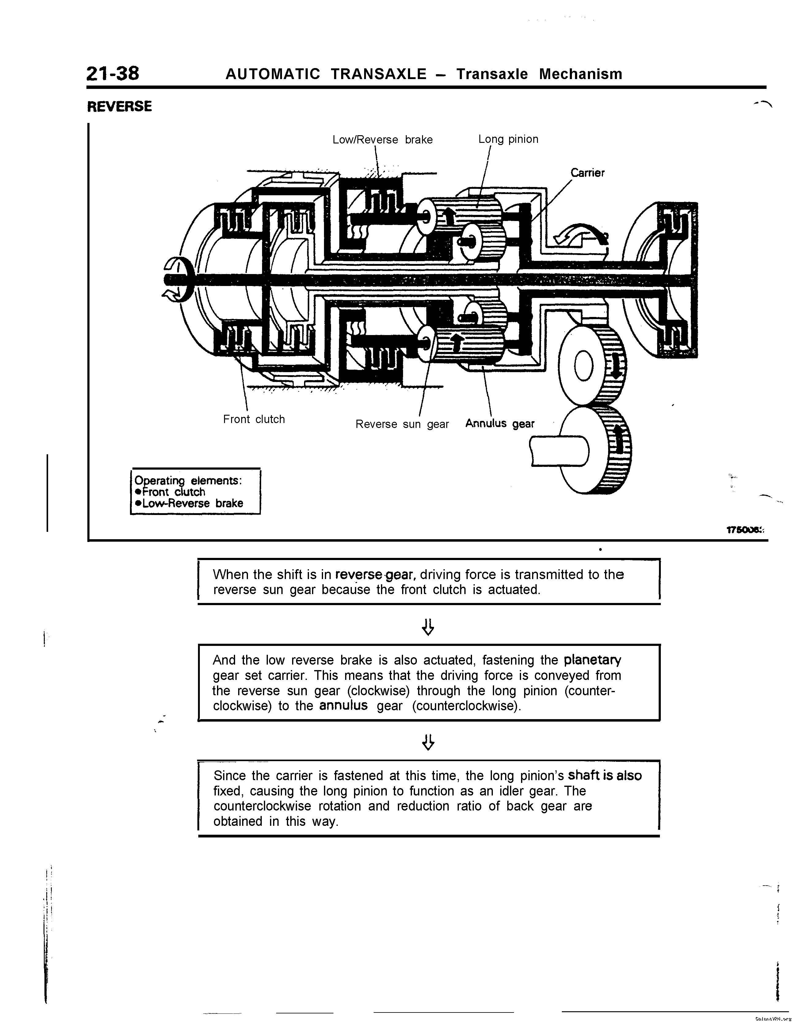

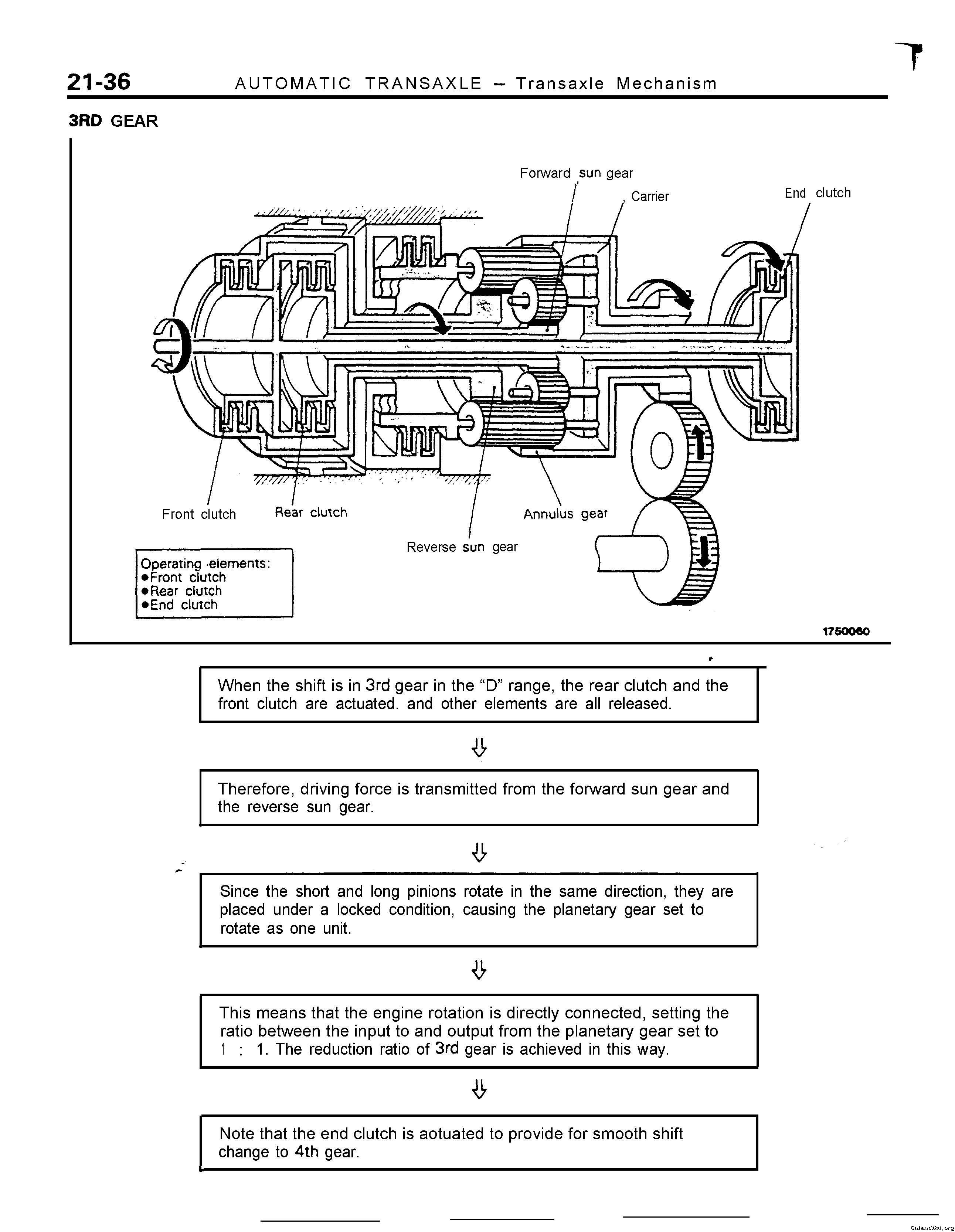

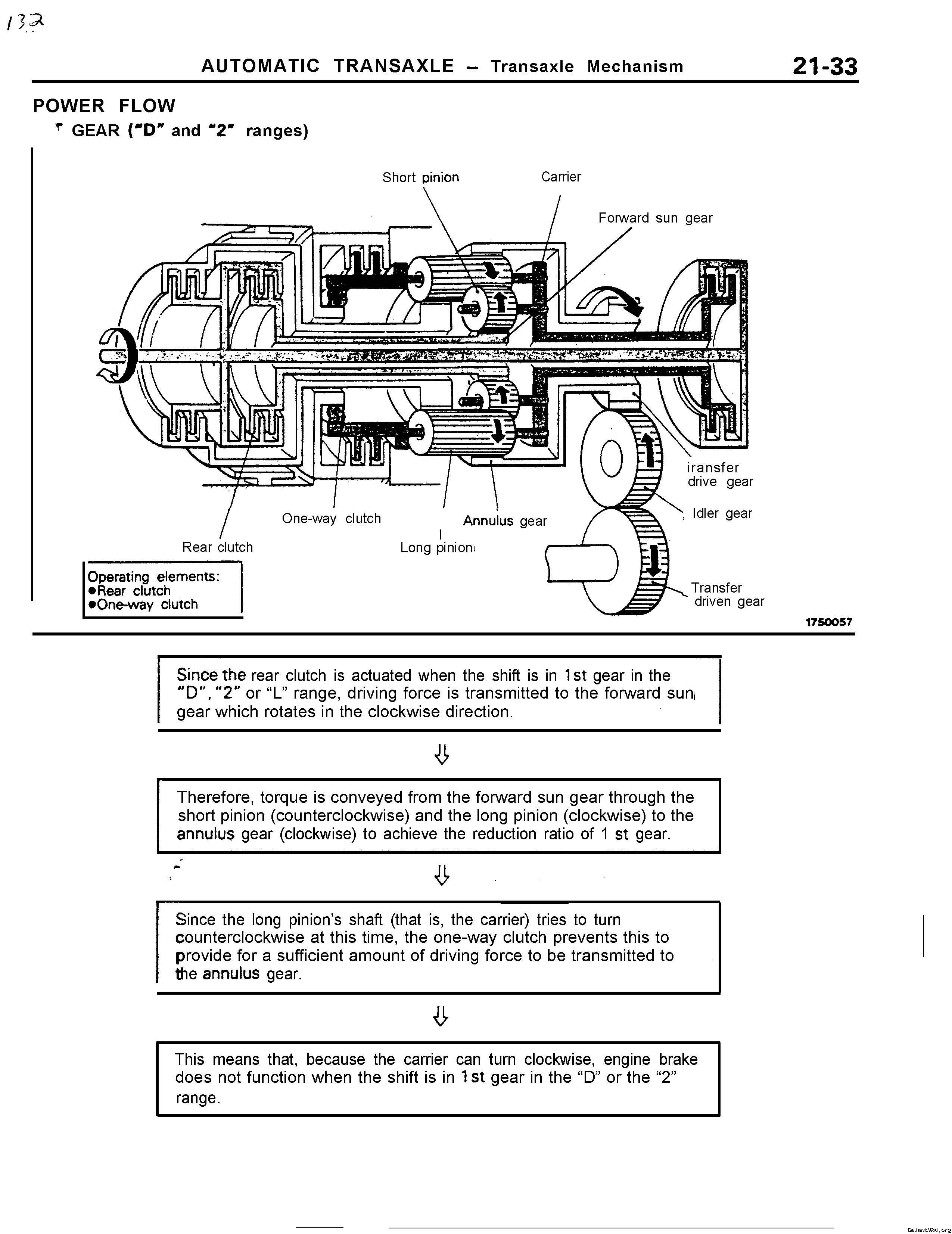

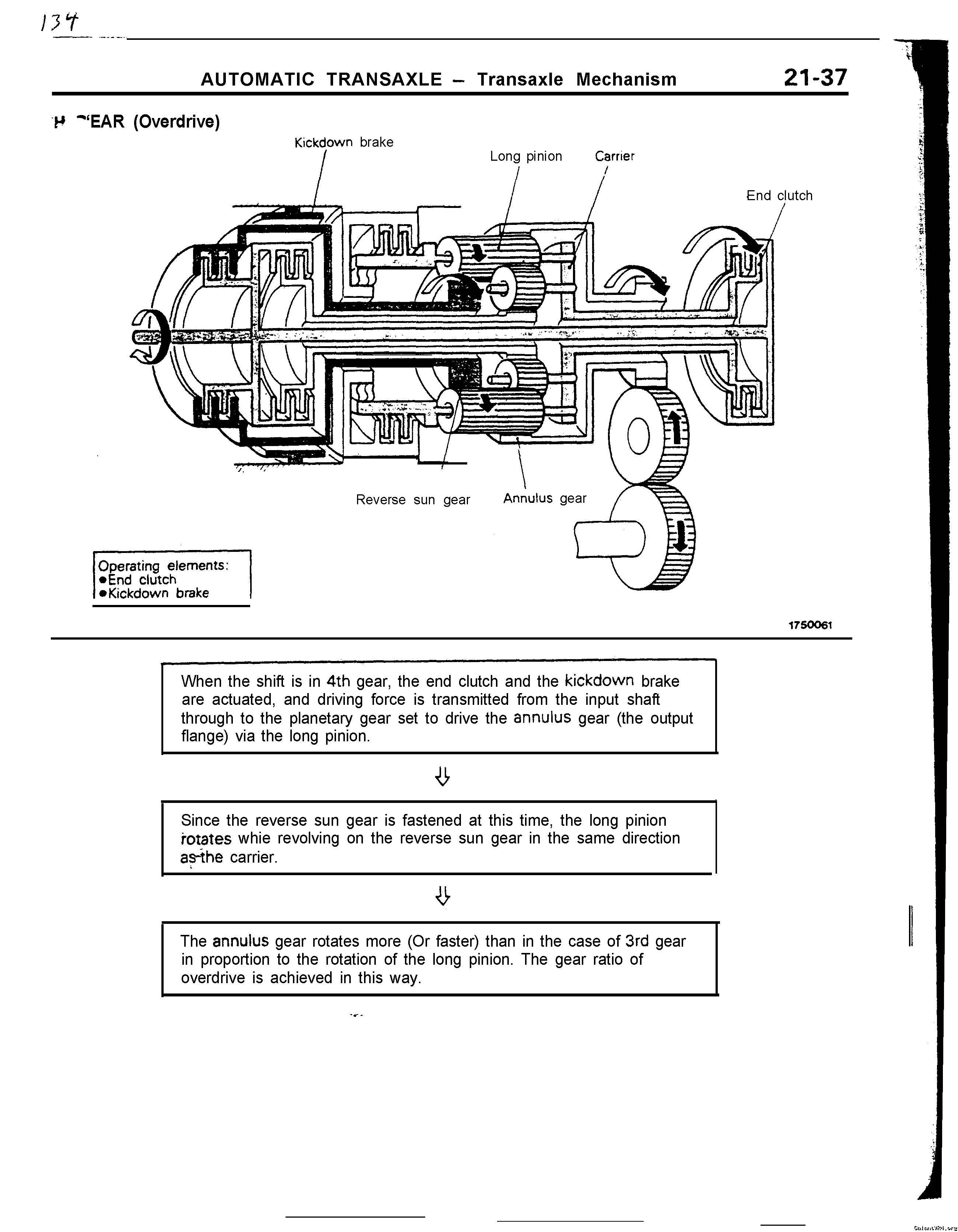

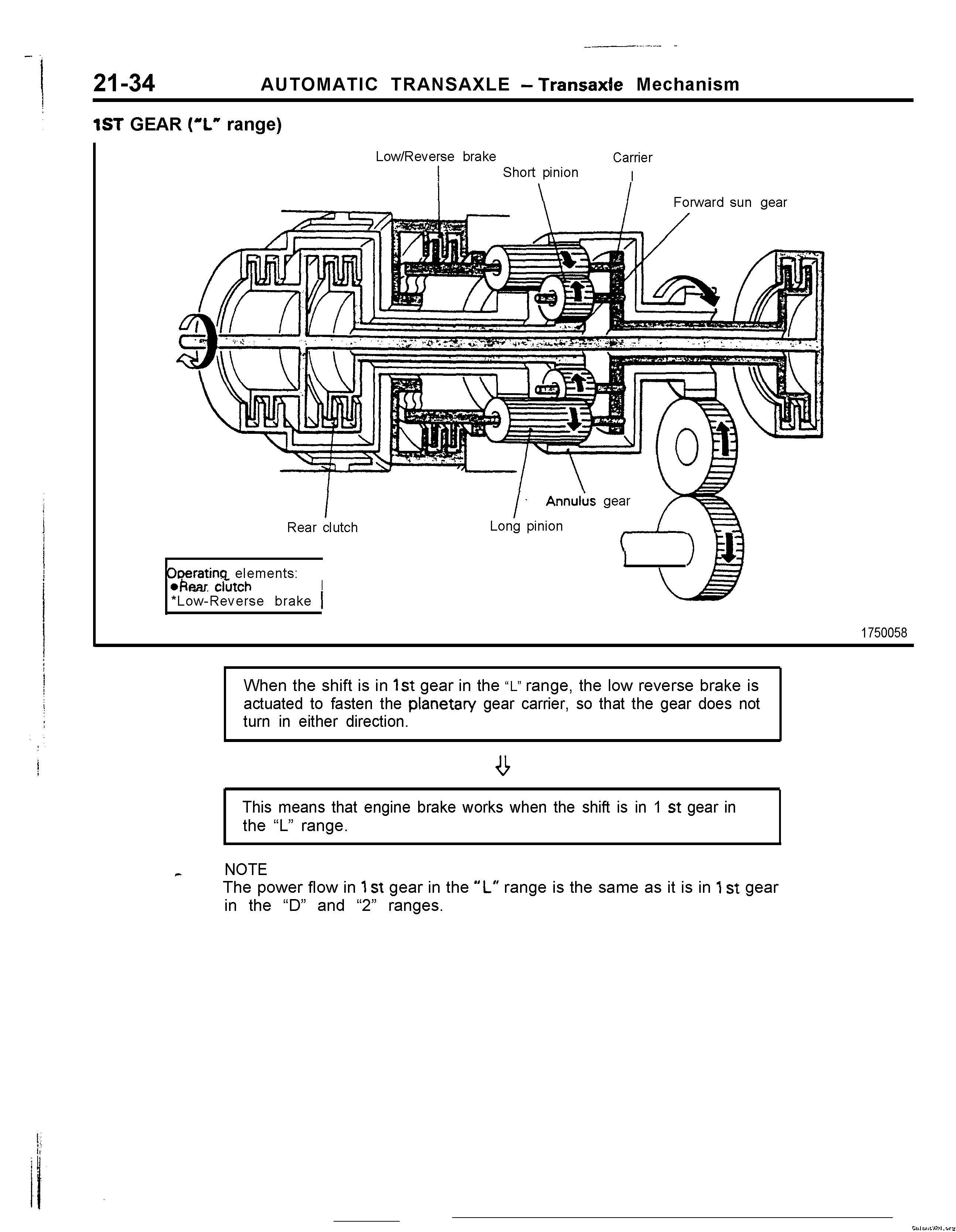

Here's the powerflow diagrams for the box. This shows whats operating at each mode.
I'd be inclined to follow the rear cluch line of enquiry. If you can check the solenoid out ok then it looks like a teardown may be in order.

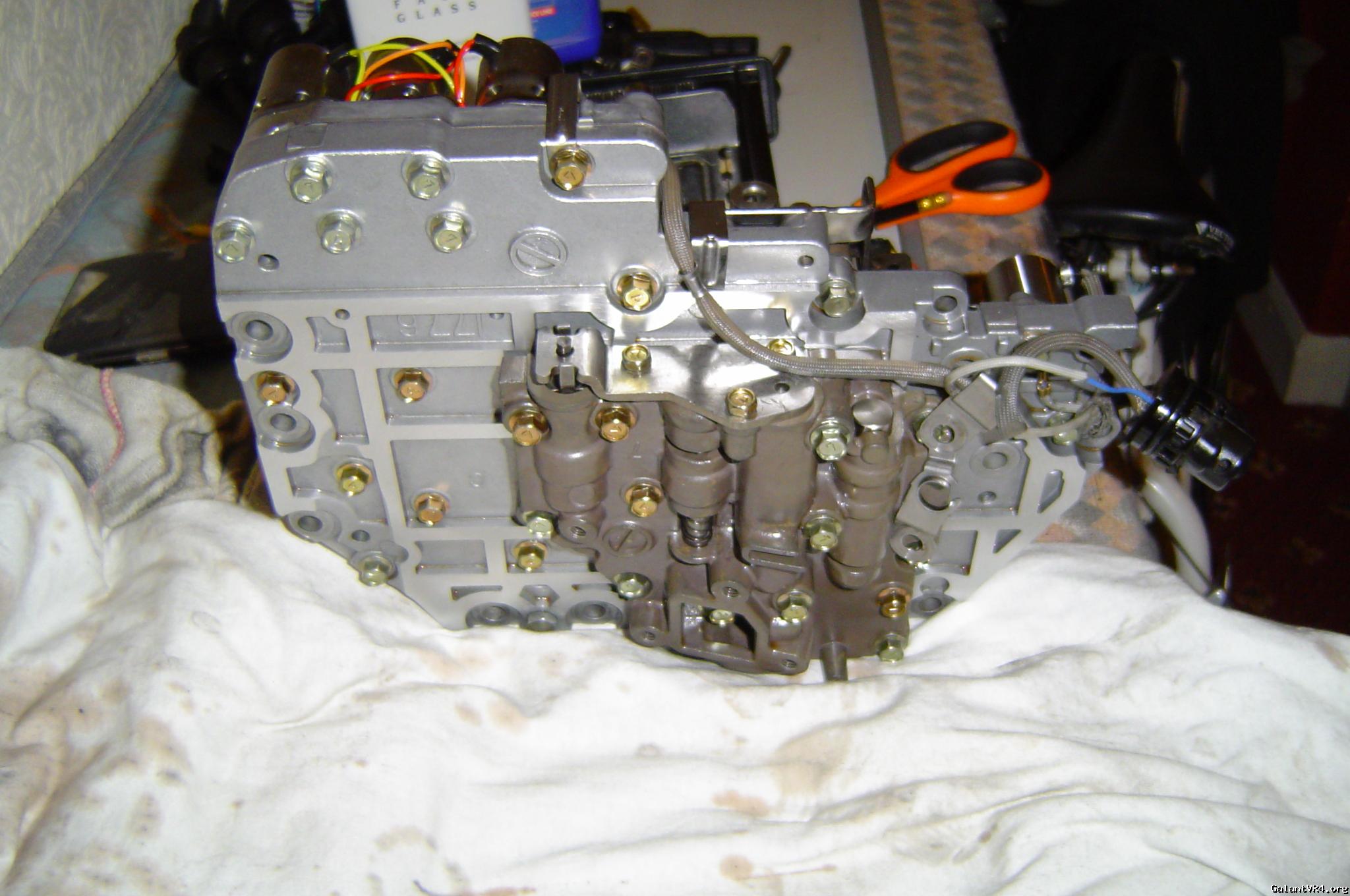

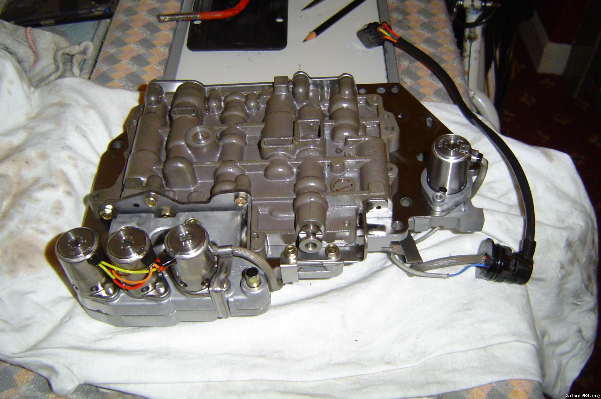

Here's a couple of pics of the valveblock (this is mine post rebuild).
