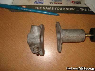

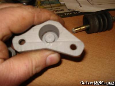

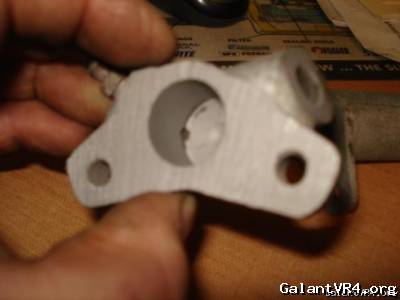

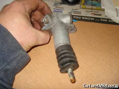

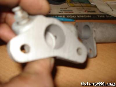

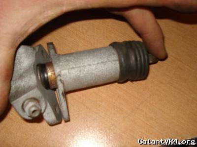

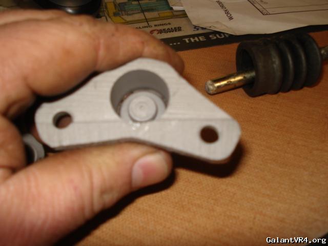

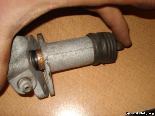

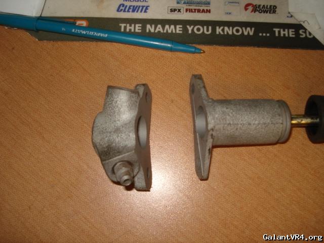

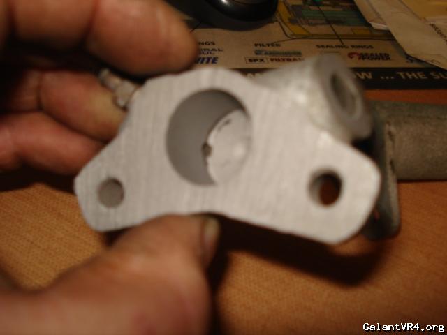

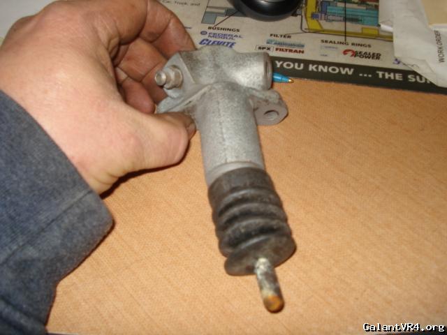

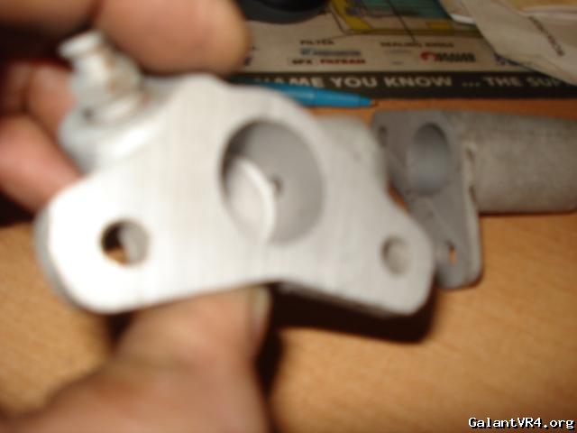

This is probably going to be easier to show than explain.
Slave Cylinder:
This picture shows the feed port inside:
Directly across from that, is the bleed port:
Simply bleeding it as if it were brake lines would only remove the air from the master and the lines as the fluid will travel into the slave on the feed side and then right out the bleed port (path of least resistance), which does nothing for any air contained in the cylinder itself:
The piston (center of cylinder) is positioned at the point where it usually rests in the car. As you can see, there's a lot of space there (almost as much volume as the complete clutch line itself) for air to get trapped. That's where compressing the piston all the way in towards the feed and bleed ports comes in to play. When squeezed shut, you push the piston all of the way back towards the bleed & feed ports, ridding the slave of the open volume:
Just be sure to compress the piston while the bleeder is open, and close the bleeder before letting the slave cylinder decompress. You want it to suck clean, air-free fluid from the direction of the master cylinder when it refills itself on the way back out.
Using an pneumatic system is fine as well, just make sure that the slave cylinder is compressed while doing it, and to close the bleed screw before you stop suction or pressure (whichever type of bleeder you're using).

That's our special-edition Slave Takedown version. ;-)
Yes, I just introduced one we had sitting around to the band saw.
