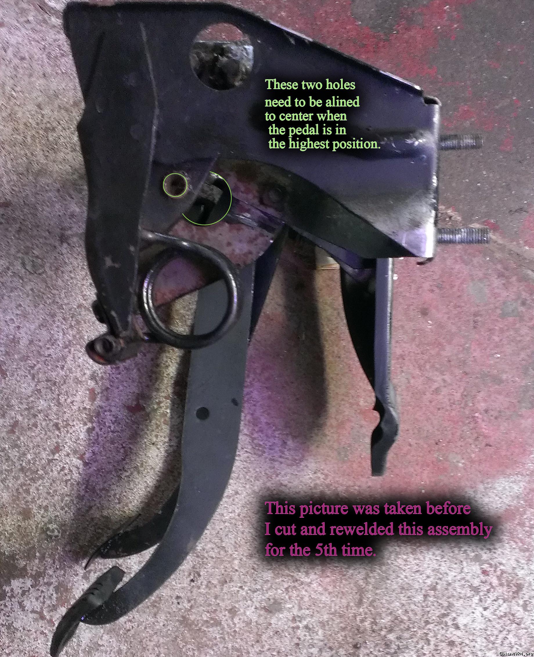

Today I welded a nut in front of the piece that threads into the MC rod to give me a little more adjustment room
I considered this too. I ended up cutting and welding my pedal for the 4th and 5th time. I think I have it where it needs to be now. If the pin for the MC is aligned with the hole in the pedal assembly slightly biased to the fire wall than you should be good.
I just made this quick.
I'll have to check that out. Thanks for the pic. 5th time welding it? /ubbthreads/images/graemlins/ooo.gif

5th time Yeah. I have my pin past this hole towards the fire wall now.
I have my clutch adjustment all the in instead of all the way out.
My pedal is still not in the right spot because of the return spring
not being able to close all the way. My clutch releases and I can
still press my slave in by hand so I'm ok with it. 6 times is too many.
edit: 3 -4 and 5 were too many. but it does work finally.

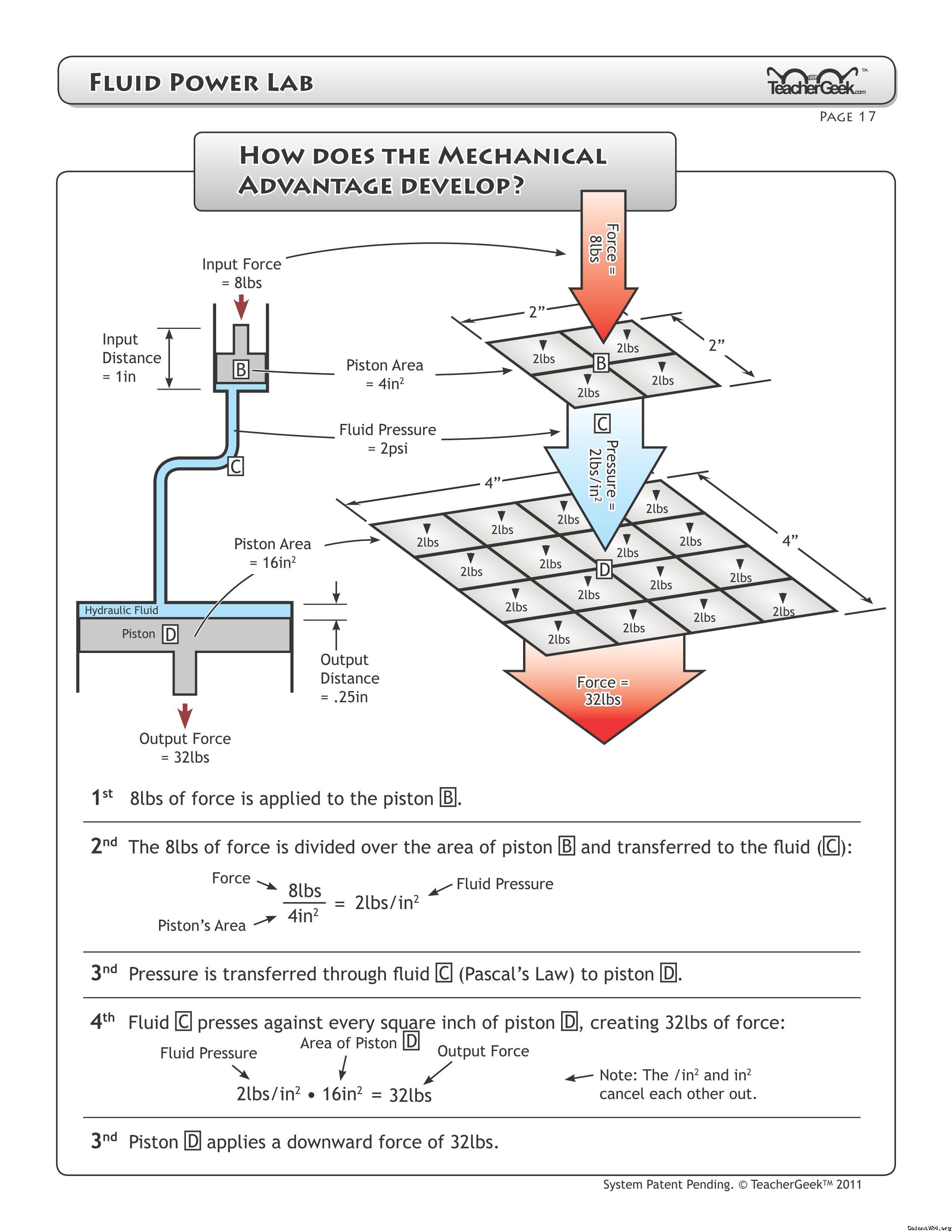

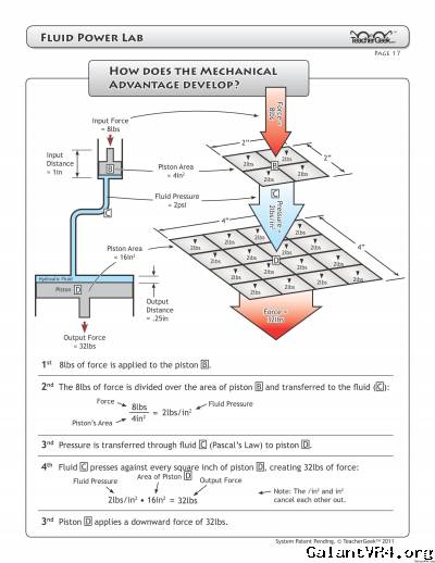

Hydraulics are absolutely a mechanical system in the sense that they create mechanical advantage, just as pulleys or gear sets do. Yes, you have the same hydraulic pressure behind both slaves, but the output force will vary depending on the area of the cylinder's piston, which is clearly different between "red" and "green" slave cylinders. As you said, the constant here is the piston of the master cylinder, which is the largest piston in this particular clutch hydraulic system. Hydraulic pressure is created by the master cylinder as the clutch pedal is pressed, and is then transferred to the clutch fork by the slave cylinder. That much I'm sure you know. However, the amount of force exerted on the fork will vary depending on the area of the piston of the slave cylinder (if all other things in the system remain constant i.e input pressure at the master and the size of the master's piston). If you want a mathematical explanation, I can do that for you, but suffice it to say if you have two slave cylinders operating in the same system, the one with the larger piston will exert more force, and travel less distance (again, everything else being equal).
3,473
Piston 1 is the master cylinder:
Lets say the master cylinder piston is 16in² in area (we'll use a square piston for ease of understanding, normally you would be using the area of a circle). Now lets say you apply 32lbs of force upon the master cylinder's piston. That would produce 2psi of pressure. This is a constant in our particular scenario. 32lbs/in² divided by 16in² = 2lbs/in² of output force created by the master cylinder. Now, take the force created by the master cylinder, and multiply it by the area of piston 2 (the slave cylinder in this case)
Piston 2 is the slave cylinder:
Apply the 2psi created by the master cylinder to the slave cylinder's piston. We'll calculate for the smaller "red" slave, which we will say for example is 4in². Multiply the pressure applied to the slave's piston by the area of the slave's piston, and you get 8lbs of output force. 2lbs/in² * 4in² = 8lbs/in² of output force from the red slave.
Now, apply the same thing to the larger "green" slave. We will take the same 2psi on input pressure created by the master cylinder, and multiply it by the area of the larger green slave cylinder's piston, which we will say is 6in². 2lbs/in² * 6in² = 12lbs/in² of output force from the red slave.
This simple mathematical explanation outlines how 2 different sized hydraulic pistons would exert different amounts of force when the same input pressure is applied to both. The only thing that changed in the scenario, was the actual size of the slave cylinder's piston. Also, as you said, the smaller slave cylinder piston would travel a greater distance than the larger piston, yet exert less force on the clutch fork.
I'm not a mechanical engineer, and certainly no math whiz, but I believe this to be true. Maybe Barnes could chime in and explain what I'm trying to say better. I've related the numbers to the attached image, which is the best visual representation I could find.
