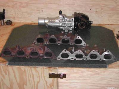

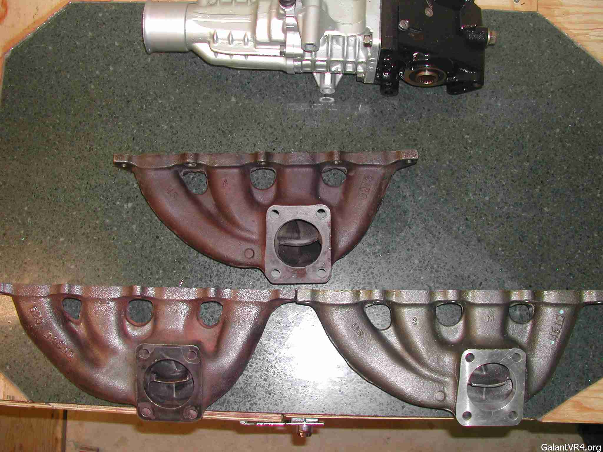

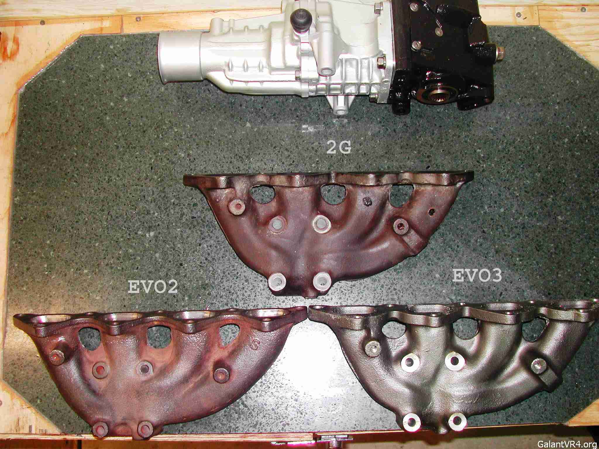

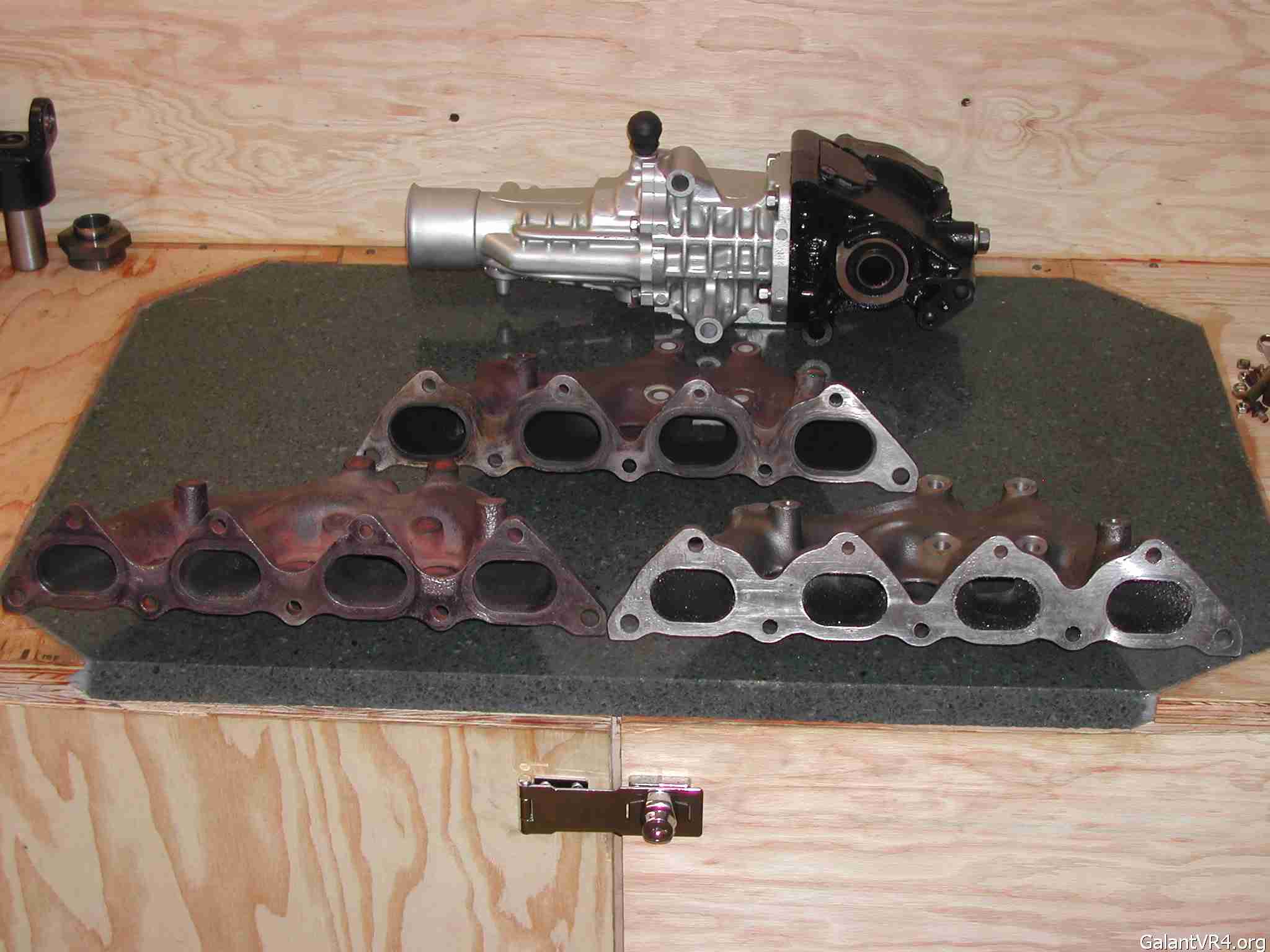

I took a few pictures today of a EVO2, EVO3, and a 2G exhaust manifold. There isn't much visable difference between the three of them. The EVO3 flange does look like it has more surface area to mate with the head. I don't know about the differences in alloys used between the three.

nice someone move this to the how to or something so people dont ask "what is the difference between the evo 3 and 2g manifold"

Get some tape and some veggy oil and cc them. As long as none have been ported on you could be the know all manifold guy. If you don't have a graduated cylinder just use kitchen tools or go bum a cylinder from a school's science dept.

Curtis, that is a good idea, unfortunately all three have the step removed in the collector. I am going to install the E3 once it gets back from OK, HPC coating, along with the turbine and O2 housings. I am going to sell the other 2.
