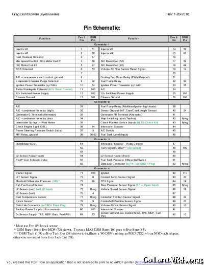

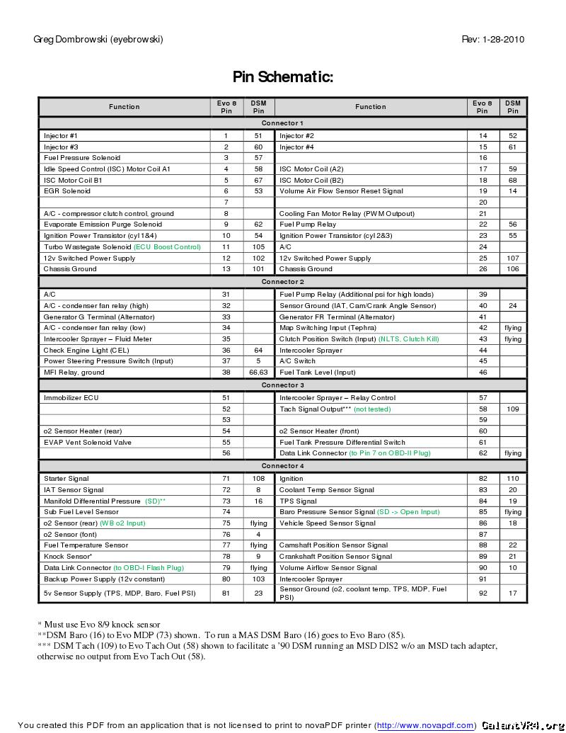

As far as the schematic posted, I too had to reverse the B coil of the idle control. You can find plenty of schematics that have them shown either way and you can find plenty of people saying "it is wrong", but nothing clarifies which of the two ways is wrong... Don't worry, the worst that happens is your ECU can't control the idle. Then you just swap the wires around and go on your way.
Digging through hundreds of posts I also found a post from our old friend Keydiver. He figured how to wire up the A/C so that it would work. The schematic is:

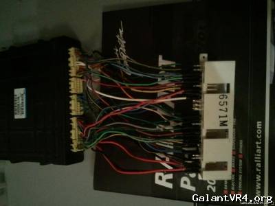

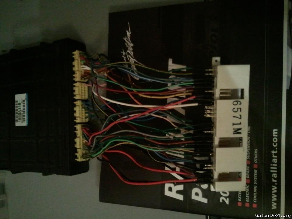

Here is a picture of the jumper harness, I used heat shrink on each wire to cover the bare ends. Also I found it easier to tin the wire ends and pins separately so it took less heat to join them.
