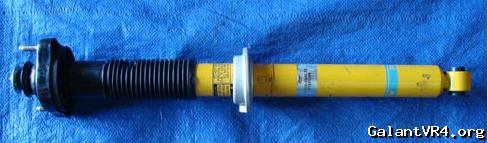

As stated before, the rears from the X are taller, so you are stuck with the 8/9's. The X fronts are slightly taller than the 8/9 and have a different spring design. I am extremely happy with how my setup came out.
If you don't want KYB's, then look for the Bilsteins that came on the MR models.

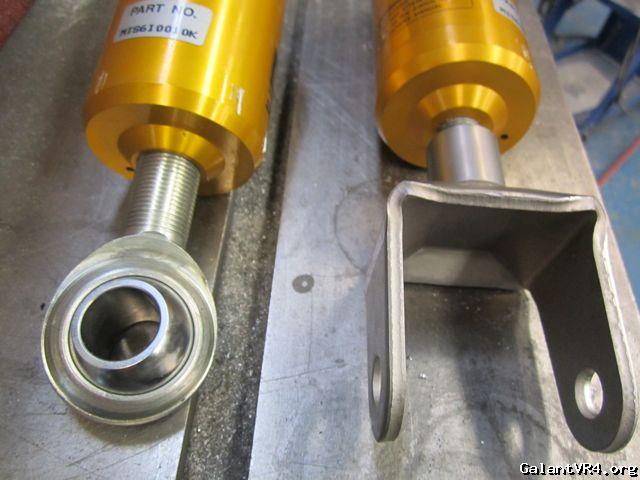

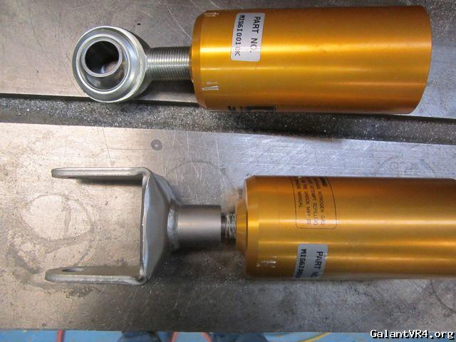

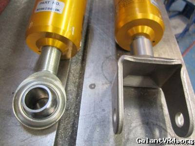

Is that picture supposed to be the actual coilovers you are getting? If so why do they come with the bushing built into the end of the shock instead of the fork that fits over the bushing on the EVO rear end?
Edit: I am just confused because that photo says EVO VII-IX. I know this thread was specifically about the EVO X struts. Did you order the EVO X specific ones?

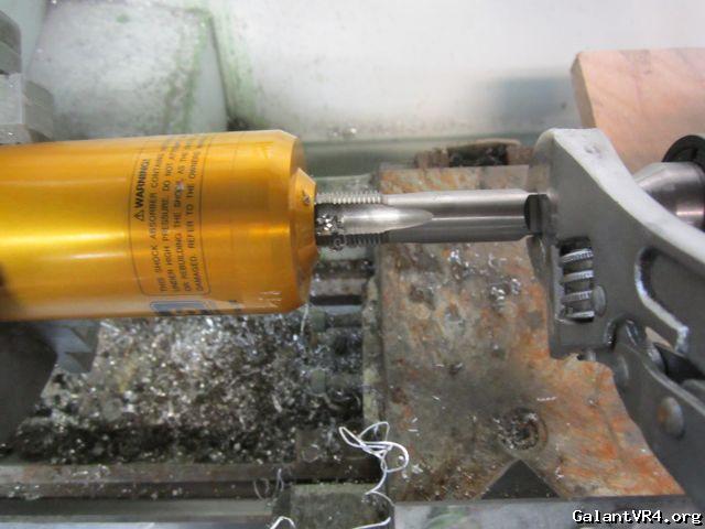

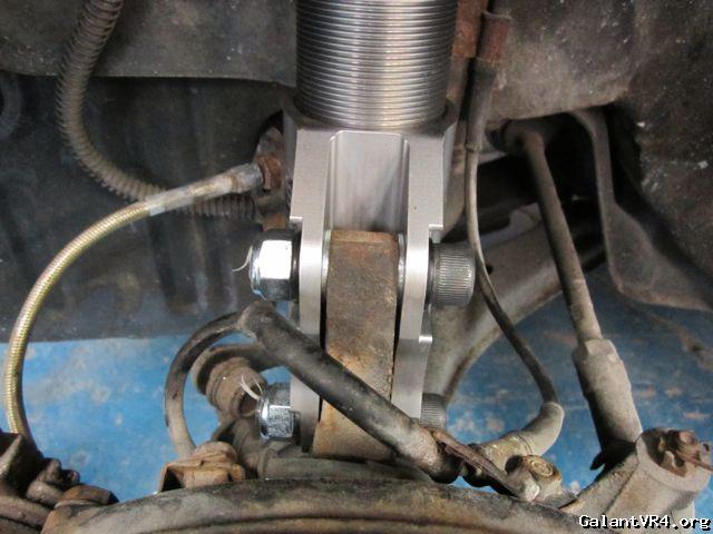

That photo has the wrong end shown on it. I am getting the ones for the Evo 8/9. I will still have to swap out the lower mount on the rear shock, drill two holes for the up front mount and make a spacer were the strut bolt's to the spindle! I got a really good deal on them is why I decided to go this route. They still cost a lot of money, but I didn't like any of the other options out there. I guess I'm just too picky.

No I actually think that was the best option!
I was wondering if you had chosen to go the EVO X set route thinking (quite logically) that even if the strut was longer that you could dial out the difference in height using the ride height adjustment. I just had concerns you wouldn't get enough adjustment doing that. When I ordered my Hotbits years back I got the rally specific struts. The shock body is about an inch to two inches longer than stock to give additional ride height (pretty much in the ball park of how much longer the EVO X front struts seem to be). When I got them on the car I decided I liked the look with the car dropped a little lower. There was plenty of adjustment at the back and I could get the car as low as I wanted but there wasn't enough adjustment at the front because of the additional shock height. It's a shame but given the state of the roads around here (the reason I opted for the rally shocks) I'm probably better off lifting it the extra inch or so. For yourself however whilst having to do the rear bushings is a bit of a pain, I think the end result in terms of adjustability will be much better.
Since you got a deal, I'm guessing you are happy. Personally if I was dropping that sort of money on a set of Ohlins, I would have contacted Ohlins direct, told them straight up what I was doing and asked if I could order a mixed set of EVO VII-IX fronts and EVO X rears. We probably ought to tell Ohlins that if they changed the width of the mounting ears, slotted the holes for the bolts on the VII-IX fronts and sold them as a set with the X rears they would have a Galant VR4 specific product /ubbthreads/images/graemlins/rofl.gif

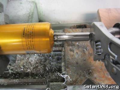

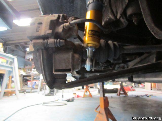

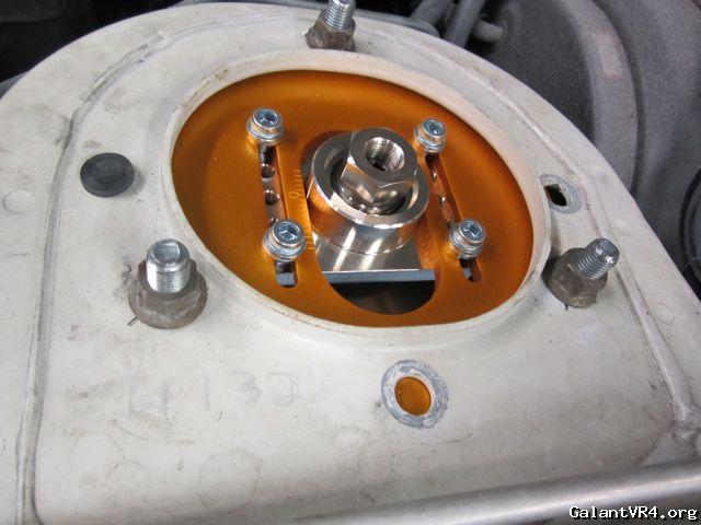

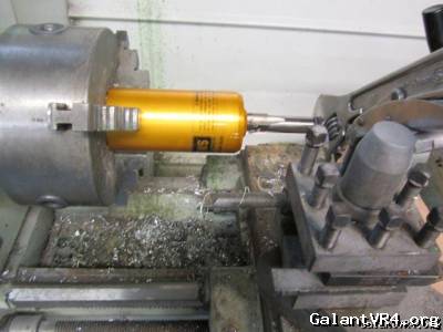

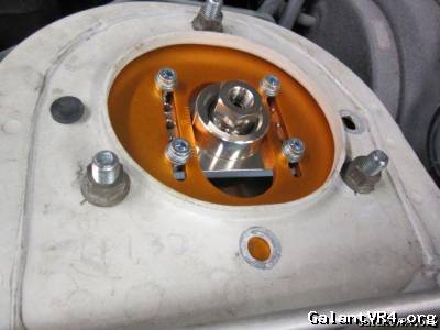

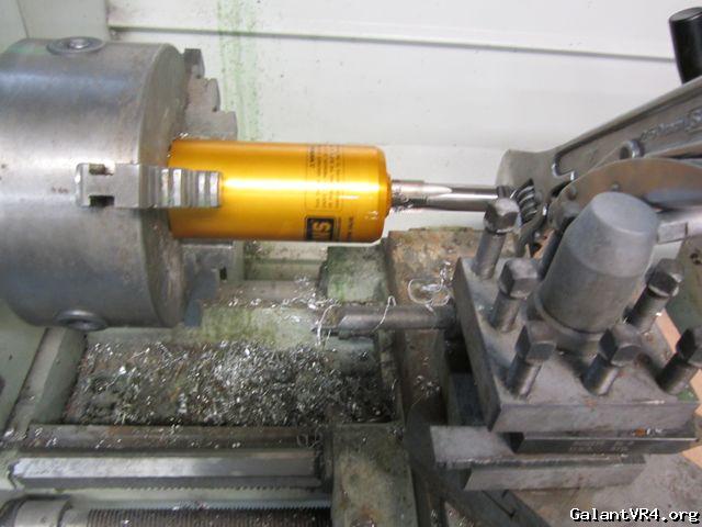

A little modifying. Took maybe an hour on my lathe and to drill the front strut tower. Maybe $80 in hardware! The only thing I don't like is that the adjustment for the fronts takes place from the bottom side were the rears are from the top. Haven't driven on them yet. Wanted to paint my wheels before the new tires went on. Hopefully finish that up this weekend!
