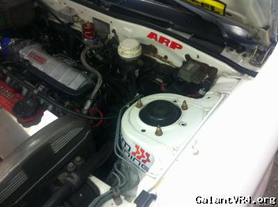

Quoting ade:
Quoting Alainb7:
Thanks for the picture.
Quoting ade:
I have those adapters on my gvr4, i got them from a forum member and they bolted right in
You use everithing in the kit?
Rear lower mount & front lower mount CNC-machined oval adapter washers?
Tell me if I'm wrong, but these front lower mount CNC-machined oval adapter washers are replacing the 2 1/16" shim, and fit in the 14mm strut mount hole and use 12mm bolt for knuckle hole mount,the oval shape is to adjust camber? I am right
i only received the rear adapter and it bolted right on.

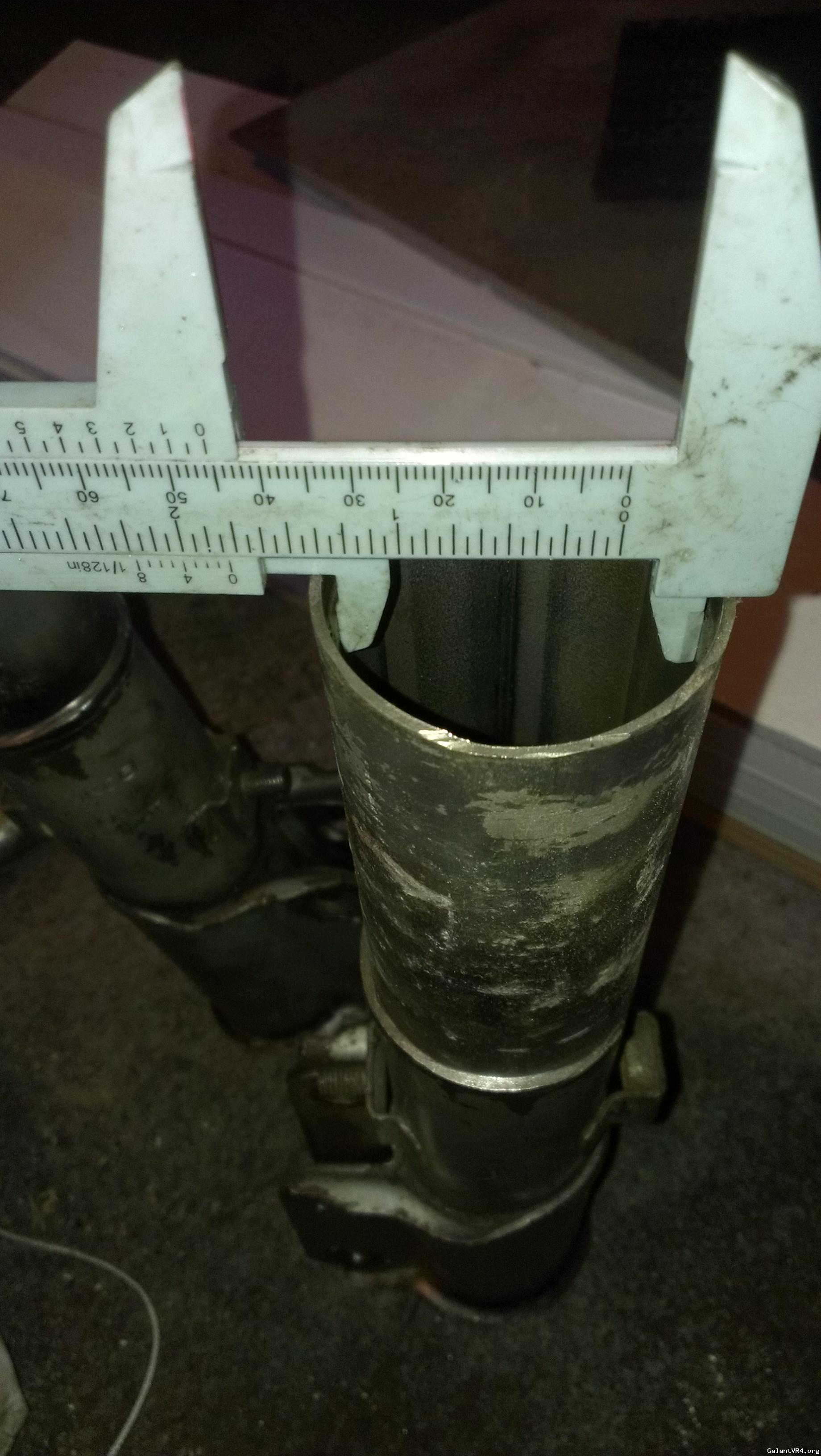

I liked his idea. SKU:BIL-34-050224 (24944) are listing for $110 here

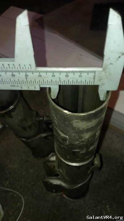

If only this was half a mm bigger. This would so worth it. I need to find some free 3000gt struts.
dsm kyb G2 cut up

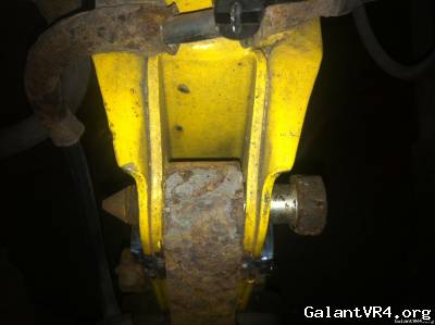

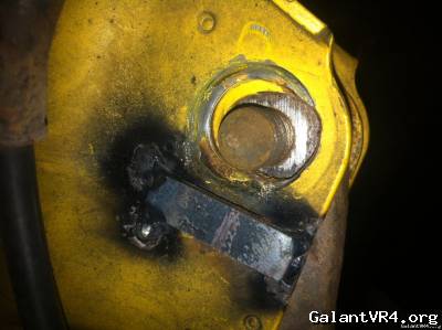

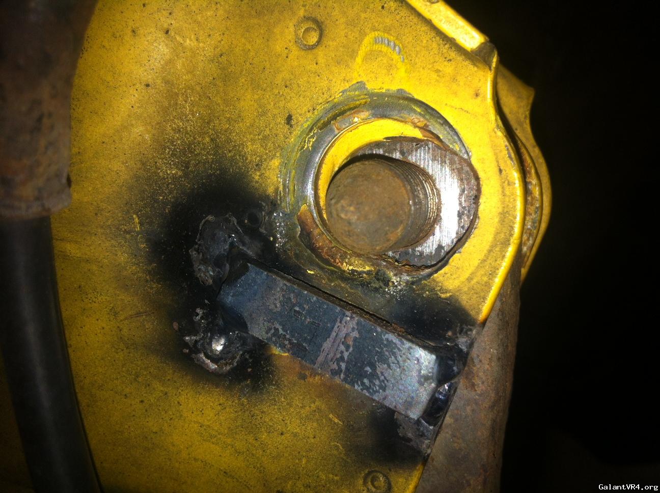

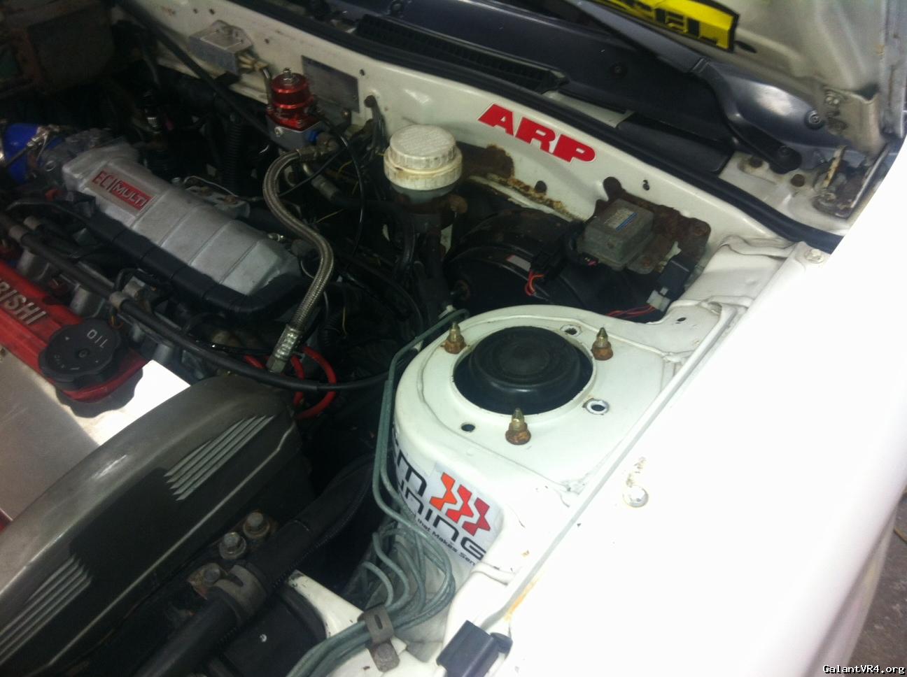

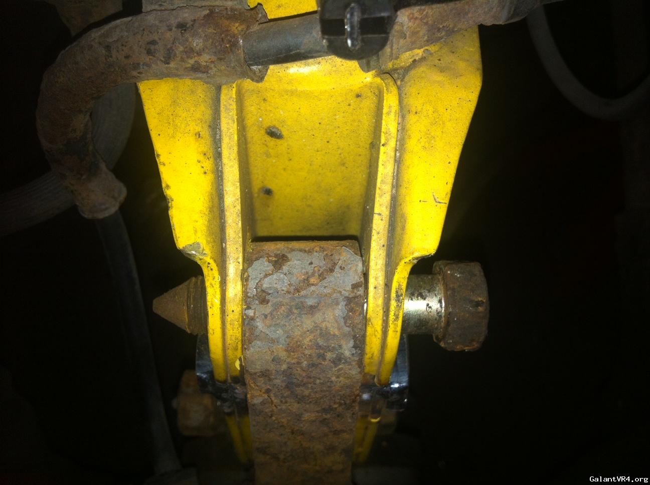

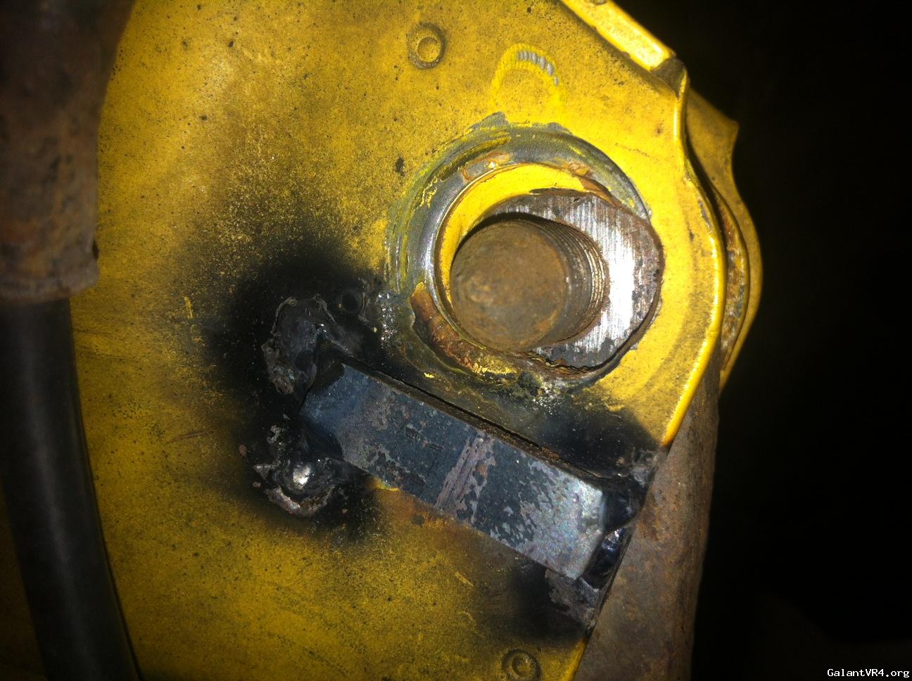

Install almost done.
In the past, the strut as been install on a Mirage, so the guy didn't put the shim plate and I will need to bend back the mounting plate.
He also oversize the hole and weld some steel bump:(

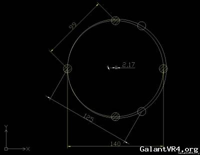

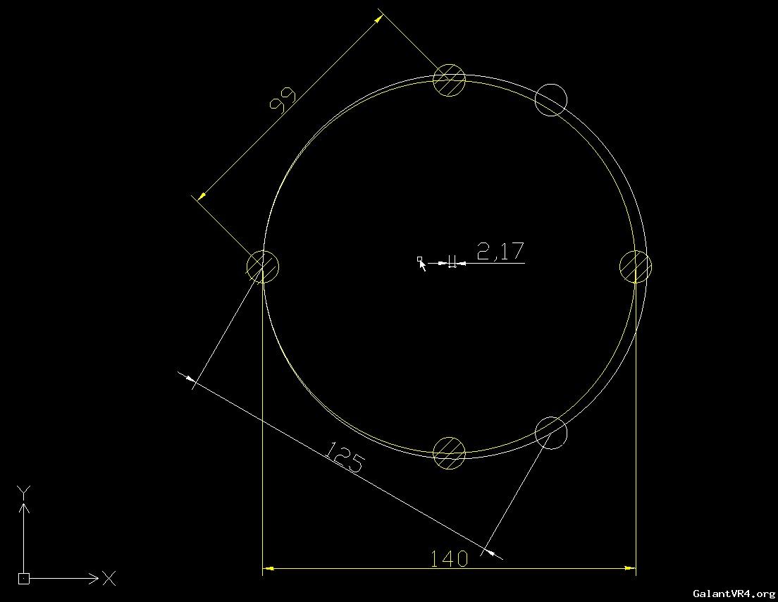

Here is the front tower mod. pretty easy to do. It just move the top plate 2mm out. But for next alignement, I will redrill to have top plate go in to minimise the tire to be flush to fender.
