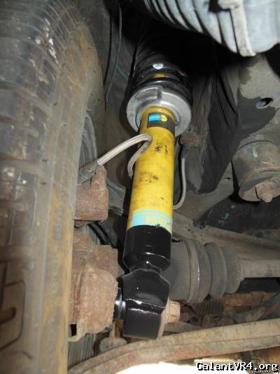

were talking about it being welded in like this,

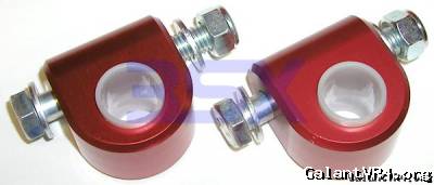

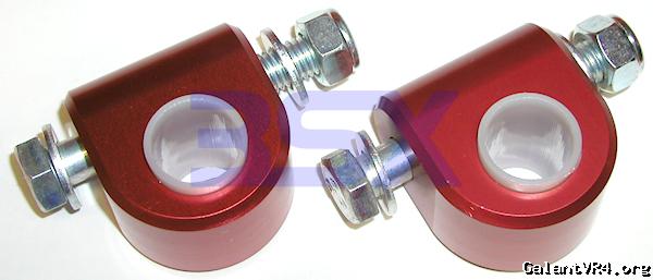

or using this adapter:
and prove it, it looks like the problem of spacing has already been addressed with poly bushings pre-inserted now.

then those are off of an evo 10 because 8 and 9 are different. 8 and 9's aren't closed at the bottom there open. we have to weld in a bushing.
