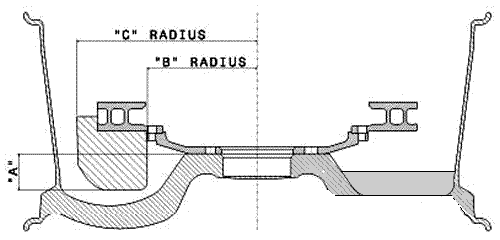

Mike from looking at your wheels I would say no on clearing the Brembo brakes. For Brembo setup you need a high pad wheel. The spoke design can help to clear the brakes, but it really boils down to the back pad of the wheel.

lol yeah i know right, but what if i got one of those adapter plates that bolts up to our factory knuckles? wouldnt there not be any clearance issues? because theoretically they should fit since they bolt up in the same location as the stock caliper. even though they are greater in size though.

The caliper is much wider than the stock caliper. Only certain wheels will fit and size and offest will only be part of the equation. You have to make sure that what ever wheels you get will have plenty of clearence between the spokes and calipers.
