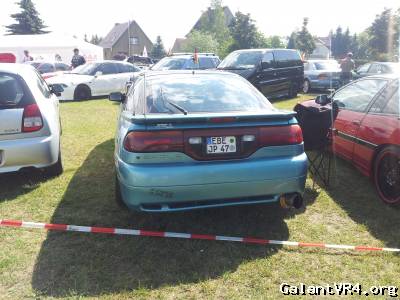

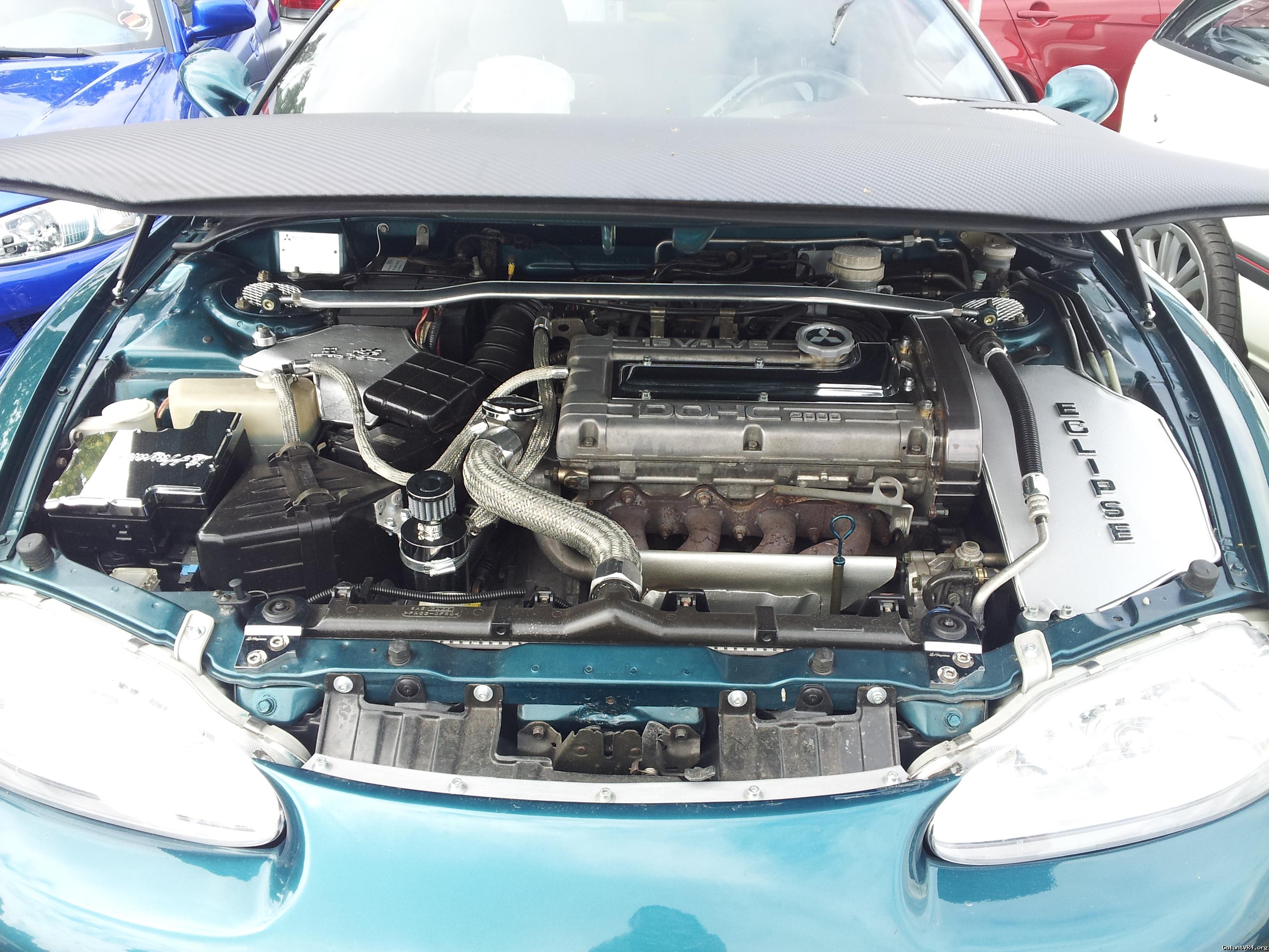

Will the Evo gearbox bolt up? No. Is it possible? Yes. But I guess we've beaten that horse.
@citymunky - Can't help but notice the 2GNT you posted is located somewhere in Asia. FYI: Only USDM 2GNTs got the 420A. Everyone else in the world got a naturally aspirated 4G63. If that 2GNT is a confirmed, USDM vehicle (typically left behind by a US servicemember), it's possible, but it's worth knowing. Most DSMs outside the US were non-turbo, too. And the AWD variants were even more rare. If you see a 1G AWD car anywhere in the world where the Evo was sold, there's a good chance you'll see a US Mitsubishi/Jeep/Eagle/Chrysler/Plymouth dealership decal on it.
EDIT: pictures from last month
EXHIBIT A: 2GNT, factory stock with 4G63
EXHIBIT B: former US servicemember DSM left behind in Germany

Quoting DR1665:
