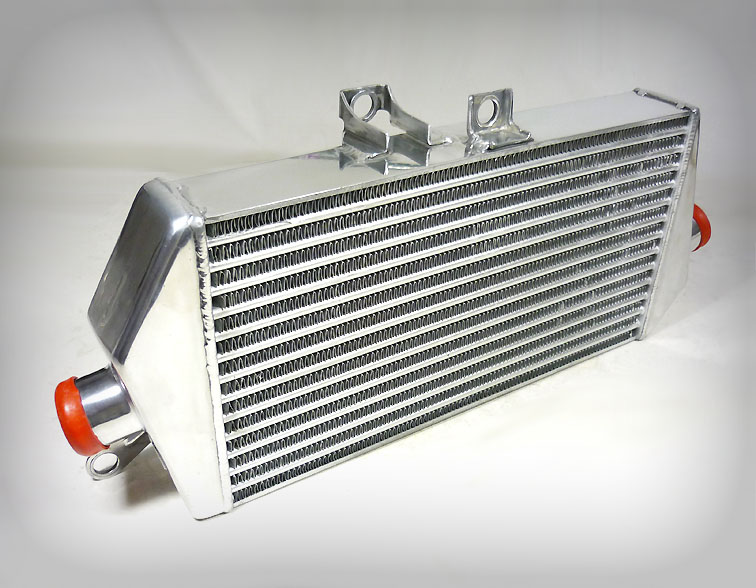

Okay so i have been running the JDM rs fmic setup on my vr4 for a while now, and i think im at the limits of flow and cooling ability. I found a Evo 3 core for cheap, but not sure if it would be a close fit. It has the 2" endtanks like i want and looks to be somewhat similar except for the hot side tank will be lower, but im willing to fab up some tubing to fit. My question is has anyone run one before? Heres a pic of what it looks like (btw its not that exact one just a reference.

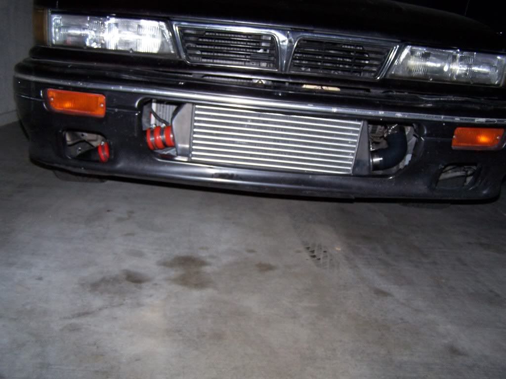

well i went ahead and got it and bolted it up, pretty much fits the stock bolt holes that i used for the RS fmic. It defiantly flows way better and felt alot cooler to the touch after the first cruise. Even the piping it came with was pretty close fit( at least the cold side piping). I paid $220 shipped for the fmic and piping kit. We will see if i log an better results.

Yeah the ebay link is the one i got. I did some logs before and after. The run before was at 17psi with the rs fmic which flowed 32lbs min and according to link it est 310whp. Then switched to the evo 3 and the 2.5 piping for the cold side and 2" for the hot with and nothing else was changed is set the mbc at 15psi. i logged 29lbs min and 315 whp. The injector duty went down 10% as well. So its making as much at 15psi as i did at 17psi before. The intercooler gets the air alot cooler also, just by the touch factor after 3 wot pulls its frosty on the cold side and hot on the hot side. If you want i can post the logs

Does it look like it would be possible to keep the foglight with a couple of bends on the intercooler outlet or is it too close?
